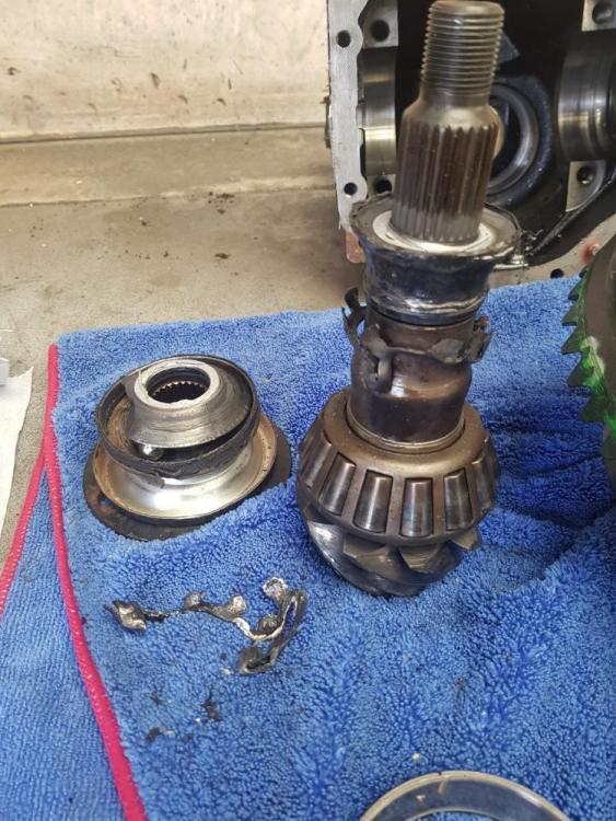

Varelco 211 Report post Posted April 12, 2019 11 hours ago, smudge said: . Unfortunately we've run into yet another issue where Nev didn't think to put any oil into the diff once he'd changed it to the Kaaz 1.5way that I supplied. So the on-road tuning came to an abrupt end with the diff locking up at 60mph. Luckily no damage or injuries to the people involved but it looks like the best part of a grand has gone up in smoke. Does everything that guy touch turn to sh*t or what? Glad that no man or machine got hurt, that could of very easily been a different story! 1 smudge reacted to this Share this post Link to post Share on other sites
smudge 1020 Report post Posted April 12, 2019 In hindsight it should have been checked, yes. But with everything else we have going on, it never crossed our minds. We might have a very clever solution which I'll reveal soon enough, incorporating a lower ratio diff to accompany the diesel BMW gearbox. Share this post Link to post Share on other sites

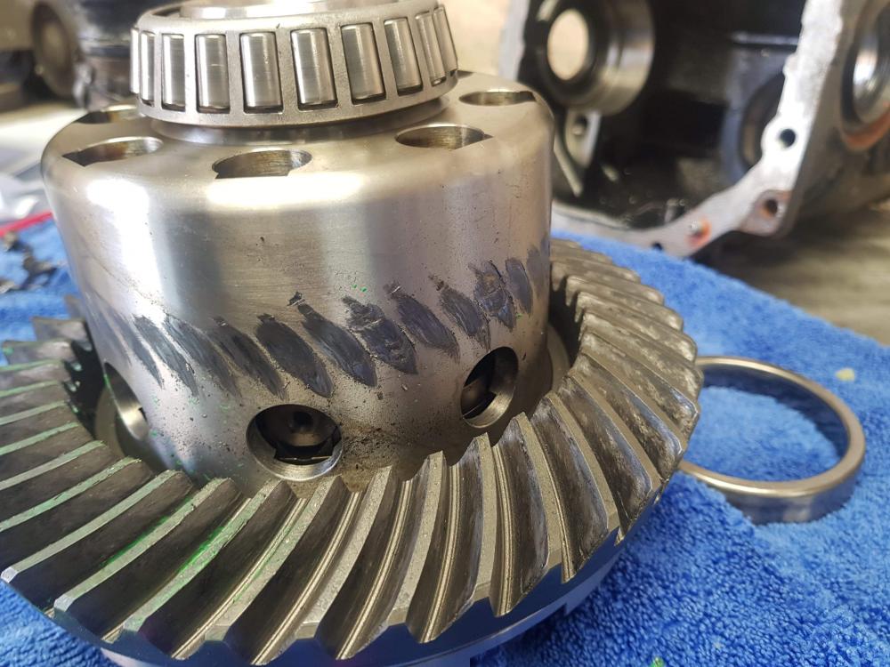

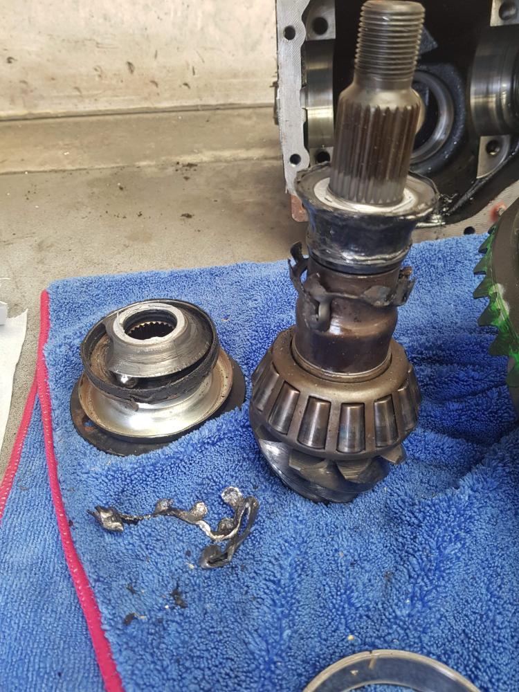

smudge 1020 Report post Posted April 17, 2019 The aftermath of not having oil in your brand new Kaaz diff. Crown ring and pinion are shot. Luckily the diff unit itself has only sustained cosmetic damage to the case. So it can still be used with a new C&P which is the best outcome we could have hoped for really. Somewhat relieved but still pissed off that the individual that changed the diff in the first place didn't have the common sense to add any oil into the mix 😠 (not Carson Performance by the way) BIG thank you Tom Hudson for his knowledge and help on this. He was only supposed to be mapping it for me 😂 Share this post Link to post Share on other sites

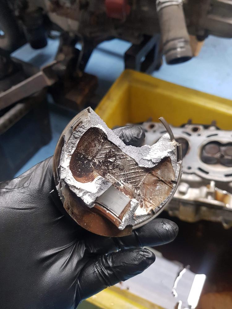

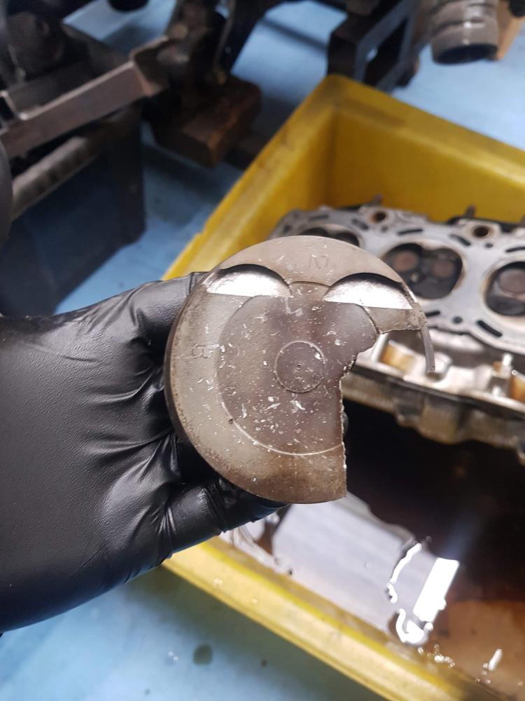

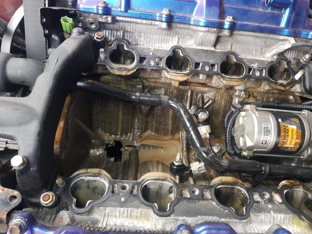

smudge 1020 Report post Posted May 4, 2019 Yet more nightmares for the V8 build. Tom at Fensport got the mapping absolutely spot on for me to cruise it to Japfest this weekend, only to have this happen under no load whatsoever. Gutted is an understatement, and I really feel for Tom who's done nothing but his best to get this on the road. Resulting in it trying to kill him twice! Options going forward? New engine with more expense and effort? Or just give in to the fact that it clearly isn't meant to be and split the parts that are on the car? 2 nerdstrike and Mark-in-Stoke reacted to this Share this post Link to post Share on other sites

Luke 193 Report post Posted May 7, 2019 Do you know what's actually caused the piston and Rod to come through the block. Is it the same as the fa20 where a torque spike can cause a hair line crack to appear and then its just a ticking bomb? Forged internals? Share this post Link to post Share on other sites
vanko25 70 Report post Posted May 7, 2019 @Luke The engine was sold to Jordan as an early engine which has the thick rods but it turned out is a later engine with thinner rods, hence the failure when got boosted. 1 smudge reacted to this Share this post Link to post Share on other sites
smudge 1020 Report post Posted May 7, 2019 7 hours ago, Luke said: Do you know what's actually caused the piston and Rod to come through the block. Is it the same as the fa20 where a torque spike can cause a hair line crack to appear and then its just a ticking bomb? Forged internals? As @vanko25 said, it turned out to be a thin rod engine rather than the thick rod version which is what it was sold to me as. They even swapped the fuel rails over to the earlier version which is how you tell the difference, so a full deception plan to lie to me. Another lesson learned I guess. Share this post Link to post Share on other sites

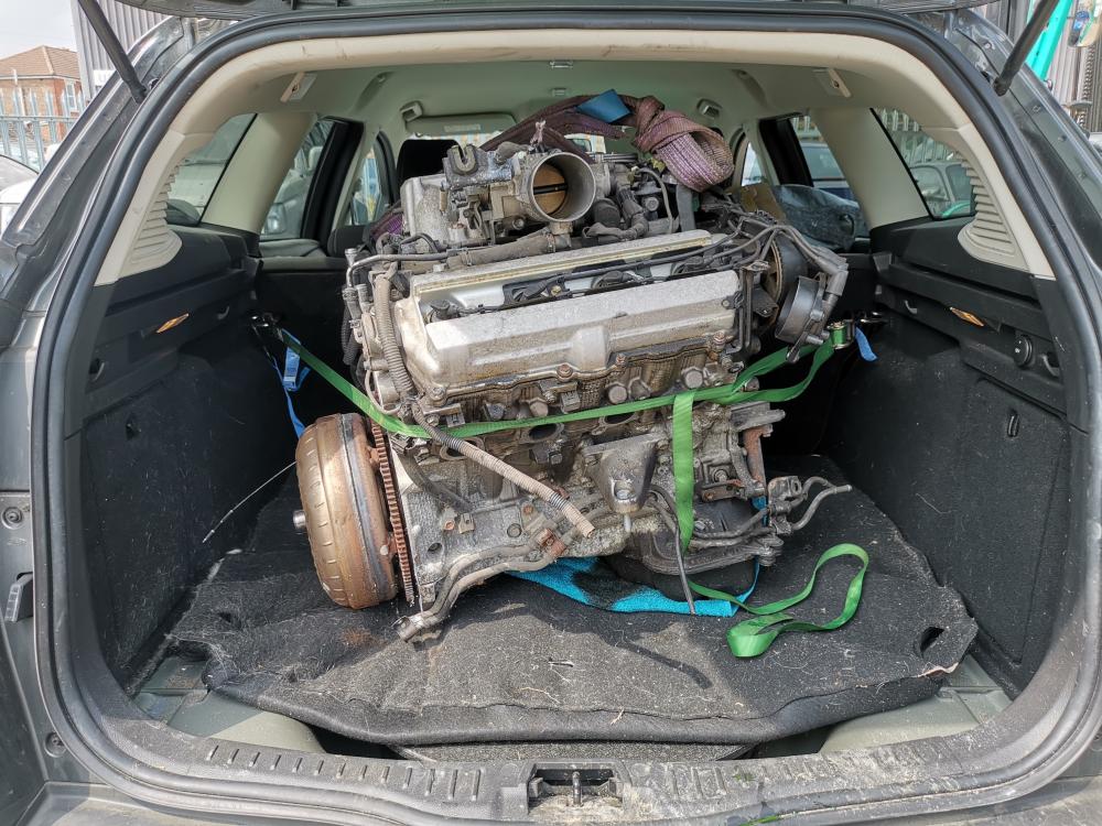

smudge 1020 Report post Posted May 18, 2019 After much deliberation, listening to the kind words from friends, fellow 86 owners and other general car enthusiasts, coupled with an extremely generous offer from Carson Performance - I finally picked up a 3rd 1UZ engine today from a reliable source in an attempt to finally get this thing on the road once and for all. I'd like to thank everyone again that's helped me over the past few weeks. Your enthusiasm and motivation to want an end result to this nightmare for me has spurred me on and I don't think I would've made this positive step without your input. Tom at Fensport has been an absolute trooper despite the car wanting to kill him twice now, I can't thank him enough for his endless patience and advice over the past couple of months. I'll be collecting the car from there in the next week or so and arranging a weekend with Simon at Carson Performance to do the switch. 3 Badger, Ulphy86 and GT86-Ian reacted to this Share this post Link to post Share on other sites
