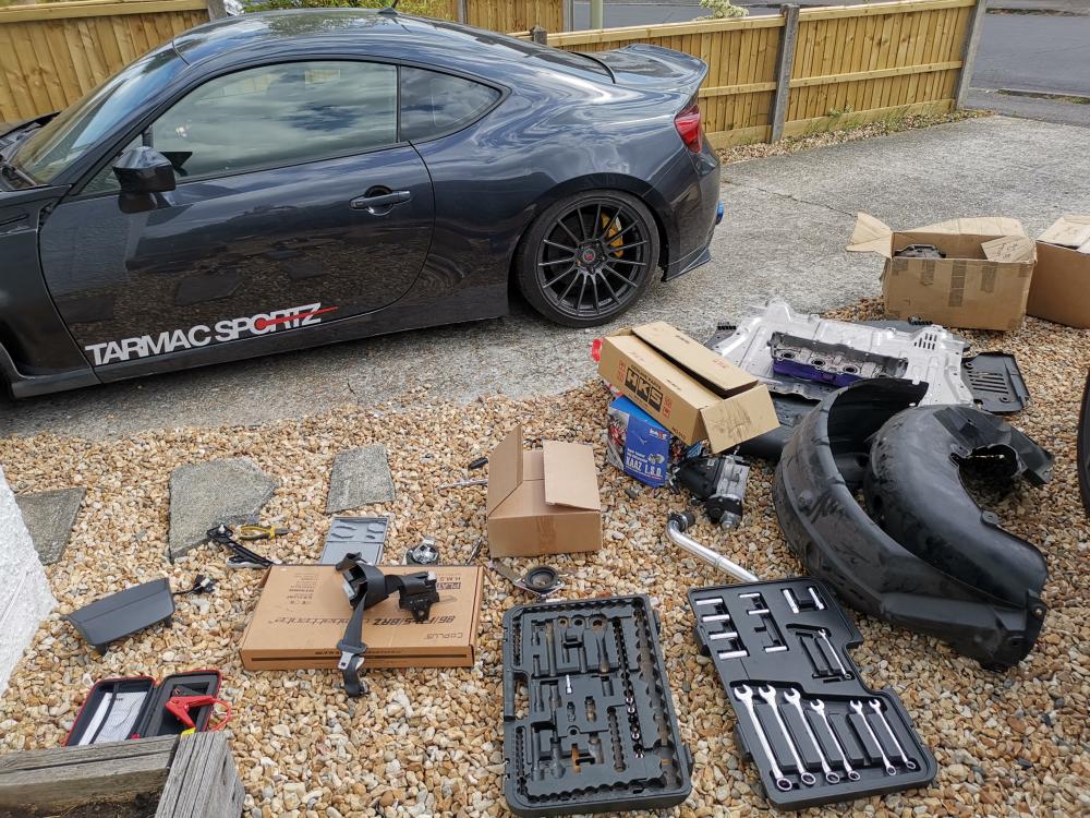

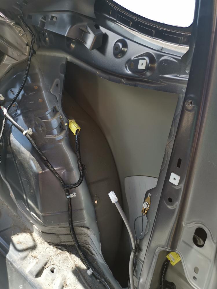

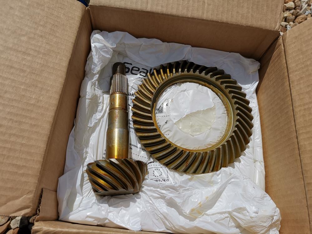

smudge 1020 Report post Posted May 28, 2019 First chance I've had to play about with the car in a LONG time! Cleared all the bits out (mainly broken parts) and removed some unnecessary parts like the rear speakers, rear seatbelts and 3rd brake light. Refitted my rear arch liners that have been sitting in the garage for a couple of years. Also unpackaged my new final drive of 3.58 ready for the diff rebuild. Couple of weeks before she goes back to Carson Performance for the engine transplant, need to gather a few more bits before then. Share this post Link to post Share on other sites

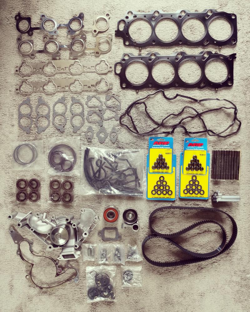

smudge 1020 Report post Posted July 10, 2019 Lack of progress recently whilst I build up the collection of parts needs to give this 3rd engine an overhaul. I've decided to spend a bit of money on new seals, gaskets, pulleys, belts, pumps, bearings and bolts to make sure that this engine has the best chance possible. Currently researching who's best to rebuild the bottom end using ACL race bearings and ARP rod bolts, but sticking with the OEM rods and pistons as its not worthing spending £2k to upgrade those for my setup. The heads will be getting new valve springs, along with a port and skim to allow for thicker head gaskets and better air flow. This process will take a few months yet, but at least the collection of parts looks pretty! Also had my Bullet intercooler turn up which sandwiches between the supercharger and the inlet manifold, to help those pesky high inlet temps! Lovely engineered bit of kit. In the meantime, I've been stripping down the engine to the bare block and heads. Over 30kg worth of wiring and acilliaries removed! 1 Badger reacted to this Share this post Link to post Share on other sites

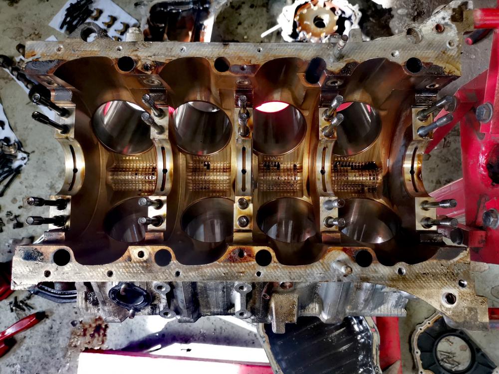

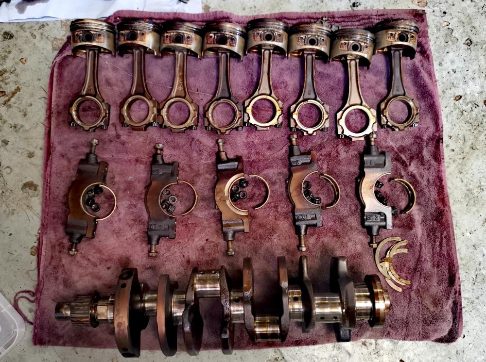

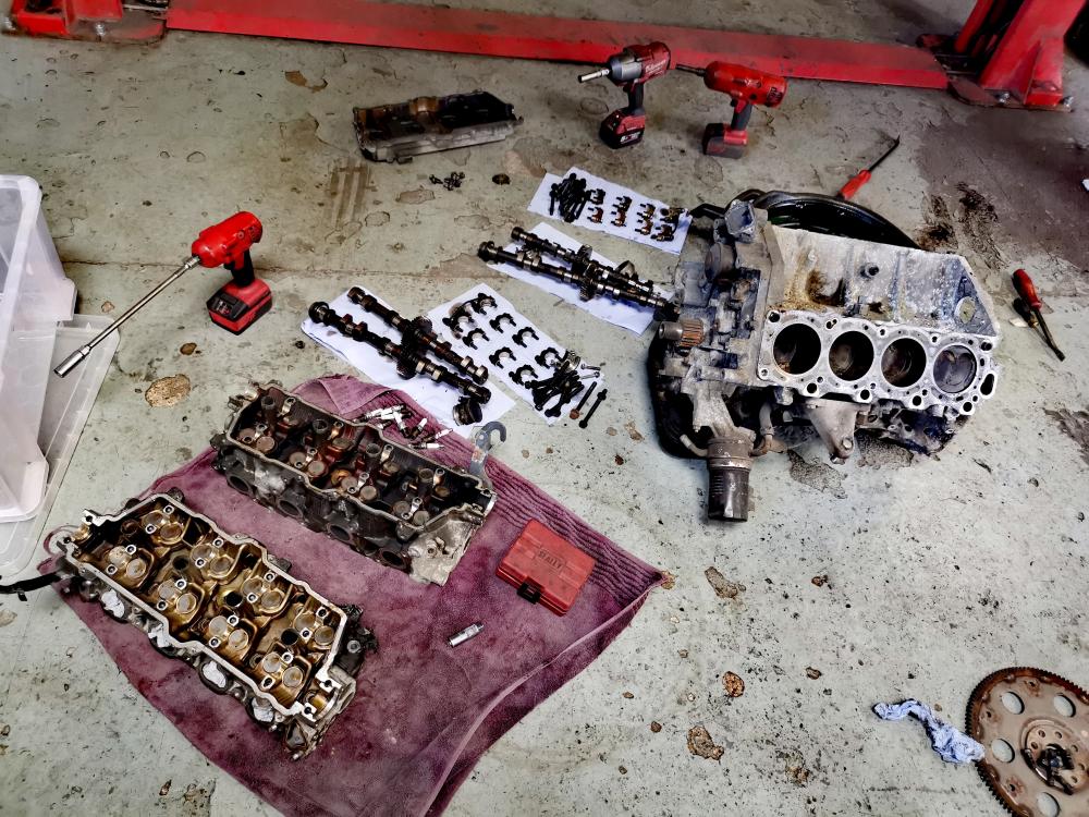

smudge 1020 Report post Posted August 23, 2019 Last few days have been spent stripping down the engine completely, ready for inspection, measuring and ensuring everything is good before doing anything major. Was good fun getting my hands dirty for the 1st time in a while, and good to see the ins and outs of the engine too. Rogue Motorsport measured all the bores, crank and pistons today. Happy to report that everything is as good as it can be, meaning I'll go ahead and get everything professionally cleaned and painted up before we start the build itself. Just waiting on the new oil pump to arrive and need to order some new OEM rings now we know the gap measurements are good. 3 ThatGuyThere, GravelRash and Lauren reacted to this Share this post Link to post Share on other sites

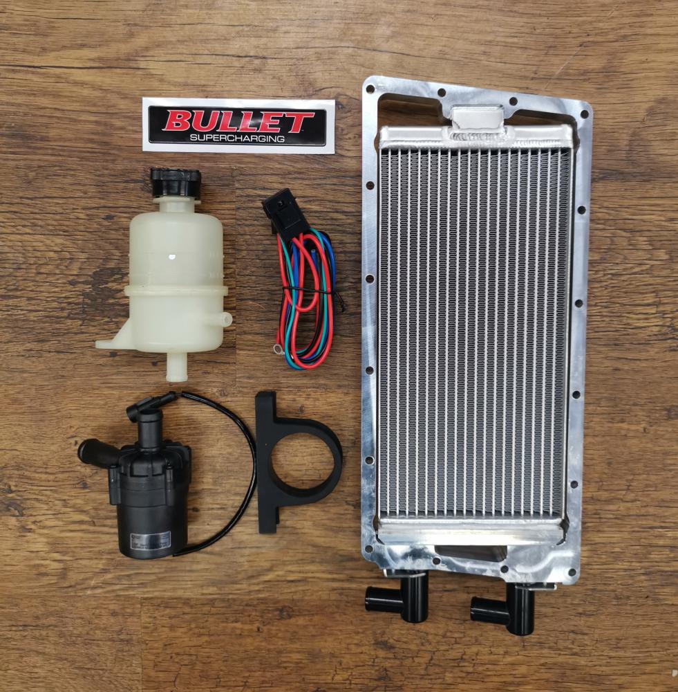

smudge 1020 Report post Posted November 28, 2019 Couple of deliveries containing vital parts to the build have arrived this week. First off from the USA, we have a 7 gallon (American gallons, so around 23.5litres) water tank with an inbuilt pump, capable of pushing 2000litres of fluid every hour! This will be a vital part of my cooling setup for the supercharger to keep inlet temps as low as possible. Semi circle shaped to fit nicely into the spare wheel well of the 86. Next up from Australia is a funky bit of kit called an interchiller. This is the same principal as a water to air intercooler, with the added benefit of tapping into the A/C system to chill the coolant to FREEZING temperatures. This ensures that the inlet temps should even reach ambient, giving us more consistent power on the track. This will sit on the sidelines for a few weeks until I get time to install them. Got to work out all the different size fittings and hoses I need next, as they're all different of course 🙄 Share this post Link to post Share on other sites
