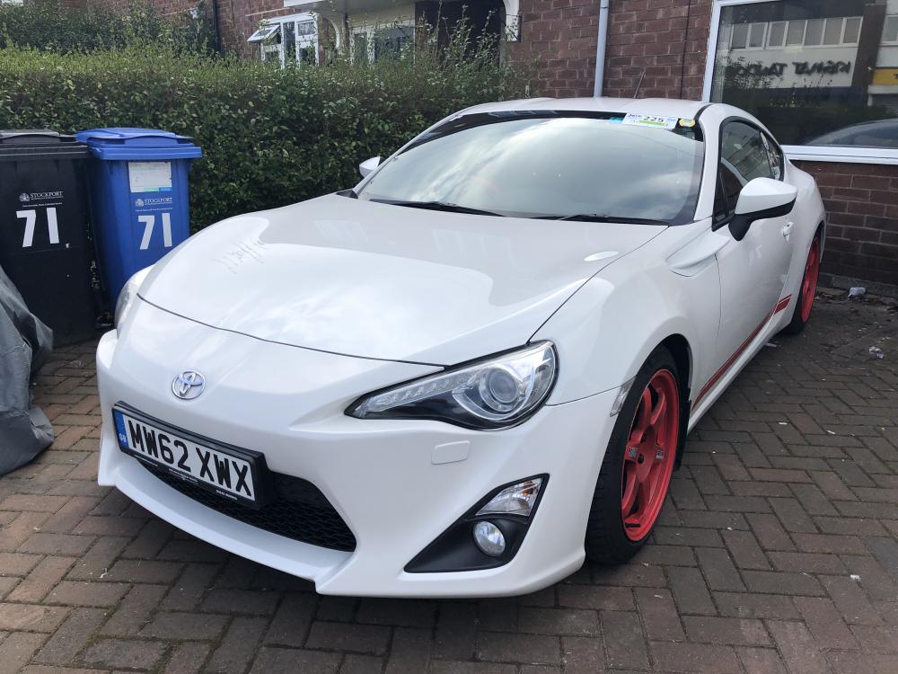

Lauren 2259 Report post Posted March 25, 2019 My car went in this morning. Got news later today that my engine is out and stripdown starts tomorrow. 2 sam534 and vanko25 reacted to this Share this post Link to post Share on other sites

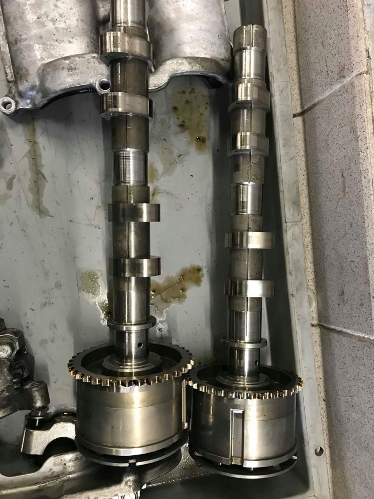

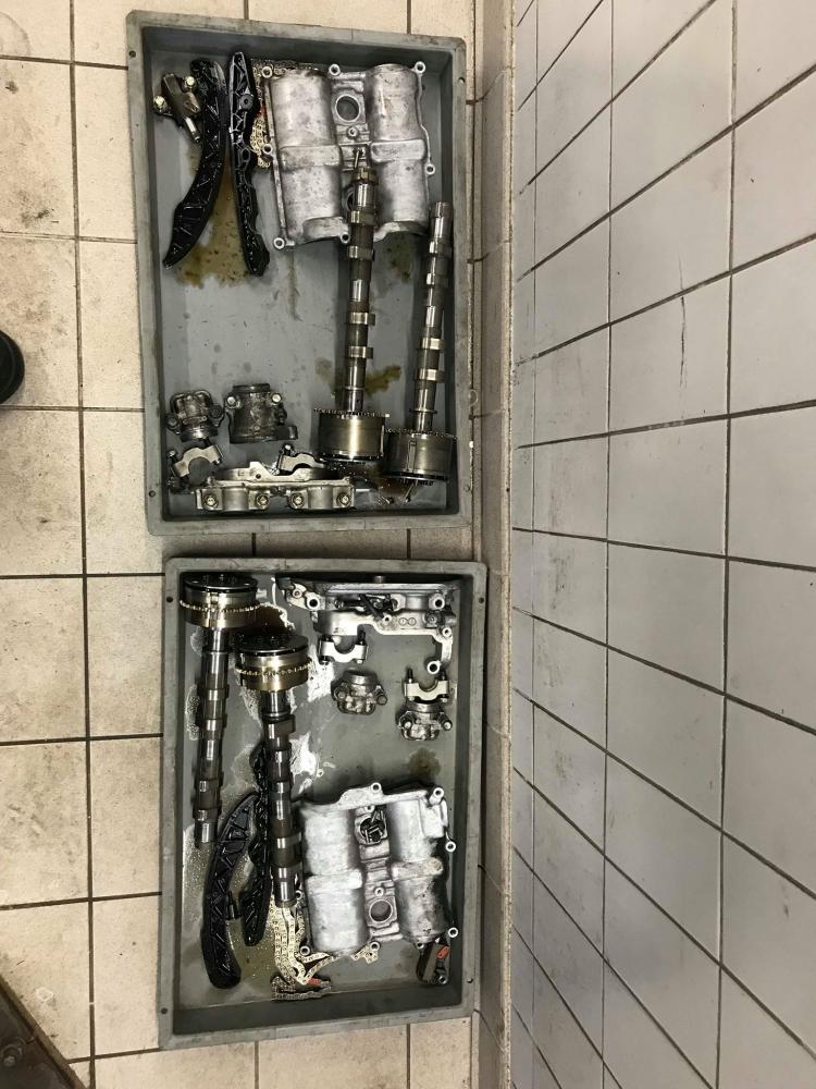

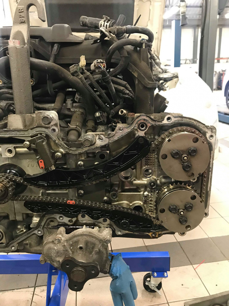

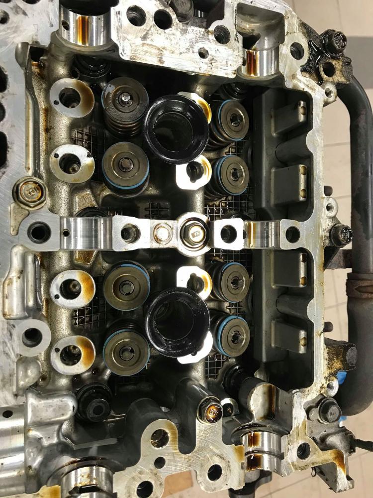

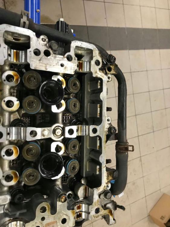

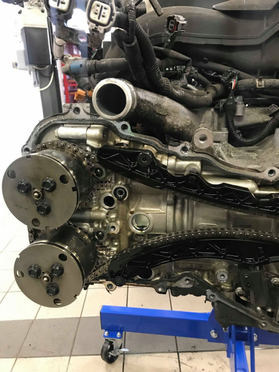

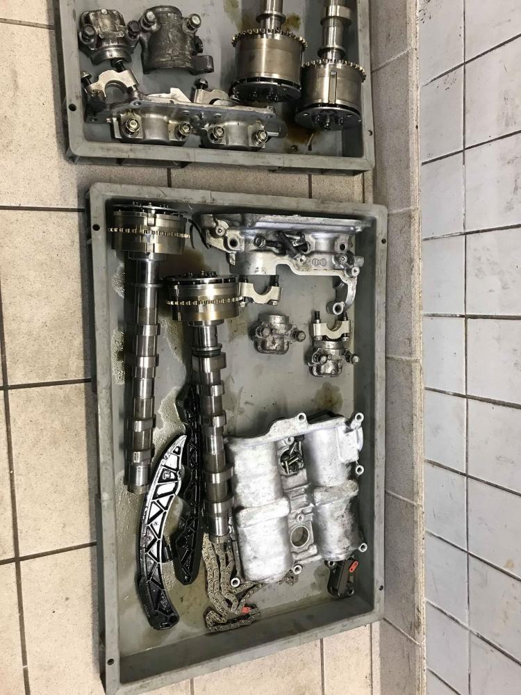

Lauren 2259 Report post Posted March 26, 2019 Gary has been giving me updates. Reckons the timing chains look like new. He was impressed with the condition of what he saw of my engine saying it was a lot better than many others he had seen, which surprised me given my high mileage. Also my clutch still had a good amount of life in it, even after 126,000 miles. Impressive. Richard called today about the upcoming sprint season which is another story and said that Gary had done the work and my engine goes back in tomorrow. 2 Church and TommyC reacted to this Share this post Link to post Share on other sites

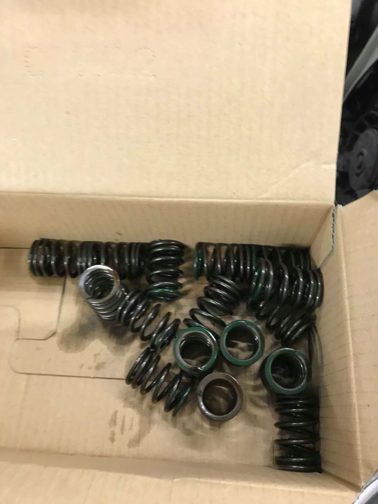

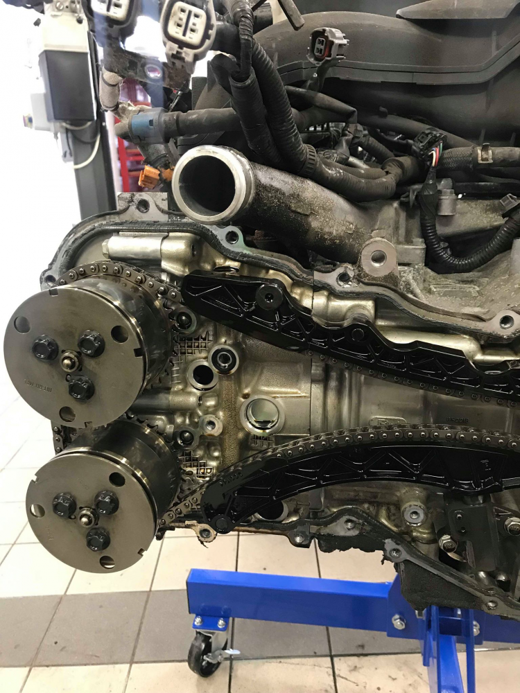

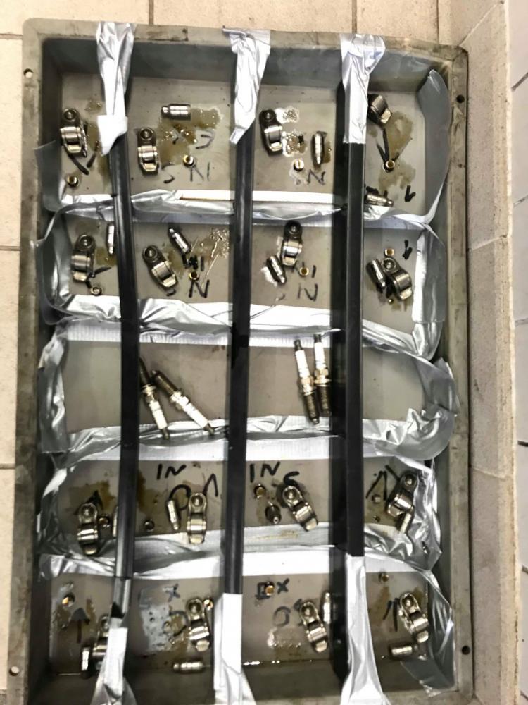

Lauren 2259 Report post Posted March 27, 2019 More pics of the cams, valves etc. Thanks, Gary. 3 Church, sam534 and surrey86 reacted to this Share this post Link to post Share on other sites
sam534 62 Report post Posted March 27, 2019 More pics of the cams, valves etc. Thanks, Gary. Interesting to see, thanks Lauren! Sent from my STF-L09 using Tapatalk Share this post Link to post Share on other sites

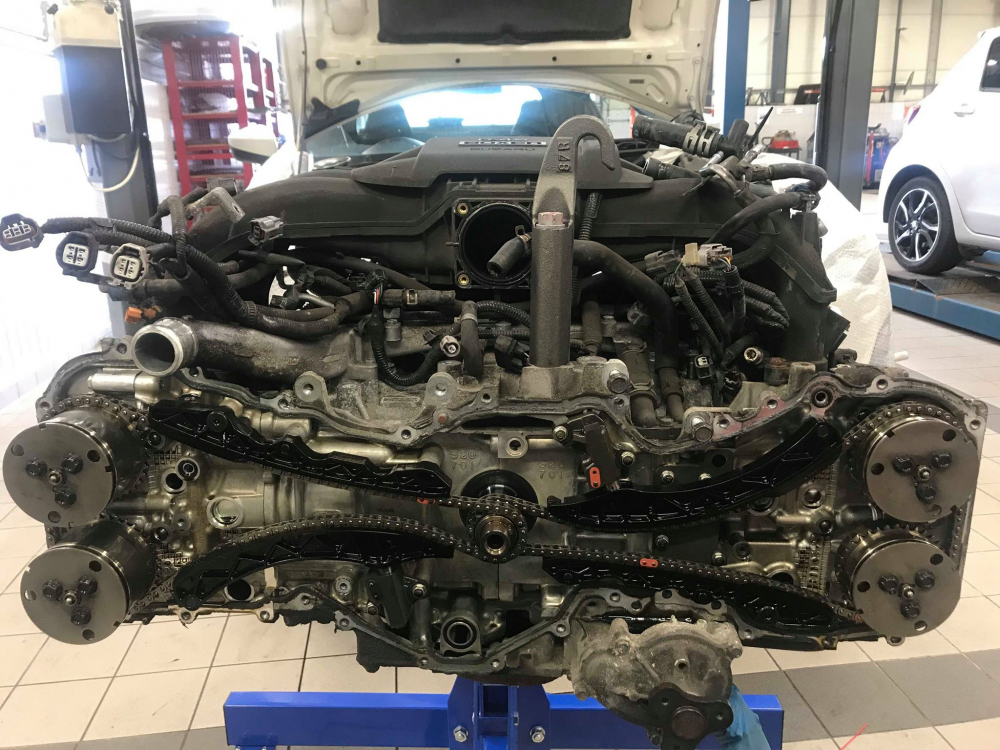

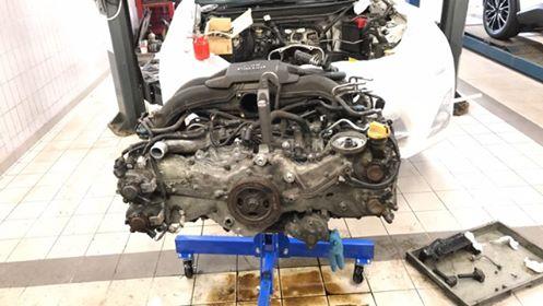

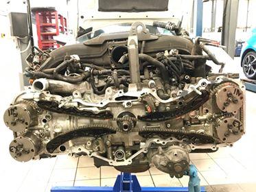

Lauren 2259 Report post Posted March 27, 2019 All going well, more pics from Gary this afternoon. Engine is now back together completely and I expect tomorrow will be putting it back in. I appreciate it that RRG have taken their time with my car to get it right. @Rob230 I have a friend who's car is going into Jemca Reading tomorrow night. She said that they have told her it will be ready for Saturday. I have my doubts! But good luck. Share this post Link to post Share on other sites

Lauren 2259 Report post Posted March 28, 2019 Quick update. Engine is back in and running and all sorted. I have another issue that RRG are looking at first thing in the morning with a noisy steering issue that may be related to my poly bushes on the rack. This is why it's taken a bit longer, but RRG want to check the fluid levels in the morning. I will check when I pick up (likely Saturday morning) whether the oil and coolant is changed or not. Share this post Link to post Share on other sites

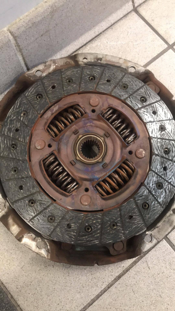

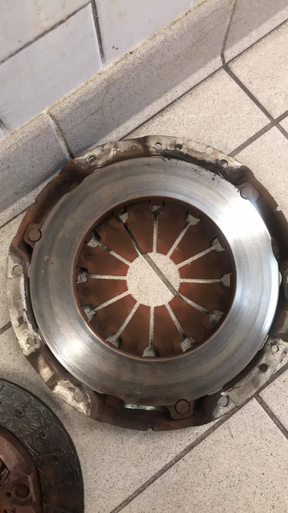

Lauren 2259 Report post Posted March 30, 2019 Got my car back today. It feels super sharp and quick compared to the Blue Edition I've been driving all week. It's worth noting that you effectively get a free intermediate service as the oil and filter are changed as is the coolant (which saves me having it done at 140K). The aircon is recharged too. I had a new clutch fitted and looking at the old one, it was getting a bit low so perfect timing. Clutch feels lovely and light, nice. A huge thanks to Gary and Richard at RRG Macclesfield for doing a great job and a great service as they always do. This time next weekend I will be sprinting at Cadwell. Can't wait. Just need to new poly ARB mounts fitted next week once they come in to sort the creaky steering issue. One of the ARB mounts got cooked by the overpipe over 110k miles, so may put some wrap round it soon. 1 TommyC reacted to this Share this post Link to post Share on other sites
