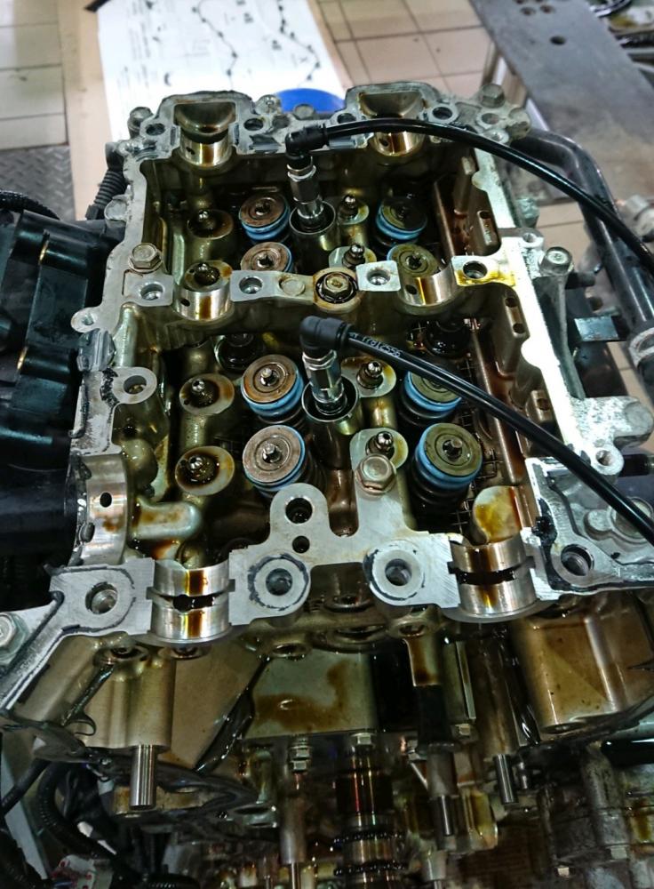

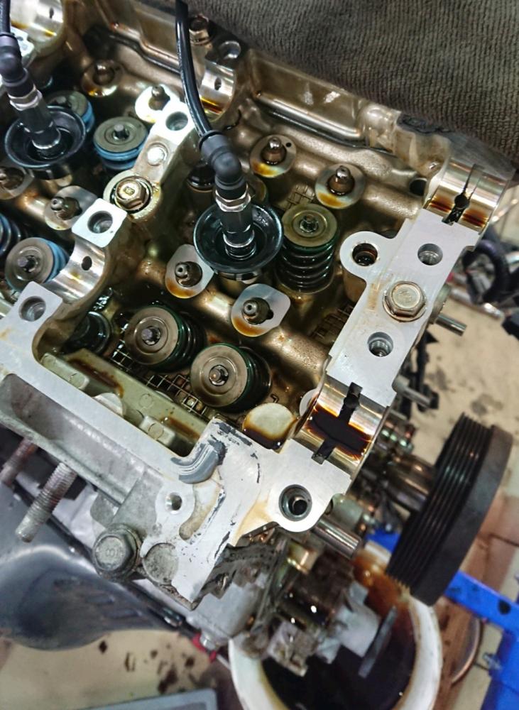

Lowe 191 Report post Posted May 30, 2019 1 hour ago, Rich196 said: Whats with the spark plugs been hooked up? Compressed air lines I'd imagine to open up the valves. Share this post Link to post Share on other sites
Lauren 2259 Report post Posted May 30, 2019 1 hour ago, Lowe said: Compressed air lines I'd imagine to open up the valves. Well, to close the valves and hold them in place whilst the springs are changed. Share this post Link to post Share on other sites
