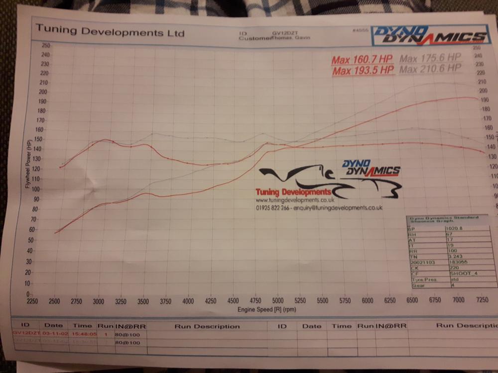

Tom 5 Report post Posted October 7, 2018 1 hour ago, BRZ-123 said: Great news Tom. Thanks for sharing. If I read your post correct, you had the hardware fitted by yourselves before going to TD and your ECU has relearnt what it could and adjusted aka your before run is with all hardware installed and your after is just with the tune to perfect the hardware. If yes, yours is a very unique example of these graphs and should be stored for future ref. Sent from my SM-G935F using Tapatalk Yes that's right ( I fitted all first myself then remap was done ) 1 BRZ-123 reacted to this Share this post Link to post Share on other sites
willclarke 50 Report post Posted October 7, 2018 Kinda looks like the ecu adjusted pretty well by itself to the new hardware even before the map! Sent from my Pixel 2 using Tapatalk 1 BRZ-123 reacted to this Share this post Link to post Share on other sites
MartinT 514 Report post Posted October 7, 2018 Look at the torque curves. You need the remap to get the best out of the replacement manifold.Sent from my LG-Q6 using Tapatalk 1 Lauren reacted to this Share this post Link to post Share on other sites
BRZ-123 174 Report post Posted October 7, 2018 Kinda looks like the ecu adjusted pretty well by itself to the new hardware even before the map! Sent from my Pixel 2 using TapatalkIt has indeed. From a typical 20 lbft dip it has gone to 10lbft dip. The dip has got a bit wider though. Starts at 3k instead of 3250. Hence the max gains both torque and power is not as high as old tune has adjusted well to the hardware. This should be a reference graph for people wanting to decide if they need a tune or not. Sent from my SM-G935F using Tapatalk Share this post Link to post Share on other sites
BRZ-123 174 Report post Posted October 7, 2018 Look at the torque curves. You need the remap to get the best out of the replacement manifold.Sent from my LG-Q6 using TapatalkTo fully gain yes, but the power and torque gains are low compared to someone who went stock upwards. So if budget and/or availability of a reputable tuner is hard, you can benefit from the manifold only. Sent from my SM-G935F using Tapatalk 1 willclarke reacted to this Share this post Link to post Share on other sites
willclarke 50 Report post Posted October 7, 2018 Yeah think it's just pretty impressive to see without the tune. Fully support remap needed to reap the full gains, and already saving up for the TD Na kit! To fully gain yes, but the power and torque gains are low compared to someone who went stock upwards. So if budget and/or availability of a reputable tuner is hard, you can benefit from the manifold only. Sent from my SM-G935F using TapatalkSent from my Pixel 2 using Tapatalk Share this post Link to post Share on other sites
Kodename47 446 Report post Posted October 8, 2018 21 hours ago, willclarke said: Kinda looks like the ecu adjusted pretty well by itself to the new hardware even before the map! There is no re-adjusting, that's just how the manifold runs with the OEM cam timing. The ECU doesn't "learn" much at all. Share this post Link to post Share on other sites
BRZ-123 174 Report post Posted October 9, 2018 12 hours ago, knightryder said: There is no re-adjusting, that's just how the manifold runs with the OEM cam timing. The ECU doesn't "learn" much at all. May the better way to put it is, the hardware made the change to reduce the torque dip, the software didn't as it was not tuned. If ECU does not learn much, how does it work with detecting fuel changes (i.e. high octane vs low octane) and adjust timing to prevent knock? And with a battery reset, its always mentioned ECU needs time to relearn the map, is that a myth then? Share this post Link to post Share on other sites
Luke 193 Report post Posted October 9, 2018 54 minutes ago, BRZ-123 said: May the better way to put it is, the hardware made the change to reduce the torque dip, the software didn't as it was not tuned. If ECU does not learn much, how does it work with detecting fuel changes (i.e. high octane vs low octane) and adjust timing to prevent knock? And with a battery reset, its always mentioned ECU needs time to relearn the map, is that a myth then? I'm also very curious about this myth of Battery disconnect for ecu relearning as I've never seen actual convincing results. Share this post Link to post Share on other sites
nerdstrike 186 Report post Posted October 9, 2018 (edited) It's not a myth, but usually the adaptation is toward safety and economy rather than "gains". A remap takes away some safety margin, or puts some back in if you're adding boost. Things that can change: Derestricted intake (e.g. less effective air filter), leans out AFR, ECU applies a little extra fuel to compensate Dodgy intake misleads air meter, car makes more peak power by leaning out the AFR. May self-correct over time. Freer breathing engine makes more usable power - irrespective of fuelling, an engine under less load can generate more torque. Exhaust pressure is load, intake restriction is load. It may make a little extra on top due to unexpected leanness. Things that cannot change without intervention: The base map. That safety margin for crap fuel, bad weather, high altitude and such is still there. Trims have upper and lower limits - you can't just add a turbo and expect the ECU to compensate. You might just about be able to handle a low pressure supercharger, but you would be living right on the edge. It doesn't know you need a different AFR, but it can at least add more fuel to match the observed airflow. Valve timing and lift settings, ignition timing In "closed loop" at low load the ECU uses the O2 sensor in the exhaust to compute a short-term fuel trim which it combines with long term and base map to decide fuelling. That informs the next fuel injection cycle and the long term fuel trim is tweaked. In "open loop" at high load, the ECU ignores the O2 sensor and blindly applies the long term trim to the base map. The learning is in the range of +/- 20%. Disconnecting the battery and flushing the trims is usually less helpful than normal driving. Edited October 9, 2018 by nerdstrike Terminology switcheroo, thanks knightryder 3 MartinT, BRZ-123 and willclarke reacted to this Share this post Link to post Share on other sites
Kodename47 446 Report post Posted October 9, 2018 9 hours ago, nerdstrike said: In "open loop" at low load the ECU uses the O2 sensor in the exhaust to compute a short-term fuel trim which it combines with long term and base map to decide fuelling. That informs the next fuel injection cycle and the long term fuel trim is tweaked. In "closed loop" at high load, the ECU ignores the O2 sensor and blindly applies the long term trim to the base map. The learning is in the range of +/- 20%. Open loop is no feedback, closed loop is where the O2 feedback is used to adjust fueling. You got those crossed but otherwise spot on. It's worth noting that there is not a long term trim but various ones stored and applied over the RPM range and fueling split. 13 hours ago, BRZ-123 said: If ECU does not learn much, how does it work with detecting fuel changes (i.e. high octane vs low octane) and adjust timing to prevent knock? And with a battery reset, its always mentioned ECU needs time to relearn the map, is that a myth then? Fuel trims as above. The Subaru method for global knock control is basic using a method called advance multiplier. 2 ignition timing tables, 1 is the base table and the other the advance. The advance multiplier is just literally a multiplier for the advance table. As standard it is set to 0.7 and if the ECU picks up no signals it determines as knock the IAM will increase towards 1 in increments. If there are any signals that it determines as severe enough knock then it will stop increasing or even decrease the IAM. This is constantly changing unless at 1 with no knock, so running 95 RON fuel for a while won't make the ECU run worse once you switch to better fuel but it will take (not much) time to adjust. This is only part of the knock control strategy but the one relevant to general fuel quality. All the info you'll want is here: http://www.romraider.com/forum/topic1840.html Battery/ECU reset just clears fuel trims and the advance multiplier and learnt ranges for accelerator pedal/throttle position sensor and possibly a few other sensors. I re-calibrate the sensors straight after an ECU flash. 1 BRZ-123 reacted to this Share this post Link to post Share on other sites
BRZ-123 174 Report post Posted October 9, 2018 Fuel trims as above. The Subaru method for global knock control is basic using a method called advance multiplier. 2 ignition timing tables, 1 is the base table and the other the advance. The advance multiplier is just literally a multiplier for the advance table. As standard it is set to 0.7 and if the ECU picks up no signals it determines as knock the IAM will increase towards 1 in increments. If there are any signals that it determines as severe enough knock then it will stop increasing or even decrease the IAM. This is constantly changing unless at 1 with no knock, so running 95 RON fuel for a while won't make the ECU run worse once you switch to better fuel but it will take (not much) time to adjust. This is only part of the knock control strategy but the one relevant to general fuel quality. All the info you'll want is here: http://www.romraider.com/forum/topic1840.html Battery/ECU reset just clears fuel trims and the advance multiplier and learnt ranges for accelerator pedal/throttle position sensor and possibly a few other sensors. I re-calibrate the sensors straight after an ECU flash.Thanks for the explanation DJ Learn something new everyday!Sent from my SM-G935F using Tapatalk Share this post Link to post Share on other sites
nerdstrike 186 Report post Posted October 9, 2018 1 hour ago, knightryder said: Open loop is no feedback, closed loop is where the O2 feedback is used to adjust fueling Right you are, should have checked. Thanks for the insight into knock control! Share this post Link to post Share on other sites
