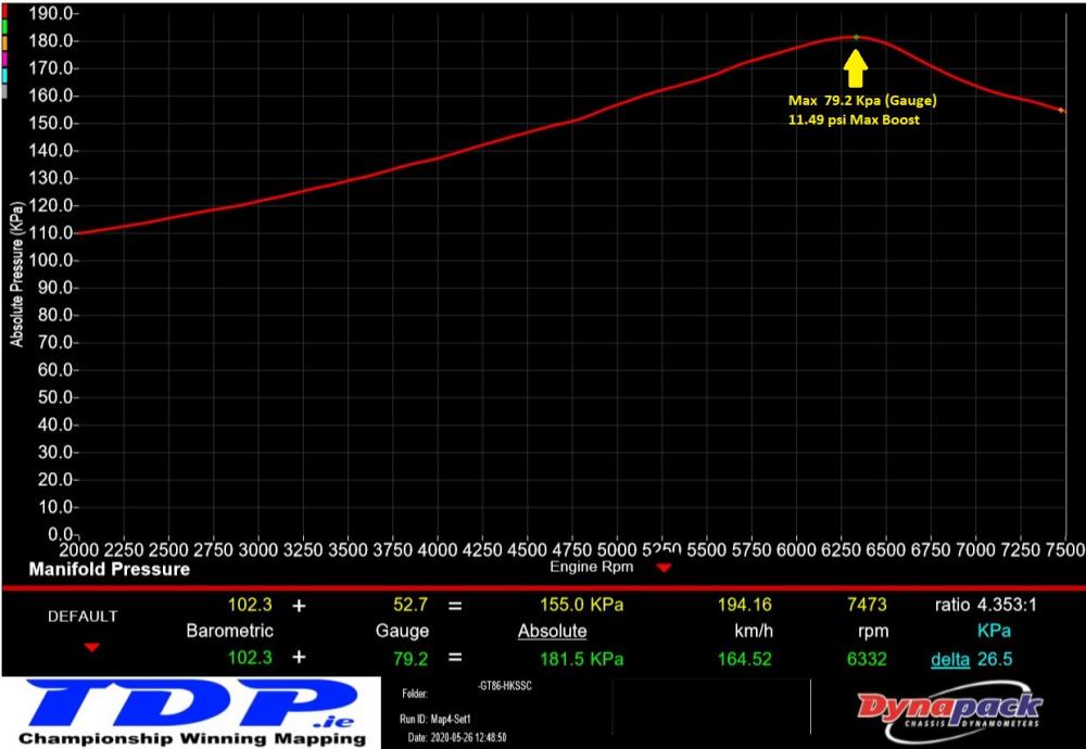

BOBEL 73 Report post Posted May 27, 2020 So the car made it onto the dyno yesterday for tuning 😀 Pretty pleased with the results, made just over 11psi, and the torque curve holds nicely from just beyond 4,500 rpm up to 6250 rpm which is mapped really nicely for a centrifugal charger IMHO. Peak power comes in around 6250 - 6750 rpm so means I won't have to chase the redline to get the best out of it on track and hopefully will keep me in the range of good oil pressures too. 2 MartinT and Deacon reacted to this Share this post Link to post Share on other sites
