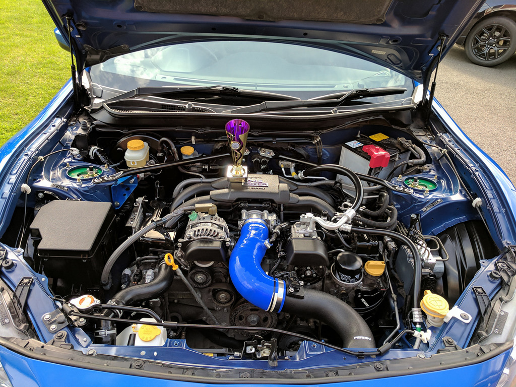

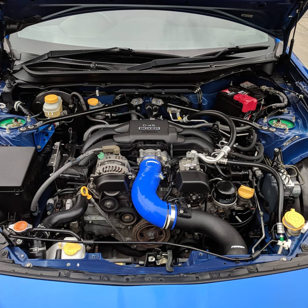

will300 812 Report post Posted August 26, 2017 Minor Update: As I've got a spare couple of hours I've finally got round to fixing the photobucket images on the initial post and the BBK post. I'm also going to do a quick update to let everyone know what's going on, nothing major at the moment. On the 21st of May (god it doesn't seem that long ago) I attended the Show n Shine meet hosted by @Neal, I ended up winning the best present car trophy after spending the previous day completely cleaning the car inside and out, I also gave the car a couple of last minute touch ups at the show, I got a total score of 14.5 out of 15 (I think), due to engine bay letting me down. Thanks again to Neal for organising the event. Here's a picture of the trophy and a clean engine bay, which I tided up the following day. The following couple of months I attended various shows and meets including both Japfests. I've also done 3 track days since the Oulton Park day back in February. One at Blyton Park with the club hosted by Lotus on Track, what a brilliant day that was. The car was faultless and the brake's were amazing, I definitely surprised a couple of the lotus guys with just how fast the car was. And in the past month I've done two track days (well 1 and a half) both at Bedford Autodrome, the first one was alot better than the 2nd, which I'll get on to shortly. Here's a couple of photo's from the recent Partbox meet: This is quite possibly my favourite photo this year of the car. On the 19th of August I took the car to Tuning Developments for @Mike@TD.co.uk (& Nick) to service the car (4th year) and check a couple off issue's I had. For those that are interested here is the list of issue's: 1. Exhaust manifold knocking/rubbing the undertray - Unfortunately this is the only niggle with the ACE CS400 manifold. Nick soon fixed this by hammering the undertray out. I'm looking at getting some uprated engine mounts as I'm not entirely convinced the issue has fully gone. 2. Exhaust system blowing - It turns out one of the joins on my AVO exhaust was leaking, so Nick took the exhaust off and resealed it. 3. Brake pedal feeling a little spongy - Brake system was fully bleed, issue now gone. 4. Tweaks to the throttle map - When I had the car remapped by Tuning Developments originally they mapped the car with two different throttle maps. One standard map and one more aggressive map. However I always felt the standard map was not responsive enough for my liking and the aggressive map was too sharp for daily driving (aggressive is perfect on track), so I ended up just using the aggressive throttle map. I informed Mike of this and he tweaked the standard map more to my liking, its now perfect for day to day driving. All of the above issue were sorted promptly. Once everything had been completed Mike told me that Nick had found an issue with the car which they couldn't fix (didn't have the part in stock). One of my rear ARB drop links had broken, it's that moment you then think **** how long has that been like that, I mean I was on track at Bedford two weeks before. Anyway I wasn't happy but nothing could be done about it. I then swiftly emailed Fensport who I purchased the droplinks from and they got a new set sent out next day, Thanks Fensport. Let this be a warning to anyone running aftermarket droplinks, check them regularly. It was now time for round 2 at Bedford (Thanks @Deacon, I'm now broke again ). The day started off well, I meet most of the guys there, did the noise test which I passed and thought that was that. However it turns out that Nick's fix on my exhaust made the drive by noise level alot louder. Unfortunately this meant I got black flagged in the first session, damn Bedford and it's low drive by limit. I was however given a 2nd chance, so on my 2nd session I decided to short shift, no complaints this time. 3rd session, I had @Deacon in the car as he was interested in the stopping power of my AP Racing BBK. I pushed alittle bit to hard and got black flagged again, this was me done for the day. For reference Bedfords drive by limit is 87.5db apparently I was hitting 92db. I'm going to look at getting something sorted over the next couple of months to hopefully lower the drive by noise level. I'll also be looking at getting my oil cooler fitted and a oil temp / oil pressure gauge fitted. As I now had a free afternoon I decided to help out a fellow club member I'd been speaking with (@alucado). He's interested in my BBK as he's looking to purchasing the same setup. Anyway he was in talks with @Lucas@PartBox about a set of Rays wheel's he was selling, but he didn't want to commit to buying them without knowing if they'd clear a BBK setup. He spoke to myself and Lucas and we arranged to try the wheels out on my car. The wheel fitment is: 17x7 +42. So I gave Lucas a call and told him I was now free for the afternoon, a couple of hours later I was at Partbox. I meet with Lucas and we had a chat about various things, mostly about me spending money. Anyway here is a couple of shots of the Rays wheels on my car, which as you can see clear the BBK without issue: That's it for now, thanks for looking. 6 Lauren, Neal, Mike@TD.co.uk and 3 others reacted to this Share this post Link to post Share on other sites

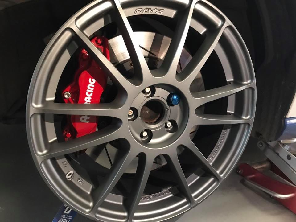

alucardo 55 Report post Posted August 26, 2017 Can't thank you enough @will300 Wheels are on the car, so im now looking at getting the bbk ASAP Share this post Link to post Share on other sites
will300 812 Report post Posted August 26, 2017 Just now, alucardo said: Can't thank you enough @will300 Wheels are on the car, so im now looking at getting the bbk ASAP Pictures.... Share this post Link to post Share on other sites

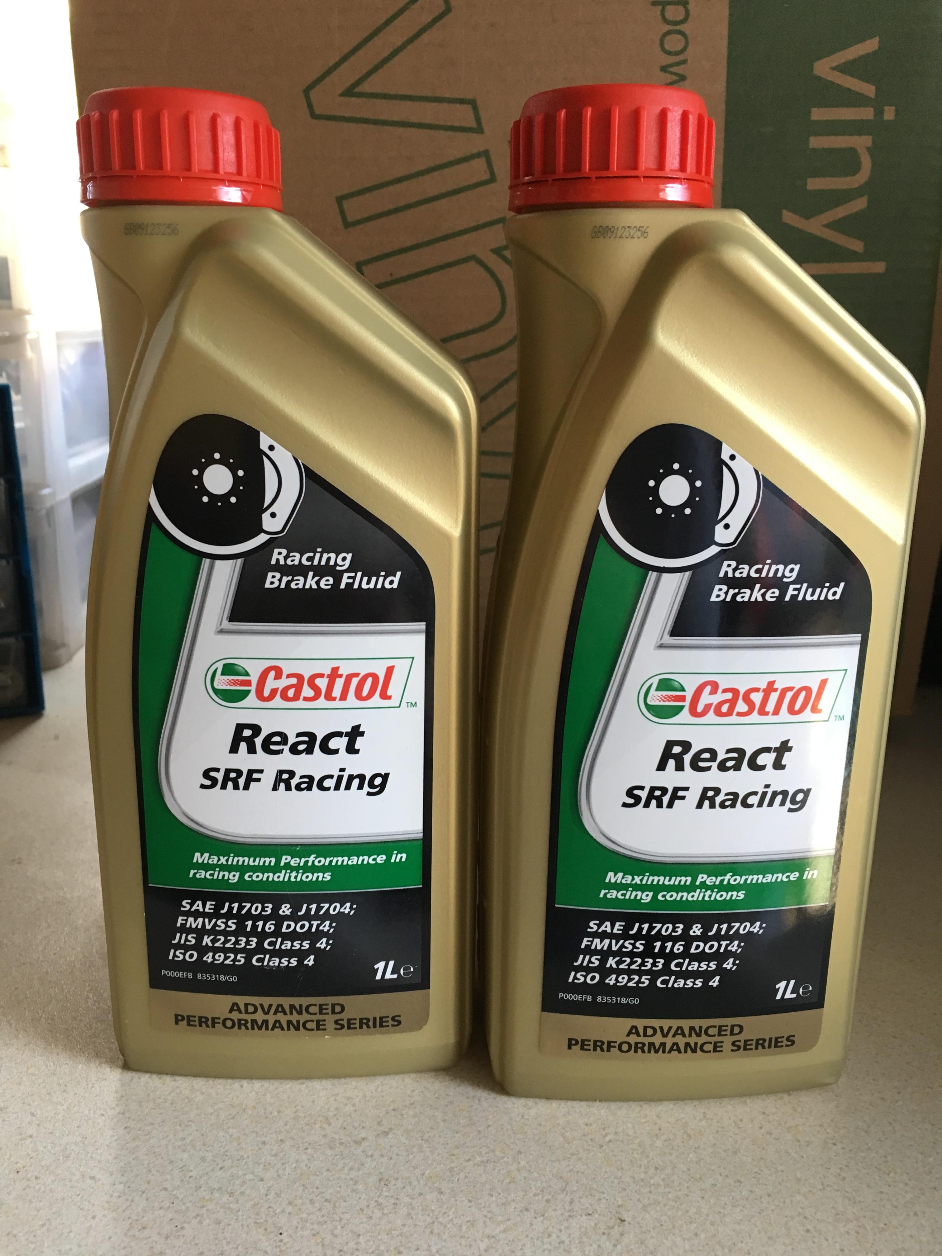

MikeB 79 Report post Posted August 29, 2017 I am just having my fluid changed with mot and service next month. I use Castrol SRF as it has the highest wet boiling point of 270 degrees C, dry is 310 degrees C. Recommend change fluid every 18/24 months. Its expensive but worth it and have not had any brake fade with braided hoses and Ferodo 2500 pads all round. Share this post Link to post Share on other sites
Rich196 103 Report post Posted August 29, 2017 34 minutes ago, MikeB said: I am just having my fluid changed with mot and service next month. I use Castrol SRF as it has the highest wet boiling point of 270 degrees C, dry is 310 degrees C. Recommend change fluid every 18/24 months. Its expensive but worth it and have not had any brake fade with braided hoses and Ferodo 2500 pads all round. This is the best but silly money. RBF600 in mine and no issues at all. Share this post Link to post Share on other sites
Ade 517 Report post Posted August 29, 2017 44 minutes ago, MikeB said: I am just having my fluid changed with mot and service next month. I use Castrol SRF as it has the highest wet boiling point of 270 degrees C, dry is 310 degrees C. Recommend change fluid every 18/24 months. Its expensive but worth it and have not had any brake fade with braided hoses and Ferodo 2500 pads all round. I'm surprised if it recommends every 18-24 months! Share this post Link to post Share on other sites
Ade 517 Report post Posted August 29, 2017 I had RBF600. Changed it after 9 months. Problem with higher temp fuild is they tend to absorb moisture at a faster rate. I now run dot 5.1 and I ran dot 5.1 with race pads on stock brakes too and no issues so I dint see the need to spend the extra money of high temp fluid. The reason I asked Will was because I found the RBF600 gave me a softer feeling pedal within a year. Share this post Link to post Share on other sites

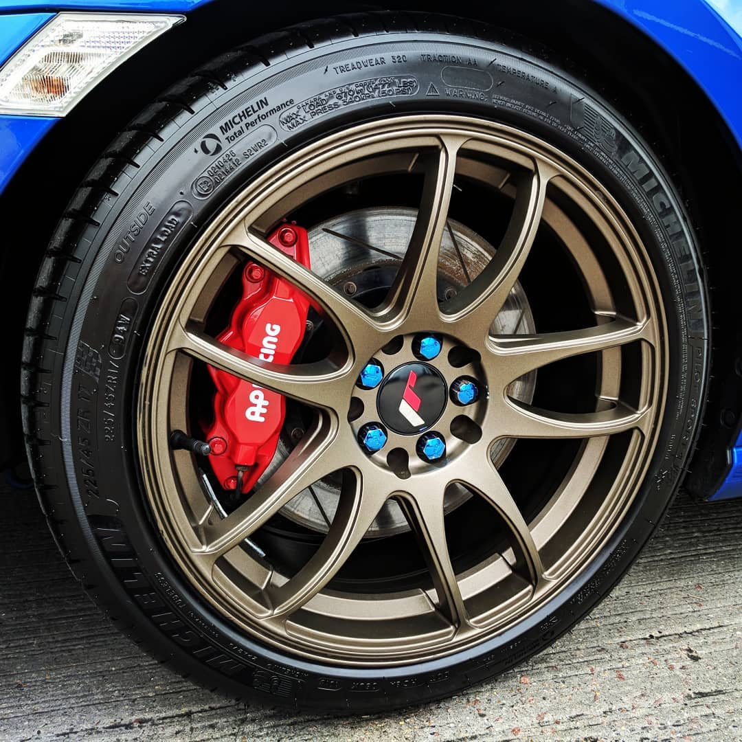

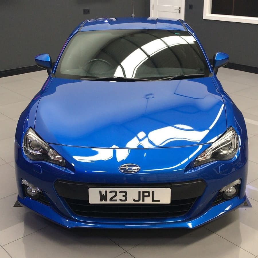

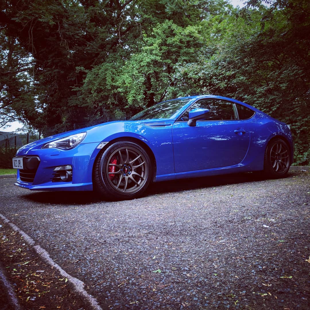

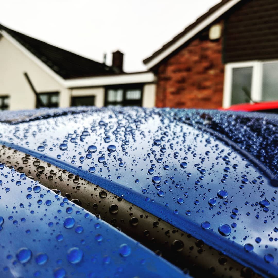

will300 812 Report post Posted June 16, 2018 Been a while since my last update, nothing has changed performance wise. However today I picked my car up from being detailed by Reep Midlands in Leicester. Car now has PPF applied to the front bumper, along with a couple of pieces on the rear bumper. G-Techniq Crystal Serum Ultra Black applied everywhere else. I also had the engine bay cleaned and front brake calipers sealed. I ordered some new wheels a month or some ago, they are Japan Racing JR29's in Bronze, size: 17x8 +35. Fitted with Michelin PS4's. Also fitted a new Yuasa 60Ah battery as the standard 48Ah one died on me. Here are a couple of photo's. 4 shiftspark, Lowe, DanJ and 1 other reacted to this Share this post Link to post Share on other sites

Ade 517 Report post Posted June 18, 2018 Looks really good, need to sort mine out. Swirl central at the moment. Share this post Link to post Share on other sites
shiftspark 41 Report post Posted June 18, 2018 @will300 Just realised your stripes have gone lol Share this post Link to post Share on other sites
gavin_t 184 Report post Posted June 19, 2018 Saw this posted on facebook earlier in the week. Looks even better in full size pics Seriously tempted by some 17x8 +35 wheels for mine as a downsize from my 18's. How much is yours lowered by approximately? Share this post Link to post Share on other sites

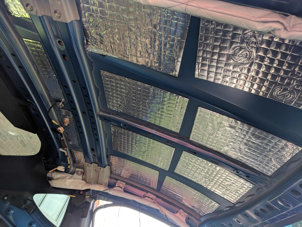

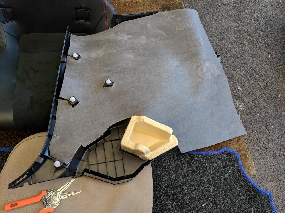

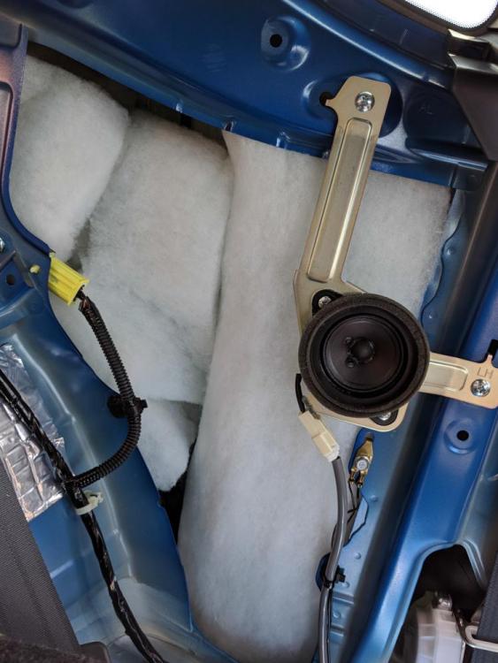

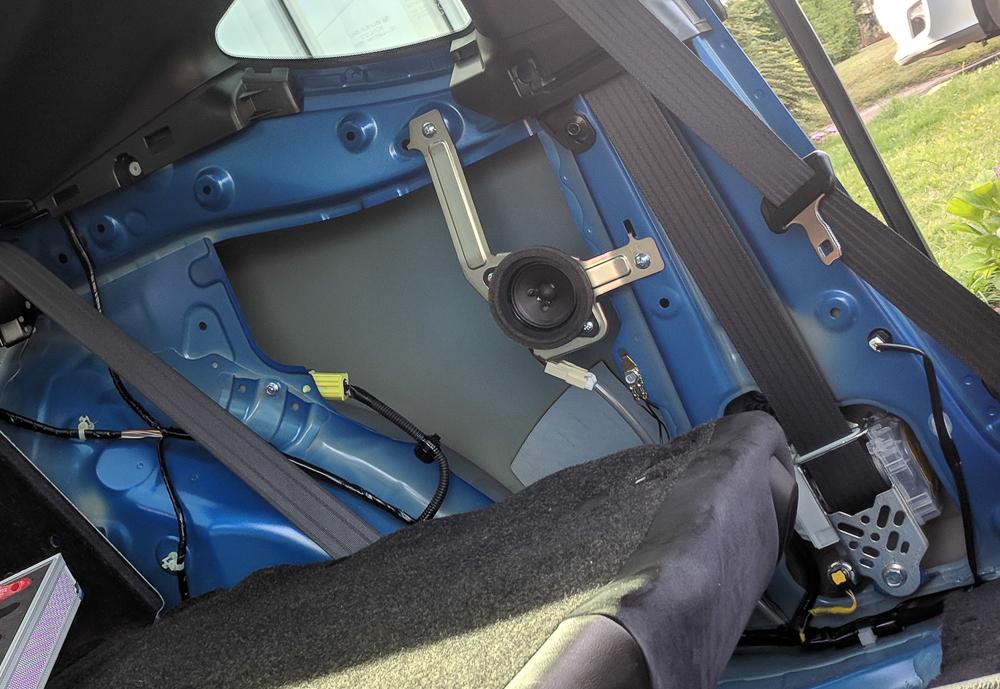

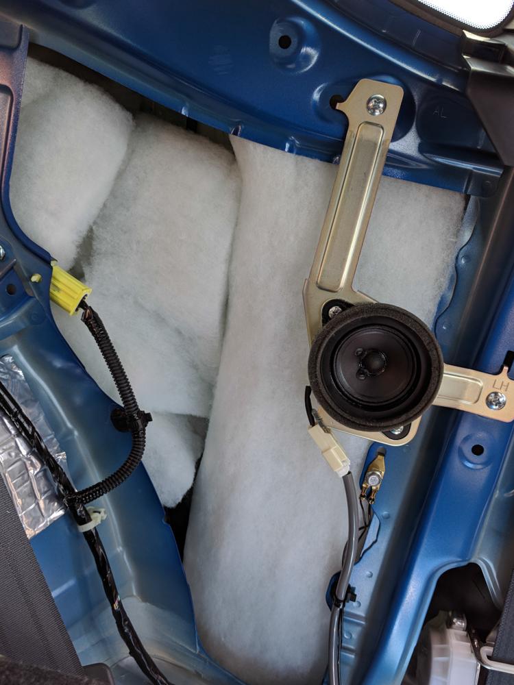

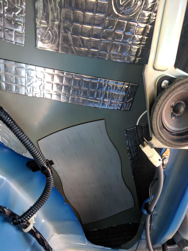

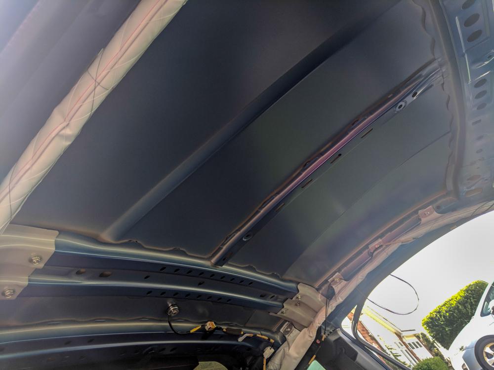

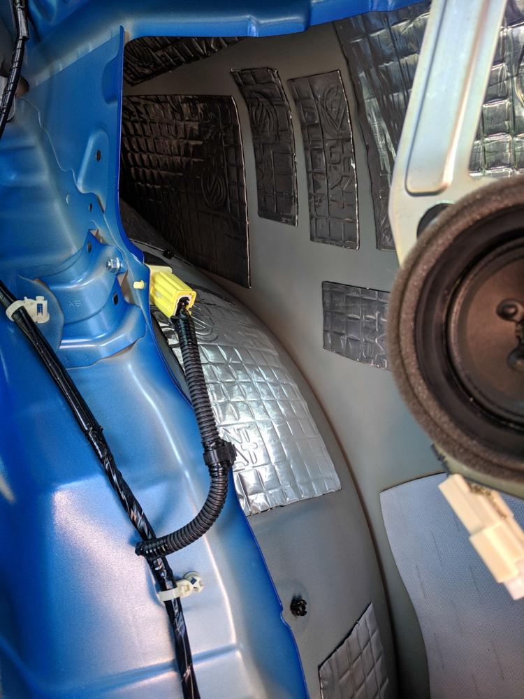

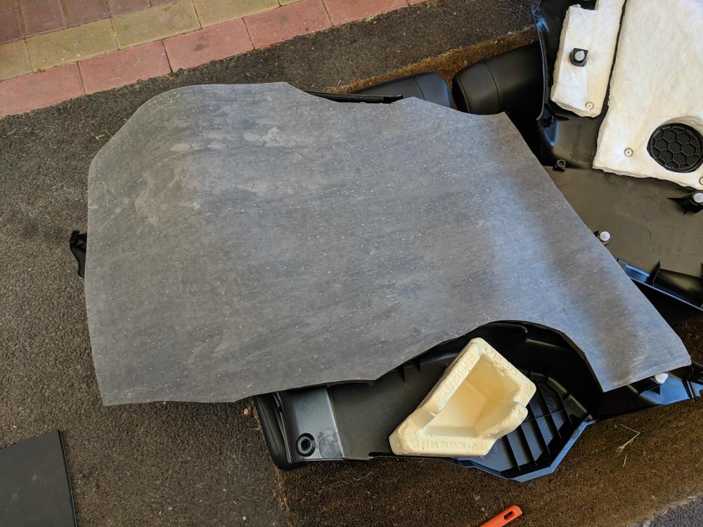

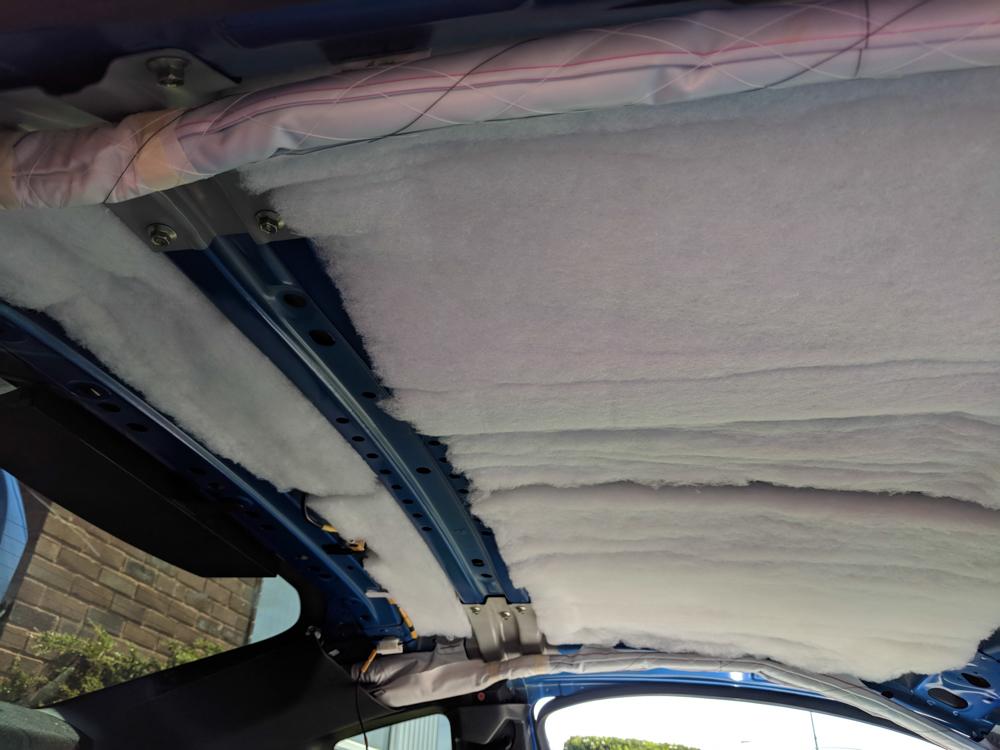

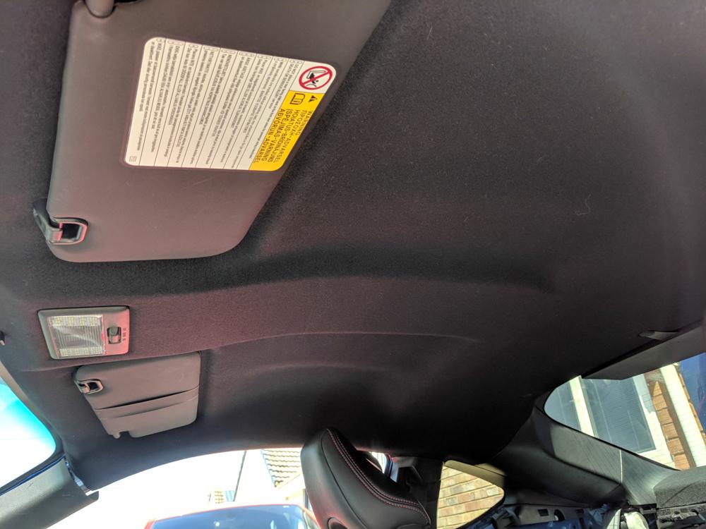

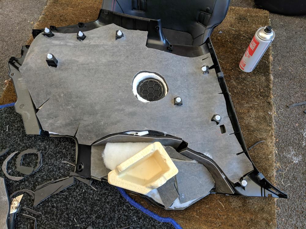

will300 812 Report post Posted July 15, 2018 Over the last few weekends I decide to start a new project on the BRZ, sound deadening. Recently during the last 6 months I've started to get feed up of the amount of road noise that gets feed into the cabin. So in an attempt to tackle this I did some research on the various 86 forums and came across the following guide: http://www.ft86club.com/forums/showthread.php?t=53511. Using that guide as a base I bought some sound deadening materials from Amazon and went about installing it all. Materials used: Silent Coat tiles - https://www.amazon.co.uk/Silent-Coat-187x265mm-Deadening-Proofing/dp/B00NVE013I/ Dodo Pro Barrier MLV - https://www.amazon.co.uk/Dodo-Mat-Barrier-Proofing-Camper/dp/B00LUOQWDY/ Silent Coat absorber foam: https://www.amazon.co.uk/Silent-Coat-Sound-Absorber-Proofing/dp/B00CV0BM0O/ Sound deadening insulation Over the next couple of posts will be various pictures of the install. I decided to start with one of the most difficult jobs of the lot, the roof. Followed by the rear wheel arches. Roof Install - Headlining removed Silent Coat tiles added Additional sound deadening insulation material Head lining re-installed. Rear Wheel Arches: Silent Coat tiles applied Sound deadening insulation material filling the remaining gap Dodomat Pro MLV added to rear quarter panels This has definitely helped as it moved the noise from the back of the cabin more towards the front, it's still to noisy though, on the next step. Share this post Link to post Share on other sites
