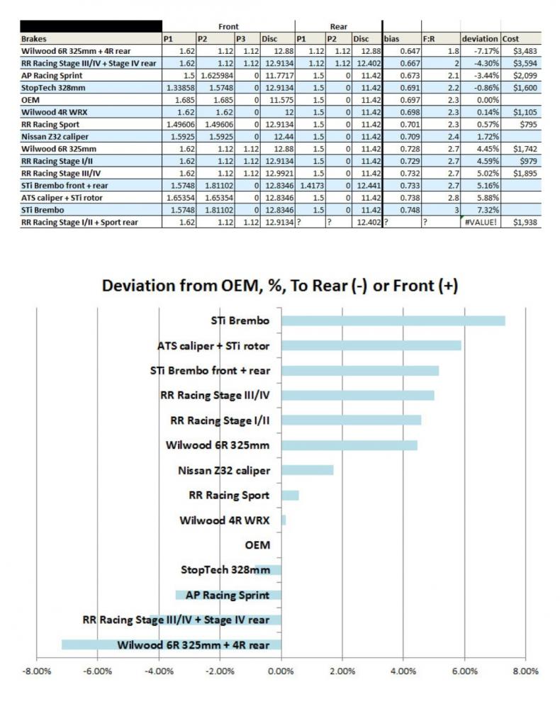

sentinal187 3 Report post Posted April 15, 2019 Have you run the numbers for the sti brembos to calculate the bias shift?Sent from my SM-G950F using Tapatalk Share this post Link to post Share on other sites
Deacon 1357 Report post Posted April 15, 2019 34 minutes ago, sentinal187 said: Have you run the numbers for the sti brembos to calculate the bias shift? Sent from my SM-G950F using Tapatalk Think this has it 1 sentinal187 reacted to this Share this post Link to post Share on other sites
sentinal187 3 Report post Posted April 15, 2019 Think this has it Thanks, worth working it out for the car in question tho.That assumes OEM car. Stock suspension, stock rake, stock tyres sizes, no weight reduction or other mods which affect weight balance like adding a turbo etc to the front.Sent from my SM-G950F using Tapatalk Share this post Link to post Share on other sites

Ade 517 Report post Posted April 17, 2019 Another thing to note about these BBKs, especially the ones moving bias forward; that may be a good thing. Stock suspension with Mitchellin primacies will not product the same forward weight transfer under braking as for example, my car with a supercharger (+20kg in the engine bay), Ohlins, and 235 wide AD08R tyres. Certainly @DanJ hasnt had a problem on the full impreza brembo setup and he is pretty quick on the track too. Share this post Link to post Share on other sites
sentinal187 3 Report post Posted April 17, 2019 Another thing to note about these BBKs, especially the ones moving bias forward; that may be a good thing. Stock suspension with Mitchellin primacies will not product the same forward weight transfer under braking as for example, my car with a supercharger (+20kg in the engine bay), Ohlins, and 235 wide AD08R tyres. Certainly [mention=1360]DanJ[/mention] hasnt had a problem on the full impreza brembo setup and he is pretty quick on the track too. Agree, I have the brembo setup front and rear. SC and oil cooler at the front, stripped out at the back, 255 and 235 ps4 tyres, I gobble people up in the braking zones. Sent from my SM-G950F using Tapatalk Share this post Link to post Share on other sites

BRZ-123 174 Report post Posted April 17, 2019 Another thing to note about these BBKs, especially the ones moving bias forward; that may be a good thing. Stock suspension with Mitchellin primacies will not product the same forward weight transfer under braking as for example, my car with a supercharger (+20kg in the engine bay), Ohlins, and 235 wide AD08R tyres. Certainly [mention=1360]DanJ[/mention] hasnt had a problem on the full impreza brembo setup and he is pretty quick on the track too. Add to it most of the NA modified cars have a lighter manifold and overpipe than stock, circa 3Kg less 6kg vs 9 IIRC. So matters even more I guess. Sent from my FIG-LX1 using Tapatalk Share this post Link to post Share on other sites

gavin_t 184 Report post Posted April 22, 2019 Interesting topic with some good info. From my searching over that last few months I had settled on the K-Sport 330mm kit. Anyone know of any bias information for this kit? One thing I haven't found much info on. People who track the setup don't seem to have any complaints on the feel but would be interesting to know. Share this post Link to post Share on other sites
