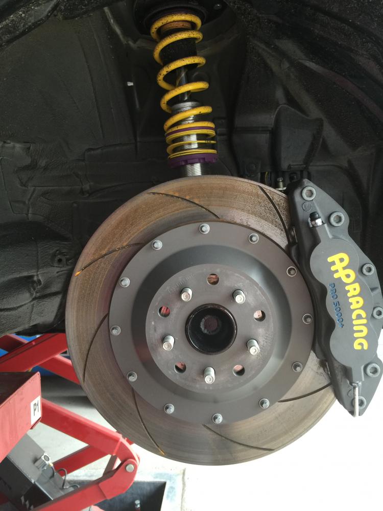

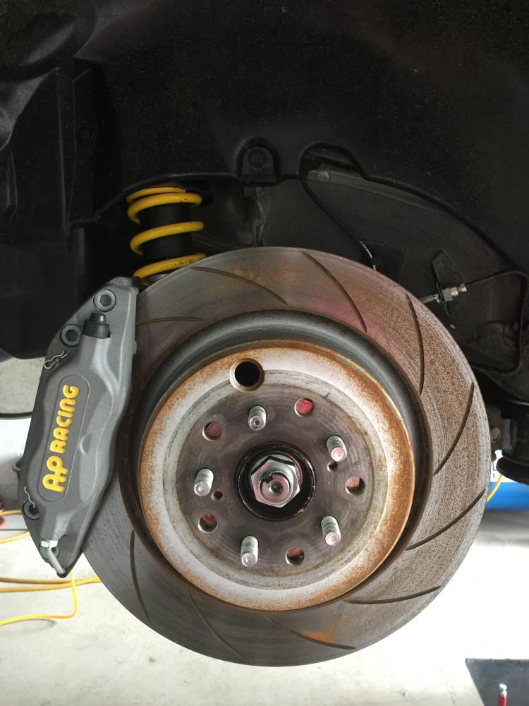

BOBEL 73 Report post Posted April 14, 2019 I don’t post on here much but I can certainly speak to the quality of AP 6pots, I run a gt86 racecar and have completed >15 Trackdays now and still on my original Ferodo DS3000 pads and I assure you I am not easy on brakes. The 6 pots are expensive but the braking power is immense, the bias with 4pots on the rear is perfect and I rarely trigger the abs unless I get on them terribly late. Share this post Link to post Share on other sites
Badger 63 Report post Posted April 14, 2019 I don’t post on here much but I can certainly speak to the quality of AP 6pots, I run a gt86 racecar and have completed >15 Trackdays now and still on my original Ferodo DS3000 pads and I assure you I am not easy on brakes. The 6 pots are expensive but the braking power is immense, the bias with 4pots on the rear is perfect and I rarely trigger the abs unless I get on them terribly late. what size discs out of interest?Sent from my LYA-L29 using Tapatalk Share this post Link to post Share on other sites
BOBEL 73 Report post Posted April 14, 2019 Front are 32mm x355mm float in disc type 1 Badger reacted to this Share this post Link to post Share on other sites
Badger 63 Report post Posted April 14, 2019 Front are 32mm x355mmI'm guessing the rears are standard diameter?Sent from my LYA-L29 using Tapatalk Share this post Link to post Share on other sites
BOBEL 73 Report post Posted April 14, 2019 Yes same as standard I believe 24mm x 335mm Share this post Link to post Share on other sites
