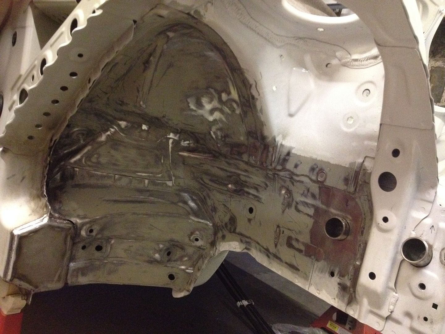

Guest Report post Posted January 16, 2015 OK Mark in Stoke.. you asked for them, so here they are, probably the two most boring pics in this thread!! Note the holes for spark plug access tubes. Welding starts tomorrow I think?? Share this post Link to post Share on other sites
nikndel 509 Report post Posted January 16, 2015 Are they the 2 tubes for plugs removal? Share this post Link to post Share on other sites
Guest Report post Posted January 16, 2015 Are they the 2 tubes for plugs removal?They sure are... they're only in place at the moment, not welded yet Share this post Link to post Share on other sites

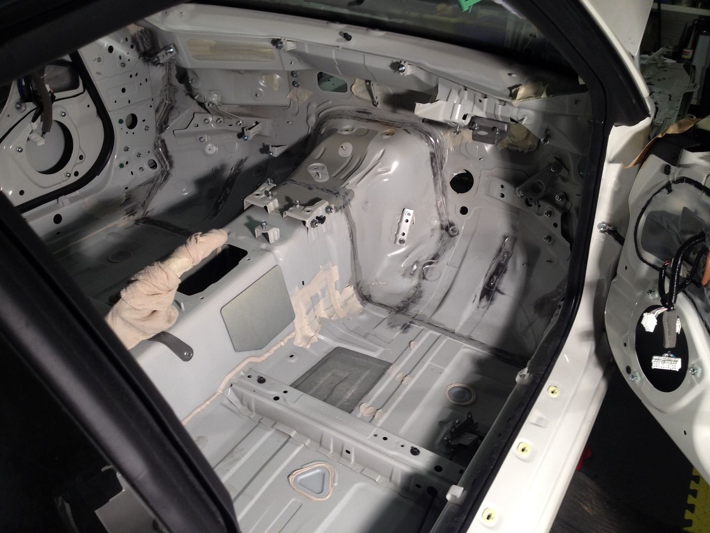

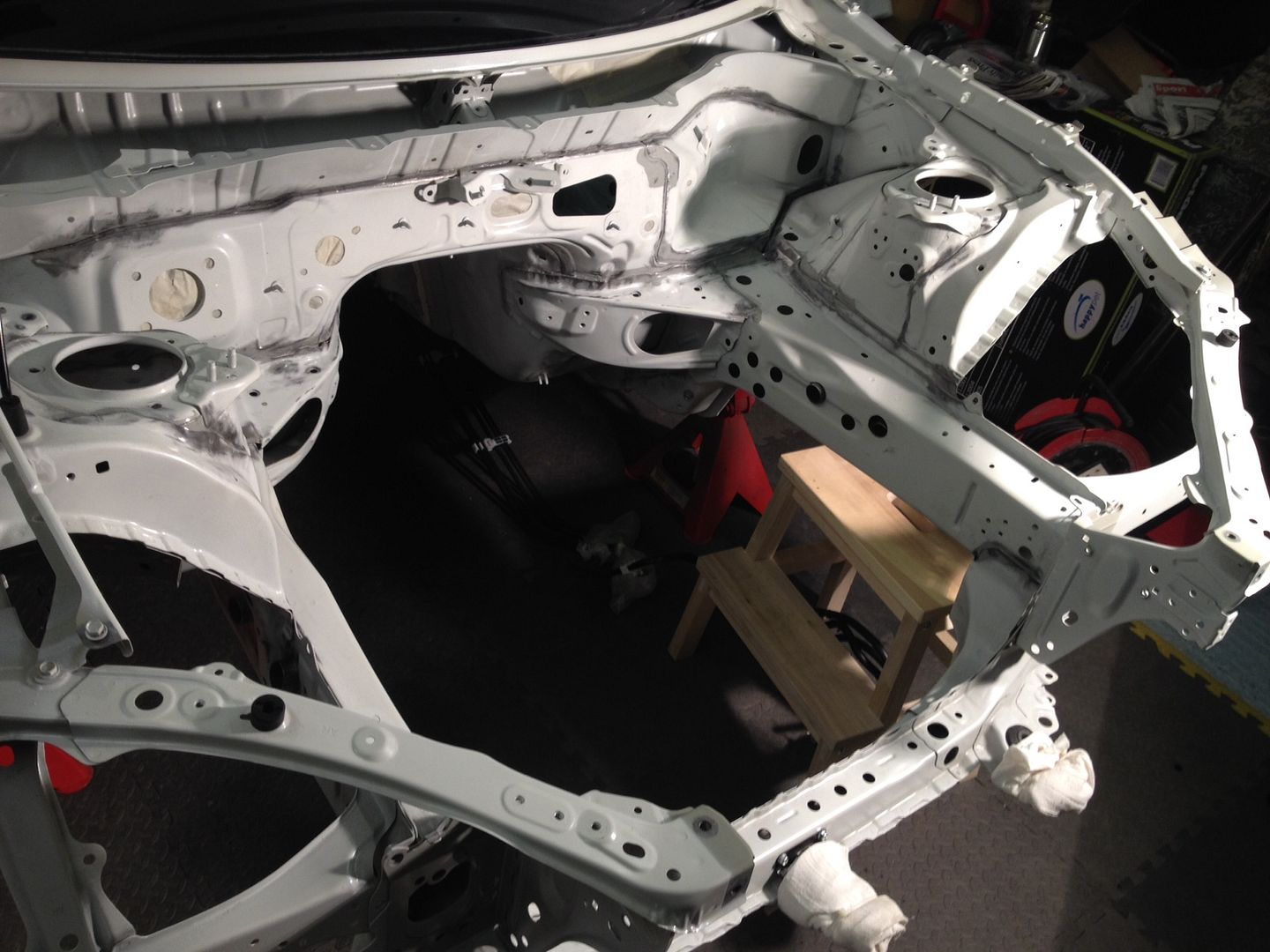

Guest Report post Posted January 18, 2015 Here's my final update on the subject of stripping... All the seam sealer and underseal is out of the front end now, up to the transverse seam in the tunnel and floor. In this shot we can see the seams all stripped out in the engine bay. I cant decided whether I should go for the JDM look and spot weld the seams or go for the traditional method of welding an inch, missing two and so on? In my opinion the latter looks a lot more professional.The wooden stool is protecting the fuel lines from being bent. Ideally I would like to remove them, but I would need to take out the tank to get all of them out of the way, which means the rear subframe would need to be dropped. I simply have no more room to store any more GT86 parts!!Here we can see the interior with all seam sealer and sound deadening removed. The wiring is tucked back where the rear seats would normally be. I didn't want to risk a spatter ball hitting the seats and burning them, so out they came. Likewise with door panels and carpet.Finally, the left front wheelarch. Note I've removed a section of the vertical box section around the spark plug tube. This is to allow access to weld the tube to the actual chassis rail for integrity. Obviously I will weld this section back in after the tube is welded in.Thanks for looking in, welding shots will be next... Share this post Link to post Share on other sites
Keethos 842 Report post Posted January 18, 2015 Just wondering Nige, once everything is put back together, would the inner plastic wheel arch moulding cover up your new spark plug access tubes? If not, will you be covering the holes up while driving? Would it even matter if they were exposed to the elements while driving i.e. getting water in there etc? Share this post Link to post Share on other sites
Guest Report post Posted January 18, 2015 Hi Keith,I intend to plug the holes with some kind of bung. The internal bore of the tubing is 27.5mm, so if you have any ideas??? I'd hate a large stone to find it's way in and wedge between the rail and head. The arch liner doesn't cover them. Share this post Link to post Share on other sites
