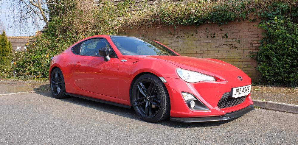

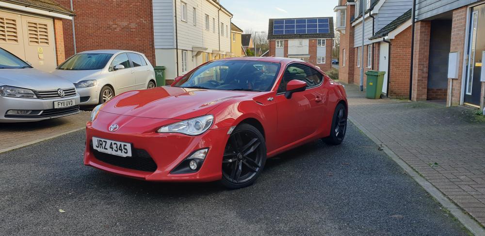

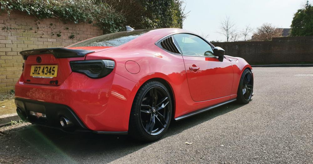

likaito 28 Report post Posted March 30, 2020 Hello all, I wanted to keep track of my mods over time for myself more than anyone really but if it gives people ideas then great! I've had the car for 5 months now and was originally 100% stock. As the title suggests, being young and not having deep pockets just yet, my build is centered around mods that are affordable and I try to get 2nd hand stuff where I can and DIY everything. Red and black is by far my favourite combination, and currently am looking to add more black bits to it. I'll show the initial photo (can't find one with stock wheels on) and the most recent one below. The list of modifications thus far (I'll include prices if anyone was curious): 18 inch ET35 RS style wheels £400 Smoked sequential tail lights £200 white LED interior and license plate lights £10 Carbon effect lip spoiler £80 Blacked out badges (free - plastidip lying around) Window louvres £15 Used Berk dual exit muffler delete £130 Used TD 2nd cat delete £80 HT Autos splitter, side skirts and rear spats £299 OEM rear diffuser (£120 new from other forum member - is £160 ish from fensport) Whiteline 25mm lowering springs £130 EBC brake pads £50 Gloss black roof and wing mirror wrap (£50 for roll - wrapped myself, was quoted around £200 from various shops) Over the next few weeks, I've ordered some smoked side markers and smoked front corner signal lights to get rid of a lot of the chromey lights. Next month, planning to get some black housing VLAND headlights if no 2nd hand ones are up for sale. Stock (except wheels): Current state: 1 Lauren reacted to this Share this post Link to post Share on other sites

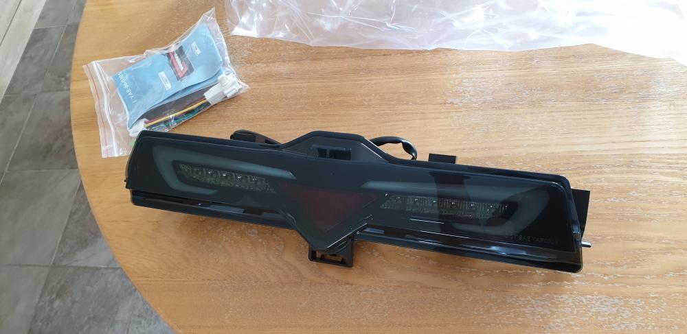

likaito 28 Report post Posted April 2, 2020 So in order to keep myself busy during this period, I've gone a bit crazy and ordered a load of bits and bobs for the car. I was going to get these sooner or later so it appears that it will be sooner. After these mods, that will be it for the cosmetics. No more mods until November where the TD NA Package is coming. Ordered parts: MTEC Clutch Spring from TD VLAND Sequential Headlights VLAND 4th brake light Smoked side markers Smoked front corner signal light D2H bulbs for headlights Will update as they arrive. Mike from TD said the spring will arrive tomorrow! Share this post Link to post Share on other sites

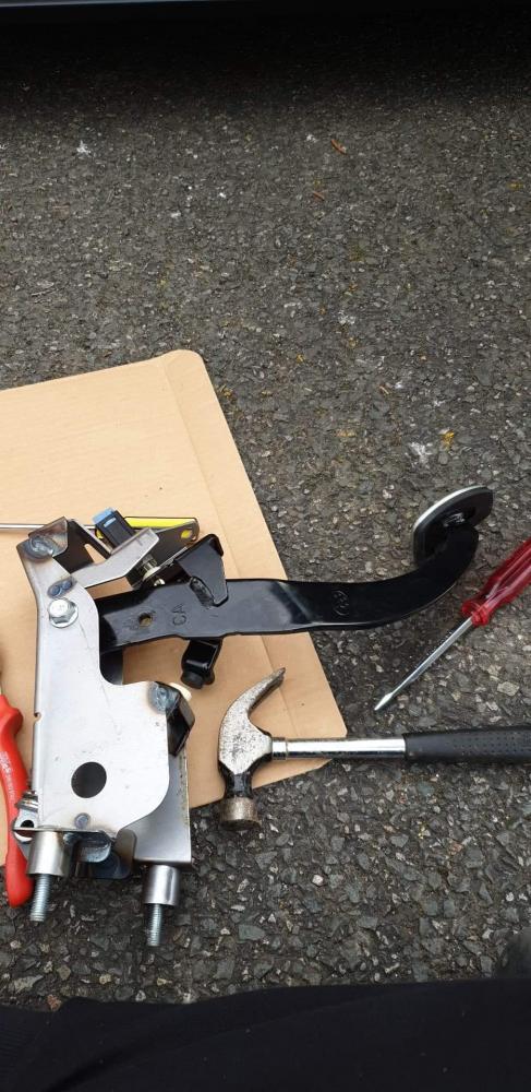

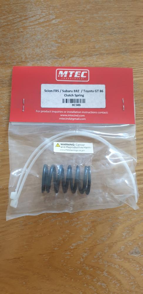

likaito 28 Report post Posted April 3, 2020 Mtec clutch spring! Thanks a lot @Mike@TD.co.uk, delivered in a day like he said! Install was fairly straightforward, although very very uncomfortable and tight due to the lack of space in the footwell and engine bay. Once the clutch pedal assembly is off, rest is easy. Getting it off was the pain for me. First impressions on a short drive to Tesco, clutch is slightly firmer and removes the initial play/sponginess in the stock spring. Engagement and feel is improved drastically and can actually feel the bite point. Also, makes changing gears more enjoyable and faster as the clutch springs back up more. Would recommend, simple and cheap mod. 4 spikyone, 86iain, ThatGuyThere and 1 other reacted to this Share this post Link to post Share on other sites
spikyone 139 Report post Posted April 3, 2020 Nice, I'm tempted by one of those too. I'd also recommend the shift spring and gearbox mount insert, really cheap and you'll enjoy changing gear even more with those fitted. Mike did mine when I had the NA kit & exhaust fitted and I was blown away by the difference in gearbox feel. 1 likaito reacted to this Share this post Link to post Share on other sites
likaito 28 Report post Posted April 4, 2020 9 hours ago, spikyone said: Nice, I'm tempted by one of those too. I'd also recommend the shift spring and gearbox mount insert, really cheap and you'll enjoy changing gear even more with those fitted. Mike did mine when I had the NA kit & exhaust fitted and I was blown away by the difference in gearbox feel. Yes I was also planning to do that when I get the NA Kit as well haha 👍😂 only issue is I haven't got a jack atm so can't lift up the car. Also, for anyone who wants a guide this video I followed is perfect. Really easy and clear. 1 spikyone reacted to this Share this post Link to post Share on other sites

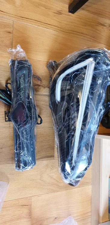

likaito 28 Report post Posted April 6, 2020 VLAND headlights and bumper light arrived, will fit them both tomorrow! Can't wait to remove all that chrome on the car Share this post Link to post Share on other sites

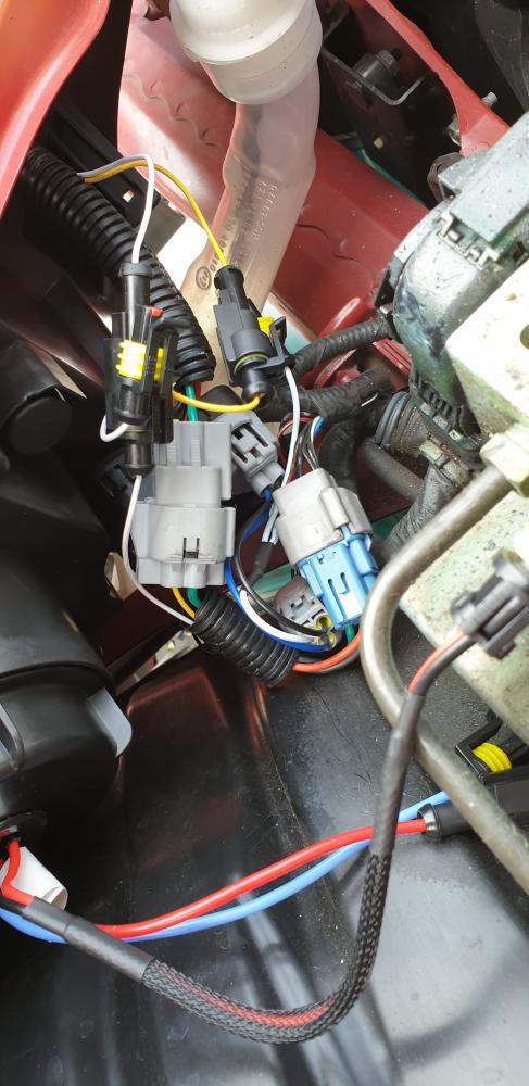

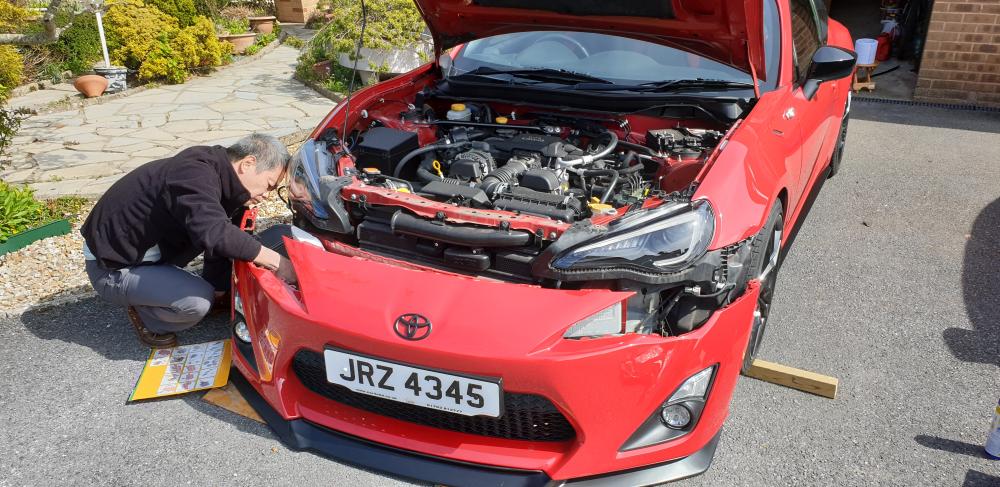

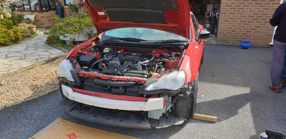

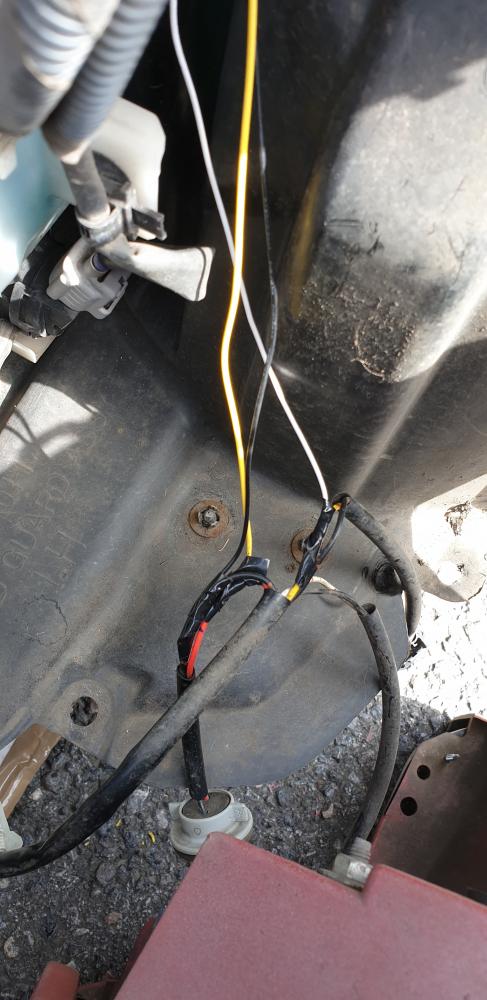

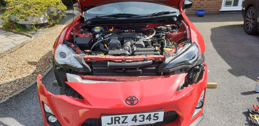

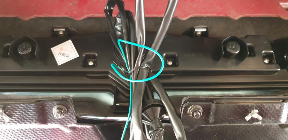

likaito 28 Report post Posted April 7, 2020 So, VLAND headlight installed today. Took way longer than I thought, around 4 hours but was fun. Initially took off the bumper which was the easiest by far, was expecting it to be a pain. Taking off the brackets holding the headlight was pretty easy as well. Side by side comparison shows how chromey the stock primo lights are. The wiring was the most challenging for me, just because I have zero experience with splicing and electrical stuff. I'm a mechanical engineer not electrical 😂 i promise I will tidy the wiring up one day after that, straightforward to reinstall the bumper. In my opinion, they transform the front end of the car and makes it look so much better. Would be happy to hear some opinions on them! P.s. thanks dad for helping me tidy up the cables 😂 2 Tweedbean and Quantum reacted to this Share this post Link to post Share on other sites

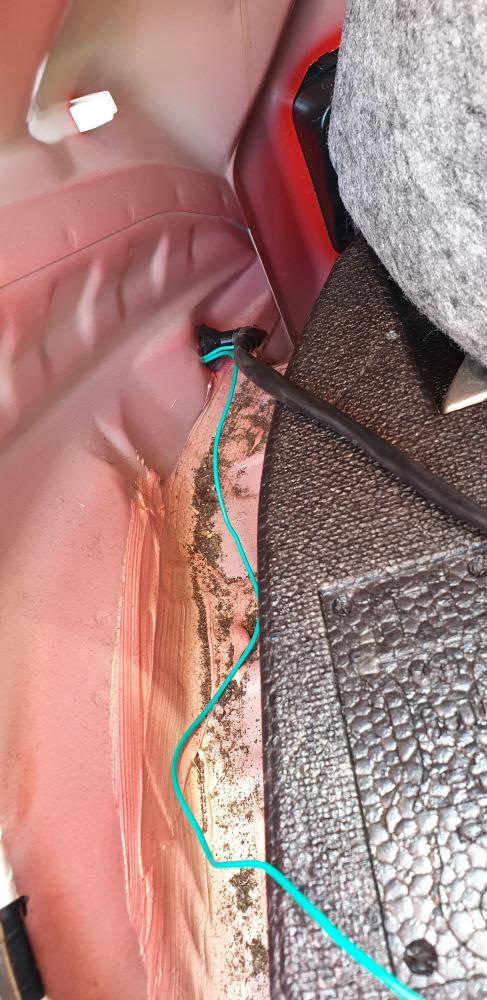

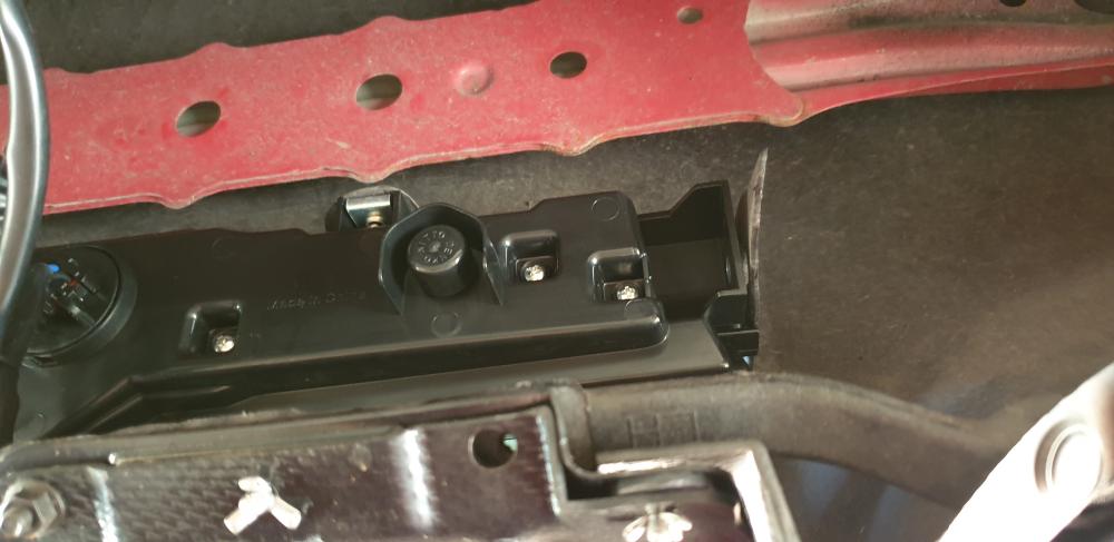

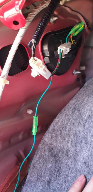

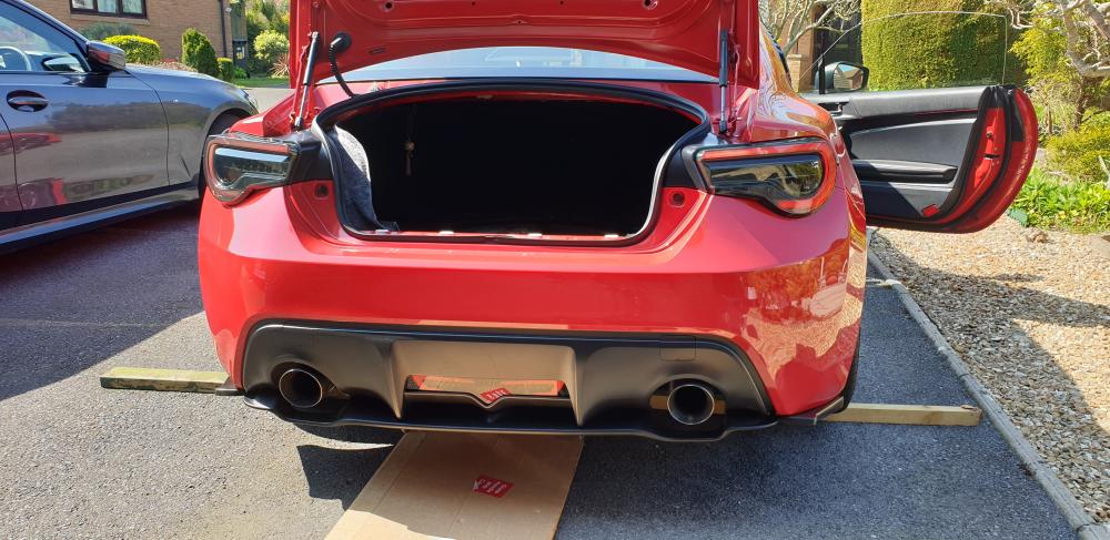

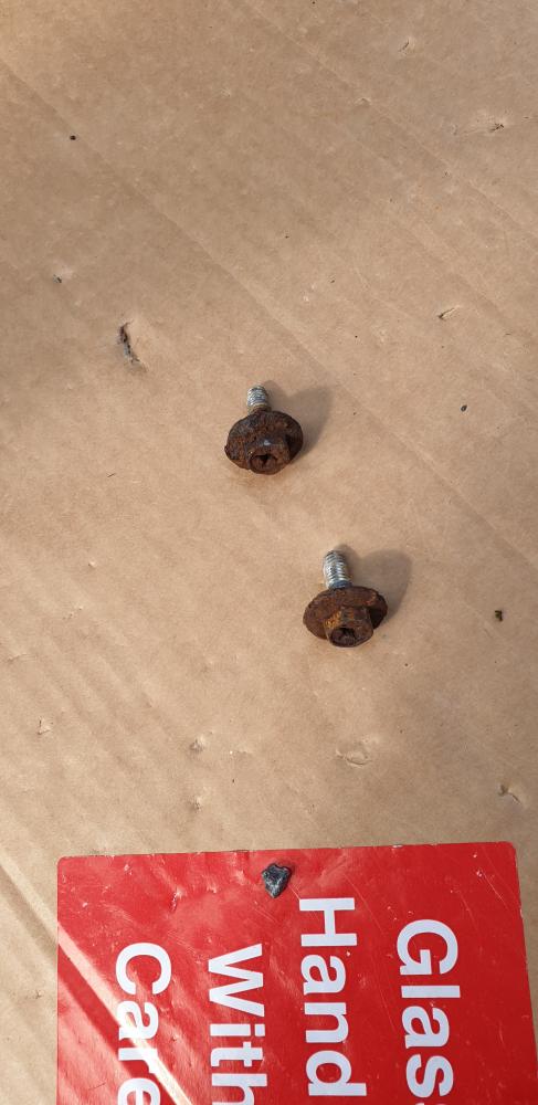

likaito 28 Report post Posted April 8, 2020 So fitted the VLAND bumper light to complete the VLANDs all around. Straightforward install, took around an hour and a half. The hardest bit was getting off the 2 rusted 10mm bolts holding it on. Apart from that, just unplugged and removed stock one then replaced with the new one. The wiring is super super easy, plug and play. There's an additional harness that plugs into the tail lights and connects the extra wire to the bumper light for the brake light to work. Job done. Super easy install. Very happy to complete the look and remove that chromey bumper light. The reason I went for the VLANDs and not the Valenti ones with a V bar is just because these are way less common from what I've seen (they seem to be the only choice) and way cheaper. Plus I think they compliment the tail lights well and are just different. Pictures are a bit crap because the sun was directly on the car, will try and get some decent pics in the next day or so after I install the sunstrip 😊😊 1 Tweedbean reacted to this Share this post Link to post Share on other sites
