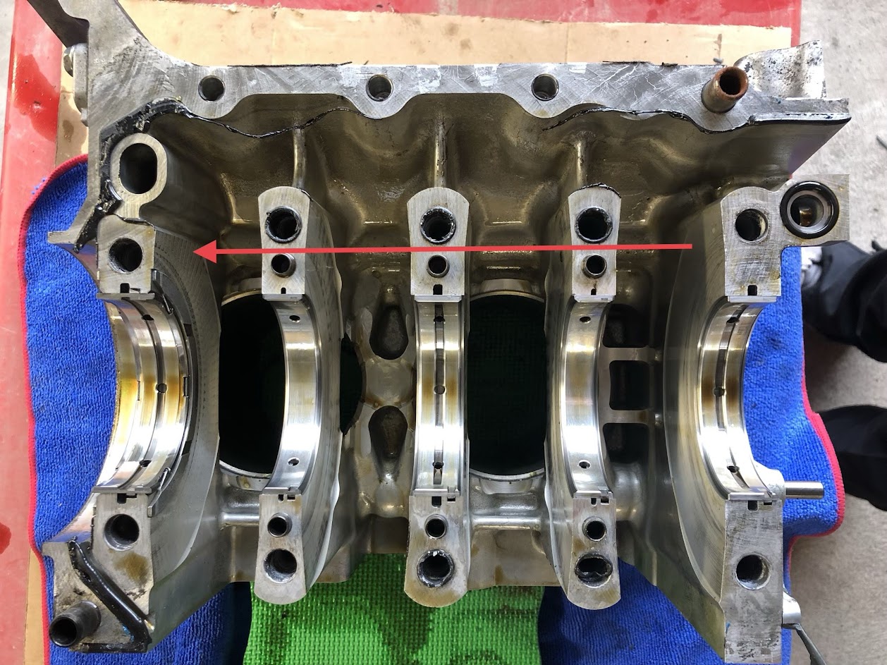

BOBEL 73 Report post Posted March 23, 2020 So with that lot apart it was time to examine the oil galleries and come up with a plan to address the FA20's shortcommingsFirst up is the crank, the crank has 5 main journals, but only 3 of them provide oil to the 4 big end journals, and here in is one of the issues, almost 100% of bearing failures in the FA20 are rod 2 or 3, and if you look at the crank you can see why.The first main journal on the right feeds Conrod 1, and the last main journal feeds Conrod 4, so that leaves main journal #3 feeding two conrods yet it isn't sized to supply twice the oil volume, so whenever oil flow/pressure drops in the engine these two rods get starved and eventually you end up with at least one of them spinning a bearing.The main galley runs just below the journals where the red arrow is show and the plan is to drill it out to 12mm from the front of the block as far as No.3In order to get the full benefit though, the galleries the whole way from the pump supply in the front cover really need to be enlarged too.So the front of the block needs to be ported where the oil enters from the front cover. The oil path to the main gallery below the journals is a bit convoluted as its not a straight shot from the front cover, it comes in the top hole, travels down and then into the block, the hole that actually sits at the front of the main gallery in the picture below is capped with a timing chain tensioner but at least it will allow access to run a 12mm bit down the main gallery. 1 Deacon reacted to this Share this post Link to post Share on other sites

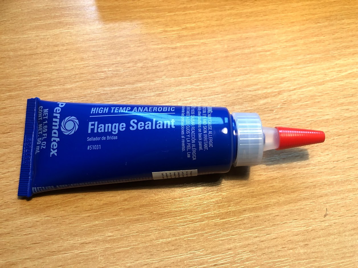

BOBEL 73 Report post Posted March 24, 2020 After a lot of research and speaking to another owner who built his engine too I think I’ve found a solution the OEM excessive RTV issue aswell. This sealant is anaerobic and only sets in the absence of air, but will seal any machined surfaces as well or better than an RTV, so even if it’s over applied and gets near an oil gallery it simply stays in liquid form and is flushed out by the oil, causing no hard to the oil pickup or oil supply. I wasn't able to use it in every location as it requires a very small gap tolerances between the mating surfaces but it worked well for most of the long block which is where these engines give most issues! While the block is off at Westward Engineering I kept entertained by stripping the donor car of a few more bits. The standard gearbox is weak, and a lot of people have had failures in and around 400hp, while I don’t intend to run that much power my plan was always to have a spare gearbox on hand if required, and while liberating it I also pulled out the rear diff. I had planned on maybe trying a different final drive ratio, I find the OEM gear ratios don’t quite suit in a few places around my local mondello park. Share this post Link to post Share on other sites
