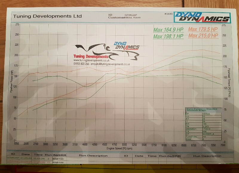

KevinA 695 Report post Posted August 16, 2017 After TD manifold and remap.....what torque dip. 2 Mike@TD.co.uk and Lauren reacted to this Share this post Link to post Share on other sites
Lauren 2259 Report post Posted August 16, 2017 DAFL! After TD EL manifold and remap. What torque dip? GT86- Manifold and Exhaust by Lauren Blighton, on Flickr 3 Mike@TD.co.uk, Ccolleavy and ttjt16 reacted to this Share this post Link to post Share on other sites
