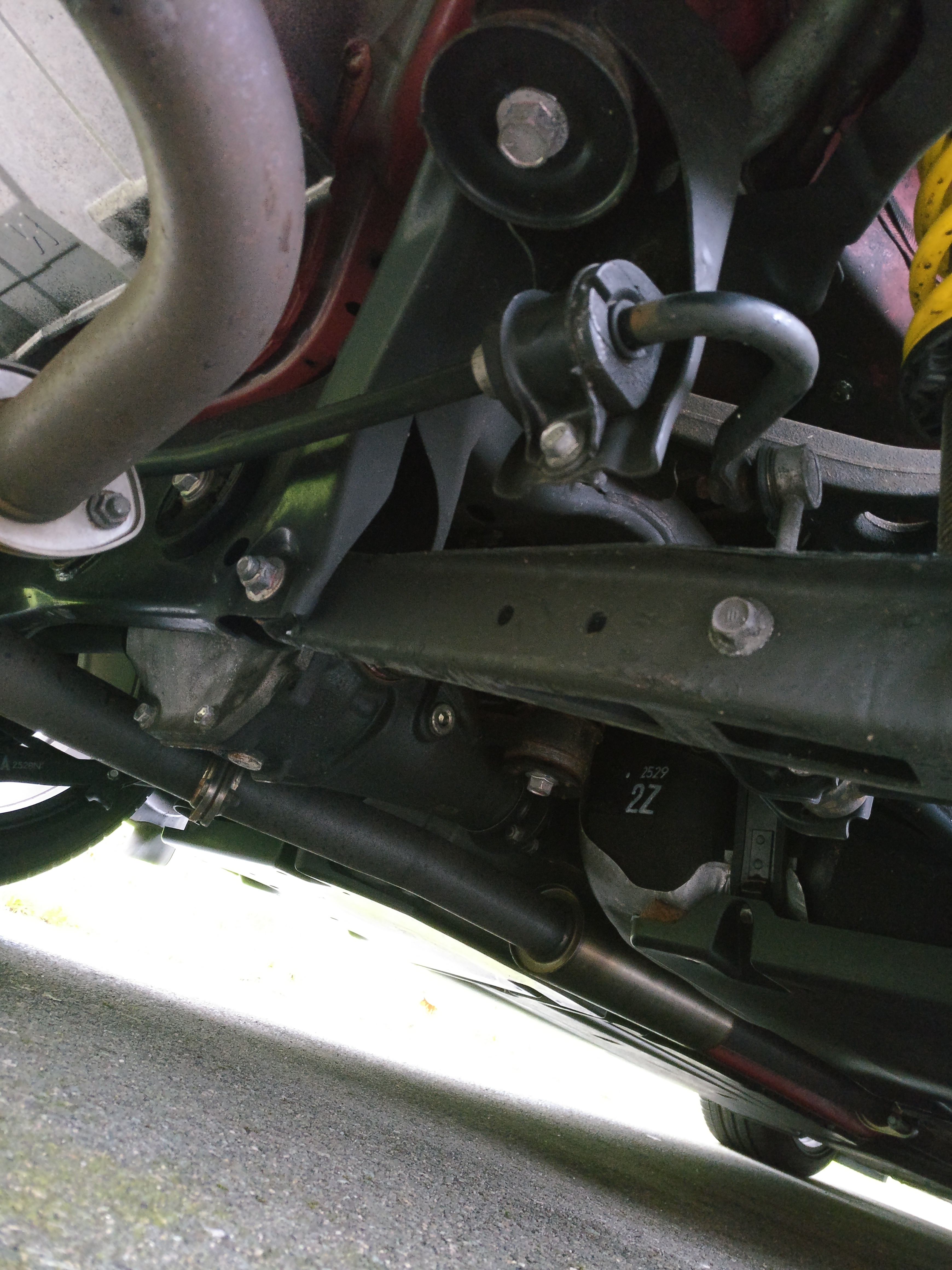

Ade 517 Report post Posted March 21, 2017 are you on stock roll bars? and what tyres? Share this post Link to post Share on other sites
ThatGuyThere 54 Report post Posted March 21, 2017 Michelin Pilot Sport 3 tyres. Stock as far as I know - does this photo help?! Share this post Link to post Share on other sites
