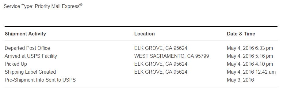

S18 RSG 429 Report post Posted May 5, 2016 Well I finally gave in. I'm sure most of you can make an educated guess on what I went for: 2 Keethos and Rich reacted to this Share this post Link to post Share on other sites
