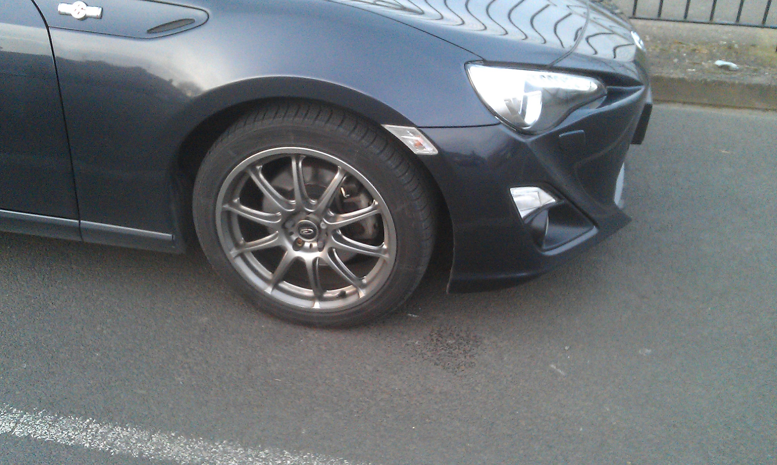

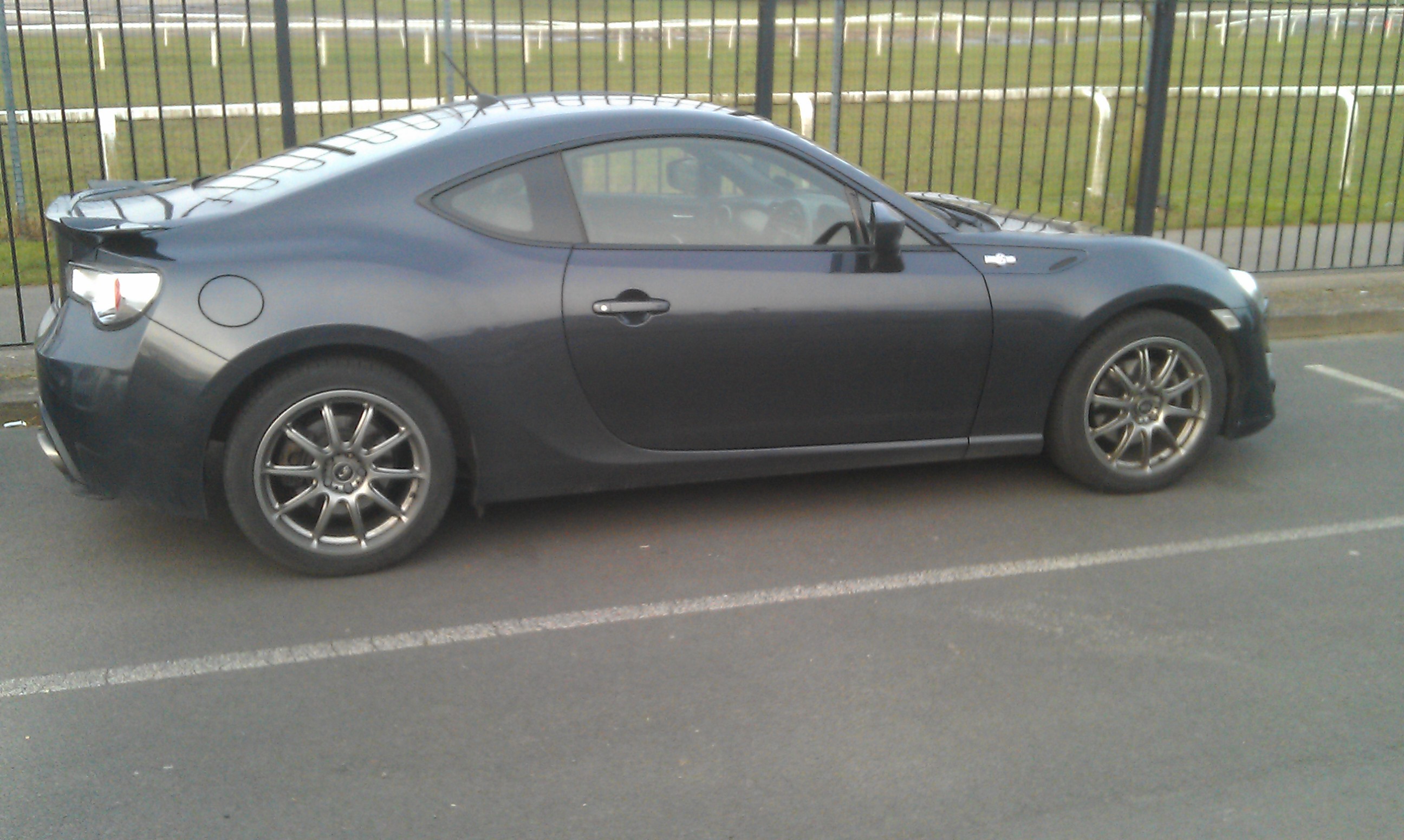

Galaxian 6 Report post Posted February 26, 2016 My winter wheels - Rota GRA steel grey 17X7.5 OEM tyre size Share this post Link to post Share on other sites
