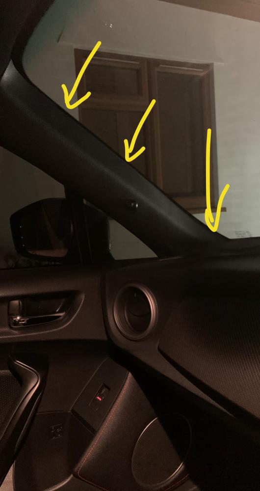

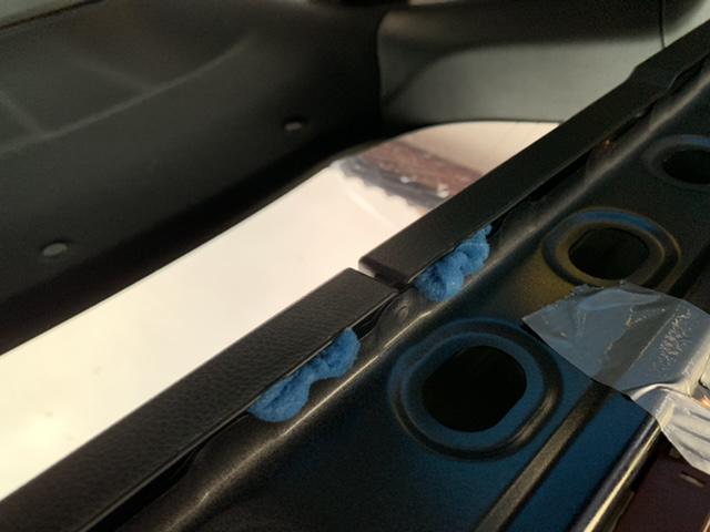

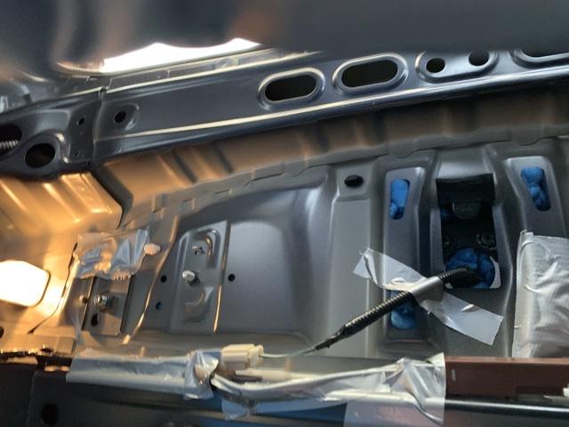

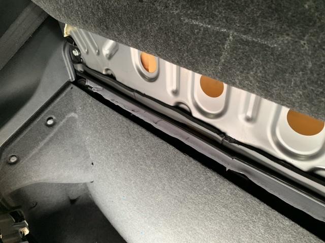

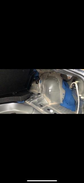

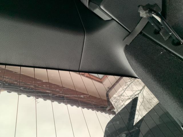

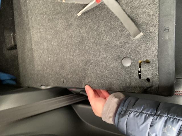

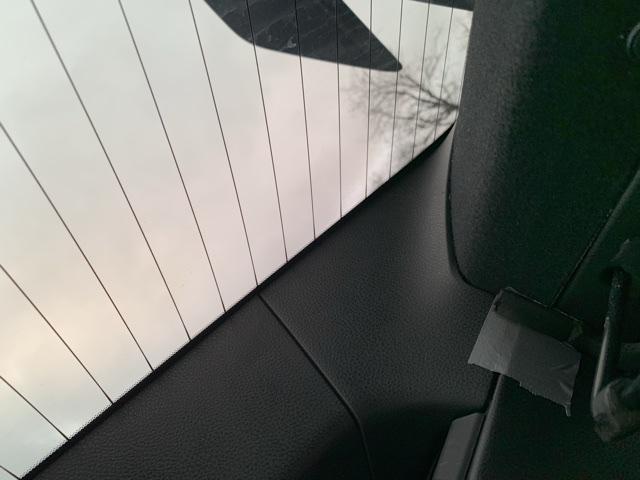

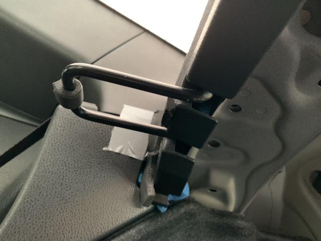

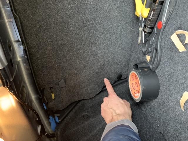

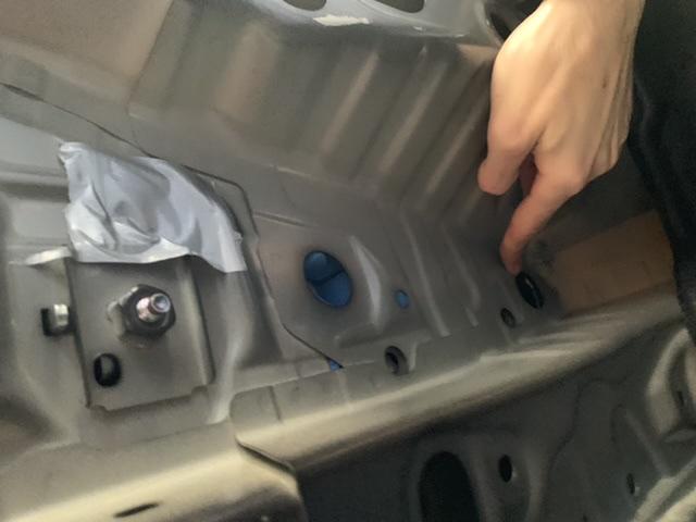

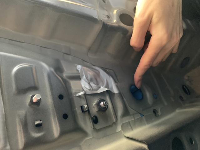

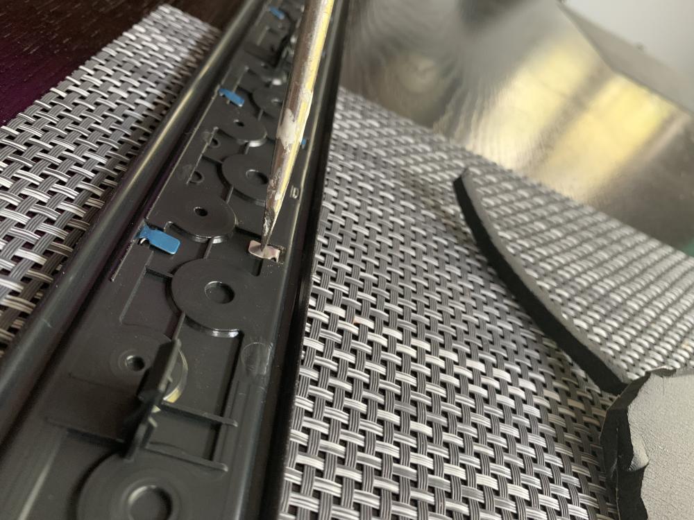

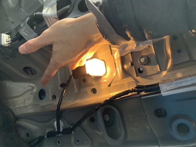

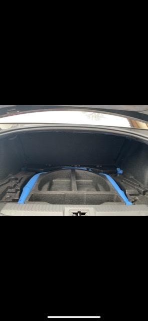

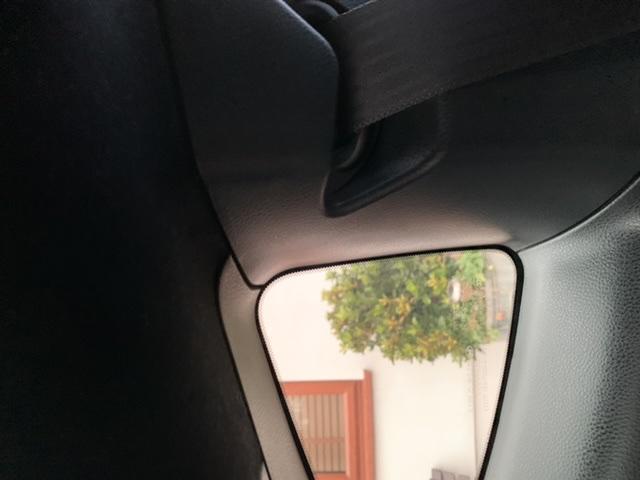

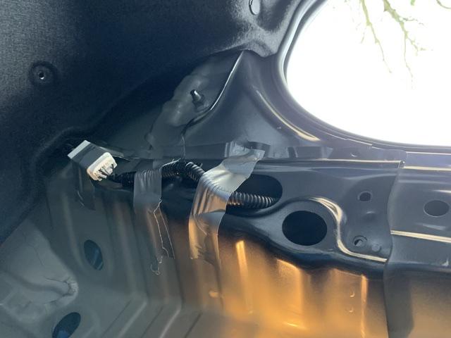

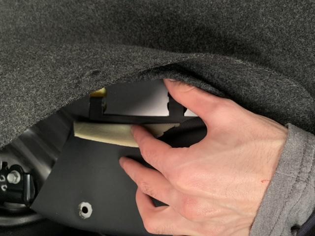

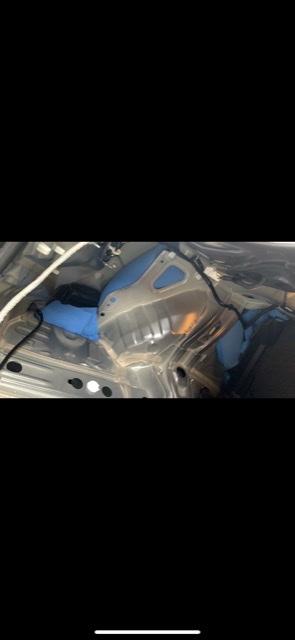

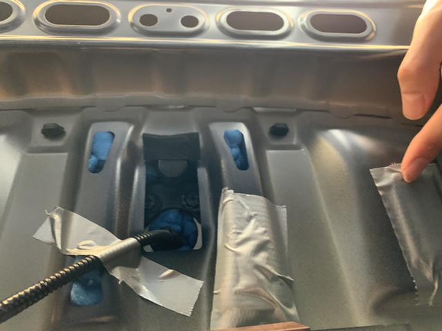

Jay Bamrah 29 Report post Posted January 11, 2021 I know theirs 1000 posts on this but I think the more people that post on it the better. Each post might have something of value to someone so I wanted to as well. first rattle is here this is what it looks like exposed... The plastic clips rattle here so I used adhesive foam on the bottom of them(link at bottom to cheap foam) Next rattle is this ... the exposed part is made of plastic and so I put adhesive foam here (this is the bottom of the back seat) next is here ... This corner piece on both ends rattles against the glass window, I filled behind it with foam. The hole here is what hole you need to push foam through to fill it, i recommend you put your finger in first to feel where it needs to go, photo of hole is below... next is here... (at the top of the window that plastic piece) the roof liner is lose you can easily get small chunks of foam and push them in there hidden... next place ... this area in general, I know it looks ugly how I did it but it’s all invisible when the seats are back so I don’t care, I just made it tight as hell, no movement.. next... this is where the break light is... that piece, I put foam on the edge where it sits against the back seats as it was plastic on metal and had movement... next... next is all of the holes in the boot, this pushes the third break light up so it can’t vibrate on the glass window. I filled every hole and put duck tape there to make sure it doesn’t pop out. Also every cable here I made tight so they can’t move about here is one extra photo Next part... this is the obvious part, I put foam where the wheel arches are and then I put adhesive 3m foam EVERYWHERE after that, im sorry I have no photo of that but you know what I mean, the entire boot is covered in 3m adhesive foam. Hope I had some stuff useful to you. THIS IS THE FINAL LOOK FROM BOOT...oh I also did that part on the boot door I just took that off and put foam underneath, makes opening and closing the boot feel nicer too hope I can help someone ADHESIVE FOAM - https://www.ebay.co.uk/itm/3M-6mm-Car-Sound-Proofing-Deadening-Camper-Van-Insulation-Closed-Cell-Foam-Sheet/184106555361?pageci=20637d0f-8686-41bb-9ca2-a8a4cfb8a525 REGULAR FOAM - https://www.ebay.co.uk/itm/FOAM-SHEETS-CUT-TO-70-x20-x1-TO-5-IN-DEPTH-DENSITY-HARD-MED-SOFT-/264125917402?pageci=c327efe7-12b0-4865-a00d-33d9dedbcdb8 ——————————-THE END—————————— 1 1 Stutopia and LGE reacted to this Share this post Link to post Share on other sites

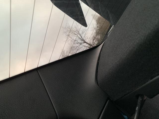

Jay Bamrah 29 Report post Posted April 24, 2021 I found one more, it sounded like it was the dash making the noise for ages but I did this two days ago and I haven’t heard a noise since. In fact I don’t have any rattles at all now for two days anyway lol. Just buy black foam on Amazon for £3 it’s way more than you need and get a thin strip push it down there then use a straw to push it in where your fingers can’t. It’s invisible Share this post Link to post Share on other sites

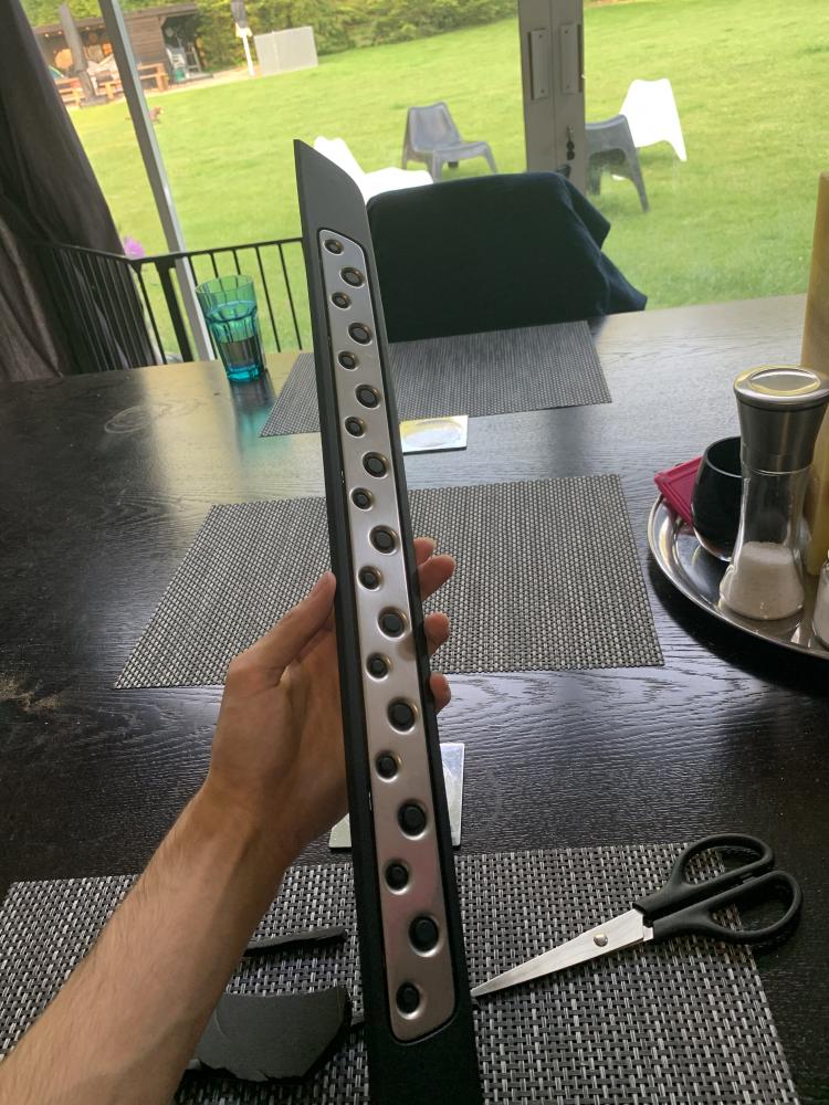

Jay Bamrah 29 Report post Posted June 4, 2021 I found another rattle which I thought was my passenger seat. Turned out to be this. FOOTWELL AREA tap the silver plastic part and it will sound slightly loose. When driving on not perfect roads it sounds like spare change in your pocket but near the door. to take them off is super easy. Next get a screwdriver and then press the metal clips on the back to make a firm contact with the plastic part of it. It will now be tight and won’t make any noise. Share this post Link to post Share on other sites
