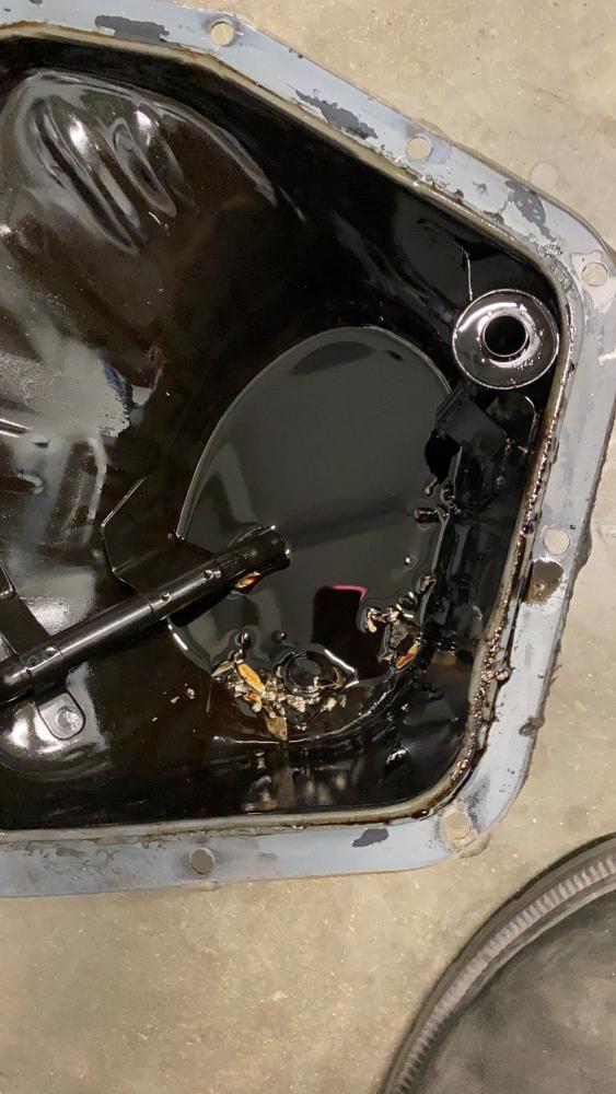

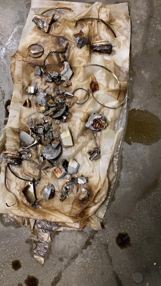

Not been driving my car much this year but has had it regular services with Toyota recommended oils. About 2 weeks ago I had a good drive around the country lanes, wasn’t fast driving but cruising around. Was about 30-40mile round trip. Parked it up for the night. Woke up next day to drive my partner to work I started it and it sounded like a proper Subaru I mean that rumble sound. I drove it 5 mins to her work and it cut out. Wouldn’t start. It didn’t run very well driving there either. I thought maybe it was just cold and had a misfire. I checked oil, level was fine. I left it for a few hours and got my dad to come have a look as he runs his own garage. Got it stated, it sounded like metal clunking so shut it off instantly. Got it towed home and waited till today to get it to the garage. Got sump off and found all this inside. First thing I see is the valve head. Here is a picture of most of bits in the sump.

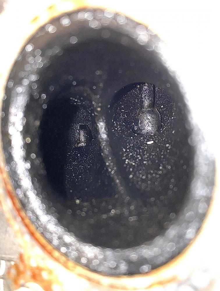

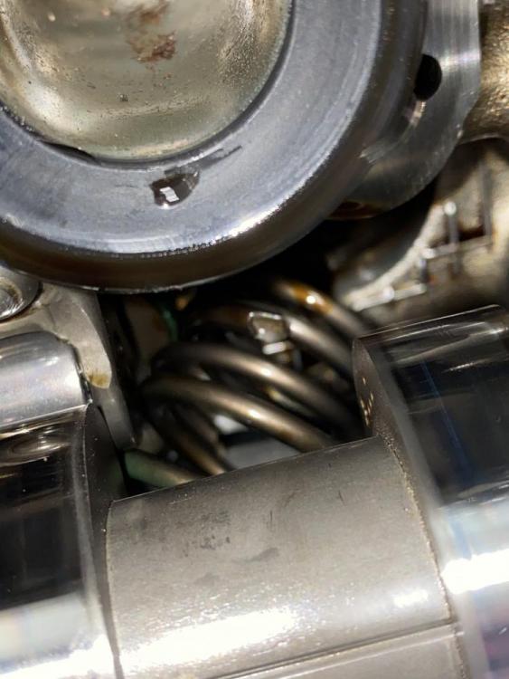

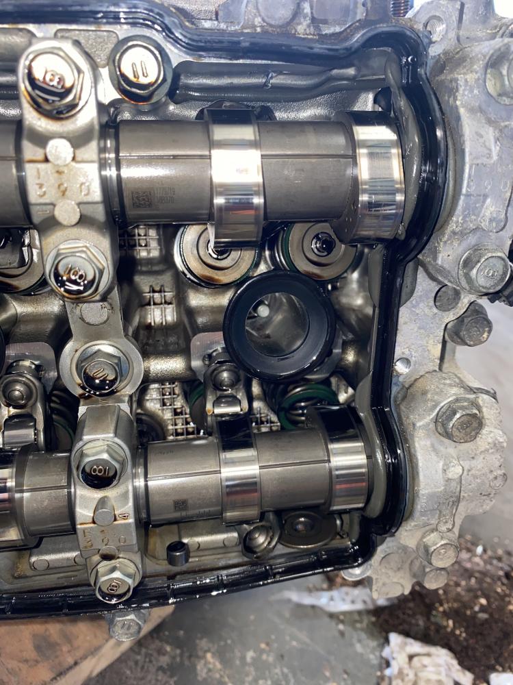

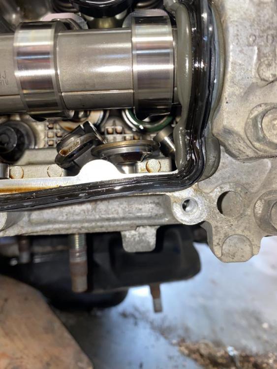

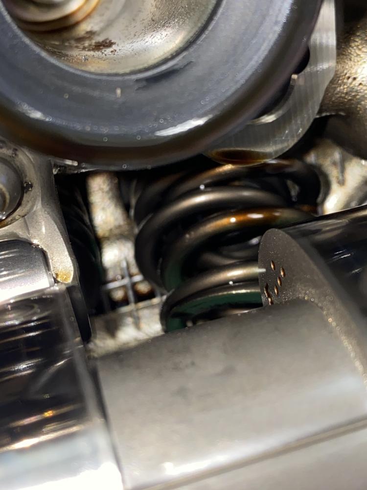

Will be calling them tomorrow. Had another look today and seen this.
Looks like the valve seat has also been destroyed. After Iv spoke to Toyota I will take the block apart and see the full scale of this. That’s if Toyota don’t want the car to look and dismantle themselves.
