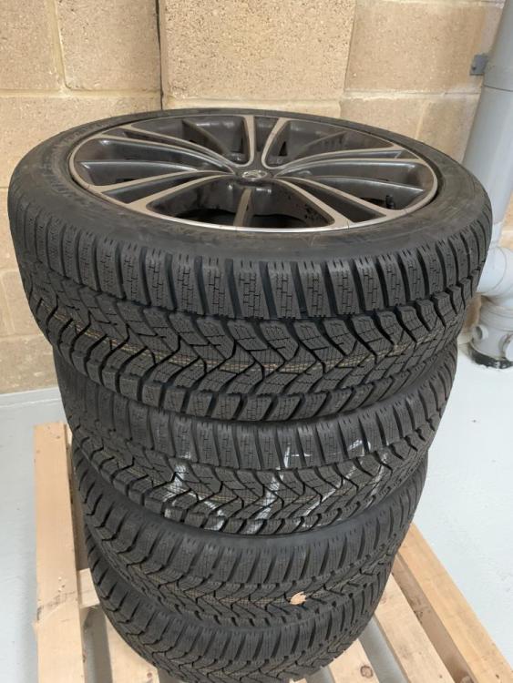

I've taken the plunge and will have a set of Dunlop Winter Sport5 215/45-17 tyres fitted to my OEM rims on Monday.
They'll sit in the warehouse here at work until the time is right to swap 'em over.

hang on with your summers until October/November or so.
I knew that as soon as I bought them summer would return and how right I was. The winters will sit on the pallet in the warehouse for a few weeks yet, I suspect. I do 90% of my driving in the morning before 10am and in the evening after 7pm - when the temp drops to 8C or so at these times of day is when I'll swap. Expecting to have to do that early to mid November.
