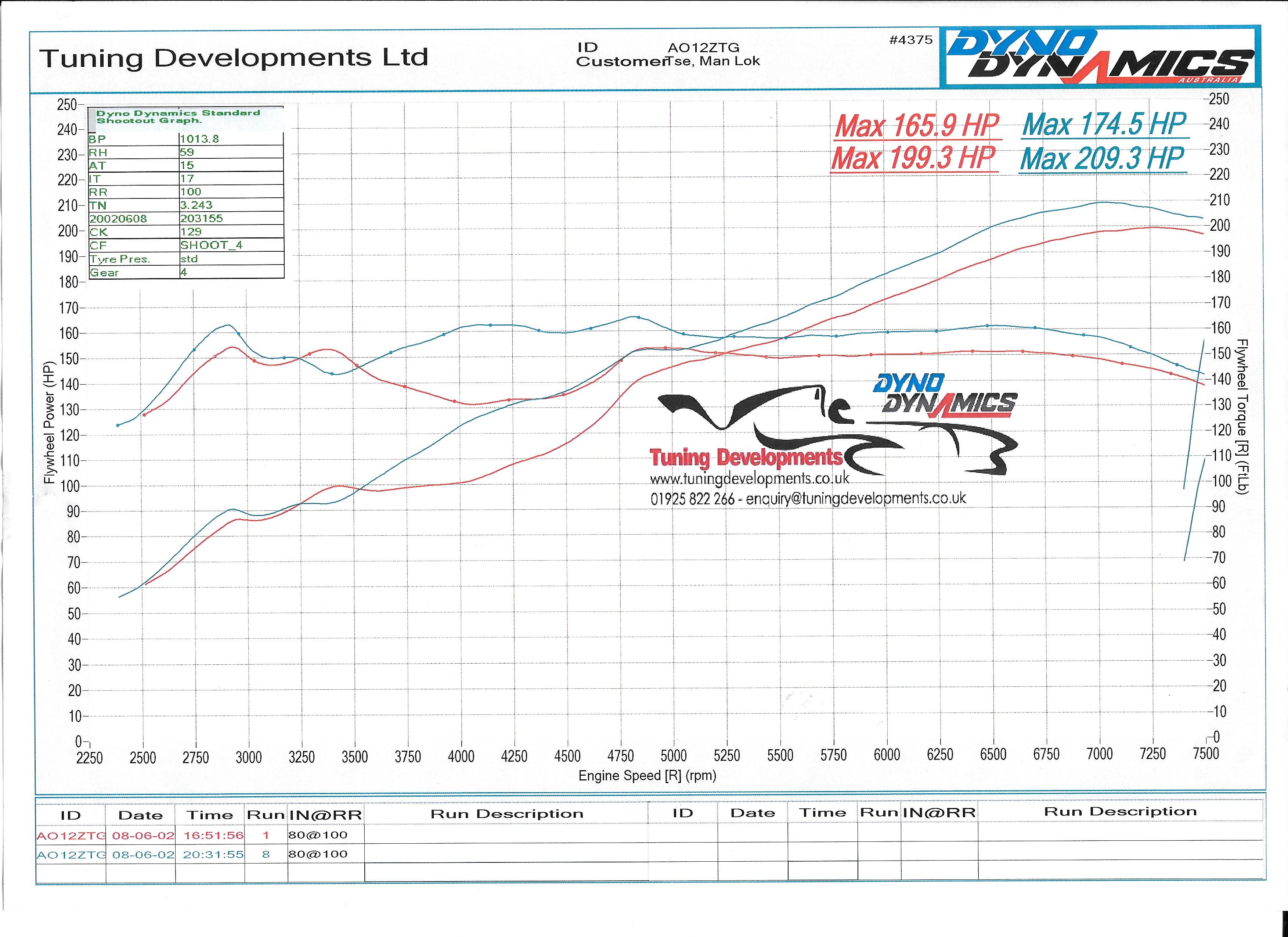

GT MLT 9 Report post Posted April 24, 2018 I'm another one that got converted! Background Been meaning to get this package for a while, and decided to finally bite the bullet convincing myself it's my birthday present to me...from me. After exchanging a couple of emails with @Mike@TD.co.uk, I booked myself in for the NA tuning package (UEL), MTEC Shifter Springs, Powerflex Gearbox Insert and also their intake hose (just wanted to get the noise generator deleted). I had originally wanted to buy the parts and do it all myself at home as I love tinkering, but it was hard to justify with the cost of the overall package being so good. The Day So I booked some time off work, and headed up to Warrington bright and early to get there for around 9am (dragging my dad out with me too). After watching Mike and team empty out their workshop of cars (some amazing ones they have in there!), they took my car in and put it on their dyno for the before run: Unfortunately I couldn't watch any of the work go on inside the workshop, but I had a good time chatting to Mike, relaxing in the reception and staring at the turbo & manifold they had in there (next time...). Also for anyone wondering, there's a nice sandwich place called Cafe Ocho nearby for lunch. After food I had a look at Mike's Turbo'd GT86 (again..next time!) and around 2pm I could hear the car on the dyno again for the post-runs... Now, one of my worries was that I had installed a Milltek Secondary Catback Non-Resonated system beforehand, and as it was non-resonated it would make the car unbearably loud for daily driving and track limits (it was only loud on cold starts mainly). Hearing post-install dyno runs and then them setting off for some road testing, did not settle my concerns! Mike handed me the dyno graph and said that for a near enough stock car, it made surprisingly good power, but even so, look at the difference in torque at 3500 to 5000rpm between old and new: I was really looking forward to feel the results! On the Road Once I started to drive out of the estate I was smiling straight away. The car pulled away so smoothly and the torque dip was gone! I straight away noticed the changes the shifter springs and gearbox bush had made, as changing gears felt more positive. The biggest relief though was the noise. Under 3500rpm the car sounded the same as previously, and it's only above this rpm and especially under load, can you hear a very noticeable difference, a raspier tone. Cruising on the M6 back to Walsall, I could happily have a conversation with my dad just as before. I could not be happier! Also when starting the car the next day early in the morning, I did not wake up any neighbors thanks to the cold start being tuned out . Later in the week I met a friend in his turbo'd MX5 in Banbury to do a spirited drive towards Bicester along the back roads I know, and I could feel the difference the upgrades had immediately as you could just power out the corners. The added bonus is that the exhaust sometimes crackles when downshifting, which just made me smile and laugh everytime. On the Track I had booked Snetterton on the same week too (yesterday), again with my friend in the turbo'd MX5, and I was slightly nervous for noise testing. Thankfully I passed at 95Db, but the tester did say it sounds really aggressive when the throttle is let go. Just for a bit of context: Standard Car (Bedford @5500rpm)-82Db (I think) Milltek Non Res (Bedford @5000rpm)- 85Db (I was actually disappointed with this one!) TD NA Package + Milltek Non-Res (Snetterton @5000rpm)- 95Db It was a bit difficult to judge the upgrades on track, as this was my first time at Snetterton (and only my 3rd ever track day), but what I definitely did notice was coming out of Montreal in 2nd gear, the car pulled really nicely, which I know the old set up would not have done. Surprisingly though I was miss-shifting a bit, but I put that down to driver error more than anything! Power wise I think I'm done. The next upgrades will be suspension, wheels and tyres, and just more track time. I've done a short noise comparison video of old vs new set up (please don't criticise me too much on my driving! Still learning!): https://www.youtube.com/watch?v=8T-vkAkReas Conclusion As you can probably tell, I am over the moon with the NA package, and it has transformed the car for such good value. TD have been excellent too, responding to emails quickly and answering all the questions I had! Thanks guys! 5 1 x14JSx, Mike@TD.co.uk, spikyone and 3 others reacted to this Share this post Link to post Share on other sites
MartinT 514 Report post Posted April 24, 2018 So pleased to hear of another NA package success. The torque curve belies the improvement in real-world driving, which is excellent. It's always going to be a revvy engine rather than a torquey one, but now the flexibility to make serious progress is there and it makes all the difference. I'm still on the stock exhaust, which is fine for my needs. After having a very loud Honda, it seems quiet. I'd like a bit more UEL burble but I'll leave things be for the moment. Share this post Link to post Share on other sites
KevinA 695 Report post Posted April 24, 2018 Nice review and pretty much what we all say about this package, makes the car much more fun to drive and delivers the smiles per mile ratio we want If straight line performance is what you want then other cars can provide this out of the box, but the 86 is a drivers car for sure, if like me you get to a point where you have exploited the chassis and grip to it's limit then you can add power but there is so much to be had before this. The guys at TD are easy to work with and know what they are doing [ also bloody decent blokes too ] so best option IMO. Enjoy the car and meeting folks from here at events. Share this post Link to post Share on other sites
