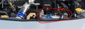

rob275 1817 Report post Posted January 11, 2017 It will be interesting to see what power this puts out! Probably not as much as we would all hope mind you. 4 Kal, Ztox, AJ124 and 1 other reacted to this Share this post Link to post Share on other sites
TTR 509 Report post Posted January 11, 2017 Open ITB's. Dat induction noise 1 Tareim reacted to this Share this post Link to post Share on other sites
Rich196 103 Report post Posted January 11, 2017 does that not have some form of charge tucked in there? Share this post Link to post Share on other sites
Kodename47 446 Report post Posted January 11, 2017 44 minutes ago, Rich196 said: does that not have some form of charge tucked in there? I agree, looks like a turbo. I see a GReddy sticker. Share this post Link to post Share on other sites
Varelco 211 Report post Posted January 11, 2017 It is turbo you can see the compressor housing in the photo. Share this post Link to post Share on other sites
Tareim 343 Report post Posted January 11, 2017 can confirm, turbo spotted which is a shame as it would be nice to know what improvements there could've been with ITB's on n/a Share this post Link to post Share on other sites
rob275 1817 Report post Posted January 11, 2017 He's developing it on N/A also. It's developed by Greddy primarily for N/A. Though unsure if N/A development is done and maybe they are testing with F/I now? cba to investigate Share this post Link to post Share on other sites
Kodename47 446 Report post Posted January 11, 2017 18 minutes ago, Tareim said: can confirm, turbo spotted which is a shame as it would be nice to know what improvements there could've been with ITB's on n/a Folllow the rest of this thread: http://www.ft86club.com/forums/showthread.php?t=63901&page=35 Celek's ITB'd 2.3 (I think) NA engine build due for completion early this year. The problem with ITBs are that getting the stock ECU is not built to run Alpha-N type fueling, I would guess that the GReddy is going to be running a Motec. I have an idea of how you could implement ITB fueling with ECUtek, not sure whether it would actually run though and would need a lot of time mapping. Share this post Link to post Share on other sites
