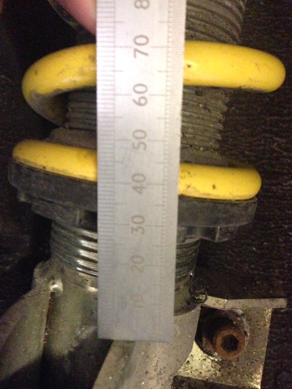

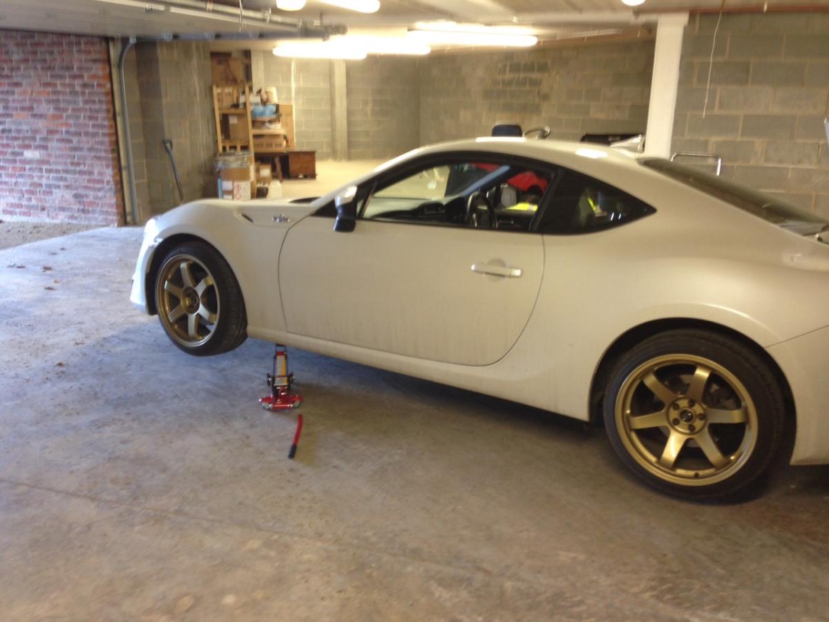

adamj29 133 Report post Posted March 27, 2015 Surprisingly easy job raising the coilovers. I'm a novice when it comes to anything mechanical, so I was fearing this job. But to be honest it was relevantly easy... I have the ST XTA coilovers, every make must be different I assume, but these only have the one collar, it was a simple case of loosening the lock fixing on the collar with the key tool given and twisting the collar to the required height (and locking collar back again). The car was so low, I had to drive it onto about 50mm thick wooden planks, to be able to get the jack under it, and then the jack stands.. I measured from the base of the thread to the top of the collar, It work out well as they seemed spot on, apart from one which was 1mm out!! New ride height is a lot more sensible, as I can now park my car on drive with ease. Even if I was driving down a lane with a lot of camber on it, I would catch the underneath of it. I guess I will have to get the wheels aligned now... A few friends are driving down to the Nurbergring next month and my greatest fear was not being able to get the car on the ferry, that problem should be solved now. I'm still unsure whether to take the car onto the track as It's my pride and joy, and if I did end up damaging it, it would turn me into an emotional wreck, I'd end up spending days sobbing into a bucket of Ben and Jerrys... Ordered a rear roof spoiler / visor from Tarmac sport and hoping to order a carbon fibre rear spoiler shortly. I'd love to go down the forced induction route, but I can't justify the expense along with the fact that it may invalidate the warranty?.. But still, I could do with just a little more power!! Tempted by the lightweight pulley kit, but not sure if that will improve the performance?? 1 Keethos reacted to this Share this post Link to post Share on other sites

Lauren 2259 Report post Posted March 28, 2015 When you set the ride height, it's better to measure from the sills to a flat floor. But, as long it all measures okay, that's fine. James the lightweight pulley kits do not seem to have a harmonic damper. For the negligible gian (and it will negligible) it's not worth the risk. 1 adamj29 reacted to this Share this post Link to post Share on other sites

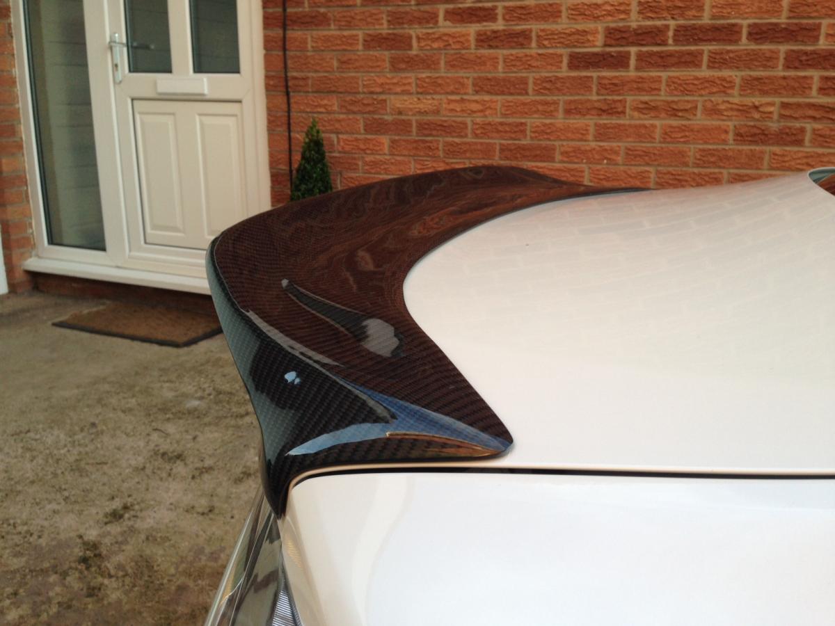

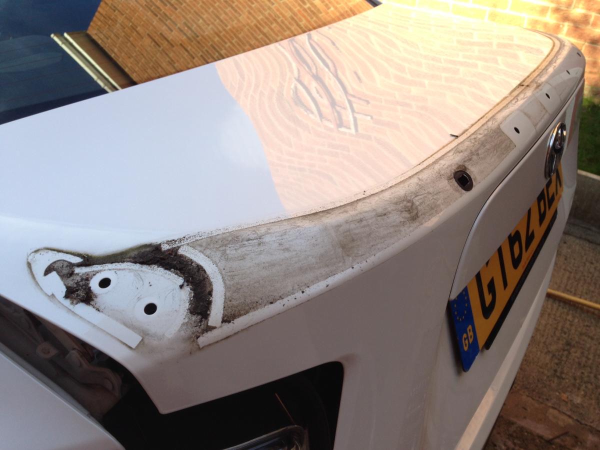

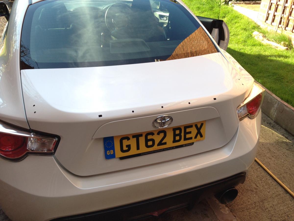

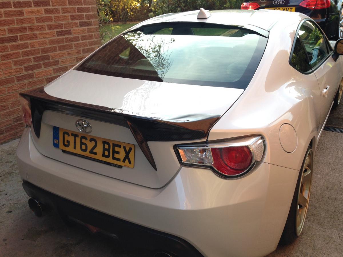

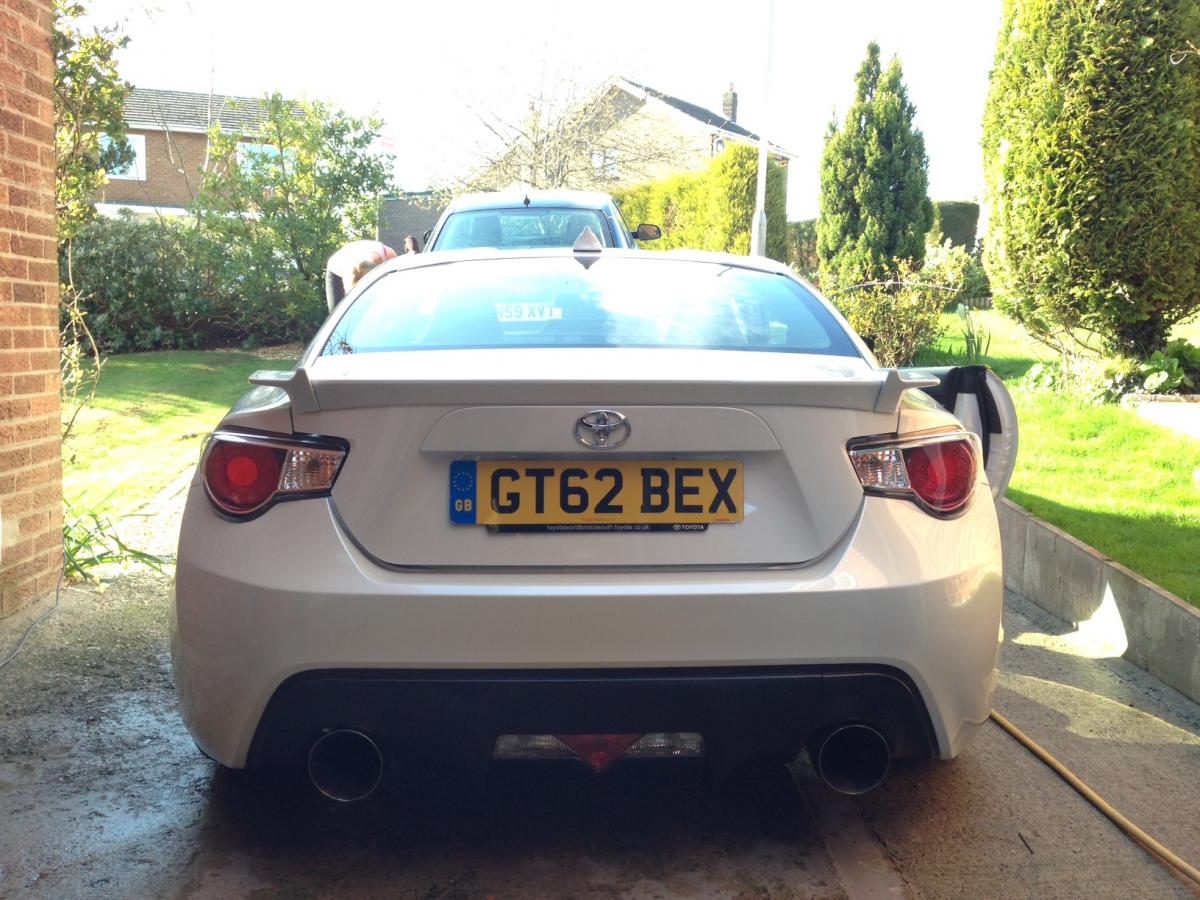

adamj29 133 Report post Posted April 7, 2015 Had delivery of my new spoiler today, carbon fibre Eurolinea Spoiler. (Thanks to Kevin for the help). Also had a read window visor spoiler that needed fitting, so skipped work early and got to work. OEM Spoiler Amazing the dirt that collects under the spoiler! Cleaned up New Eurolinea Carbon Fibre spoiler Fitted: I'm really happy with both items. Easy to install as well, ish. Apart from loosing damn fixings in the inside of the boot lid (that was a fun task to carry out... the neighbours looked at me weirdly as I was shaking the boot lid like a madman) May need to add a few more carbon parts to go with it... Will get some decent photos taken soon... 2 Keethos and JamesP1991 reacted to this Share this post Link to post Share on other sites
JamesP1991 222 Report post Posted April 7, 2015 Looks ace fella, carbon on a white car always looks the business! 1 adamj29 reacted to this Share this post Link to post Share on other sites
Keethos 842 Report post Posted April 7, 2015 Awesome, really like that spoiler! I too dropped a bolt into the boot when I removed my spoiler but luckily I had plenty of long strong wires that you get from packaging to tie things down with. 1 adamj29 reacted to this Share this post Link to post Share on other sites
adamj29 133 Report post Posted April 8, 2015 Cheers guys, yea I wasn't sure if I'd like it, but hell I love it. Loots the balls, but I do think I need to invest in some smoked rear lights but on the cheap as funds are getting tight (May put a wanted advert on here to see if anyone has any spare). And definitely black Toyota badges. Haha Keith! Yes its incredibly infuriating dropping the bolts, I gently tapped the boot lid as the car was on a slight hill, and slowly the things shook themselves out.... pain-in-the-arse! Share this post Link to post Share on other sites
JamesP1991 222 Report post Posted April 8, 2015 The aesthetic changes I always hate doing as I think to myself that, that money could be spent on mechanical parts haha! But I think wheels and rear lights/wing is something that polishes the car off I am sure someone will have smoked Valenti lights on the cheap for you! Where did you get the wing from mate? Not seen one about on my travels when looking online. Share this post Link to post Share on other sites

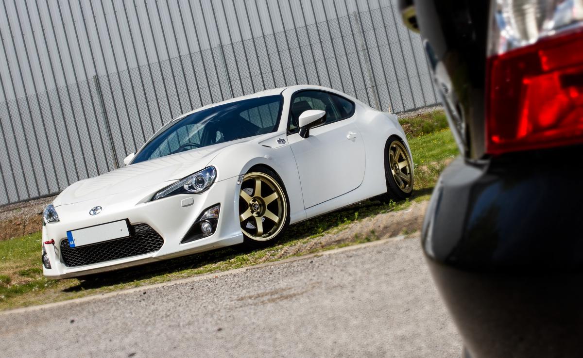

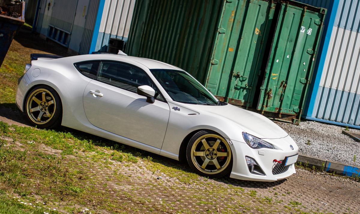

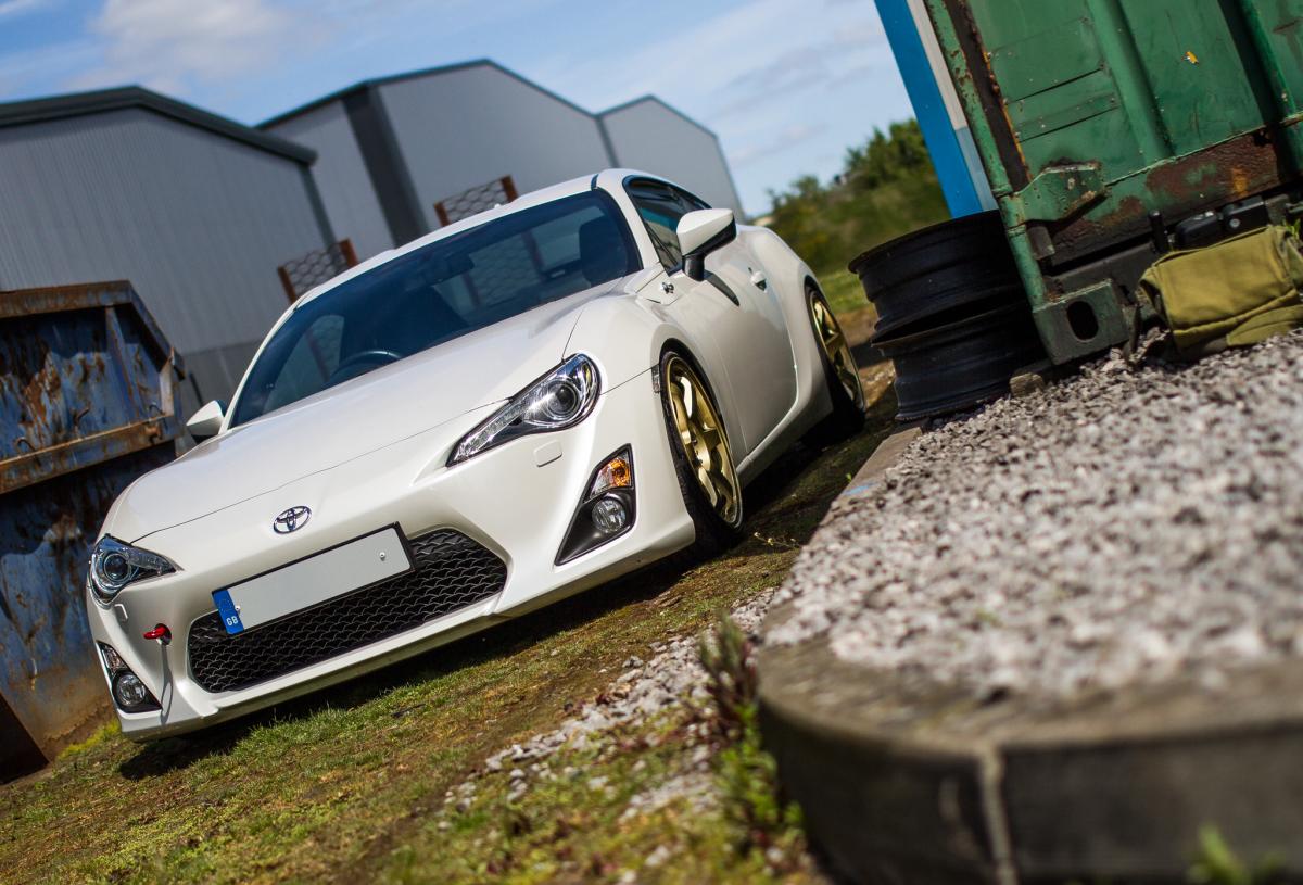

adamj29 133 Report post Posted June 10, 2015 I've had some DBA Performance discs and Hawk pads delivered from Fensport. Had them fitted locally, and had a bit of a photoshoot to celebrate. 5 Tweedbean, Keethos, Lauren and 2 others reacted to this Share this post Link to post Share on other sites
Mark-in-Stoke 488 Report post Posted June 10, 2015 Loving the wheels 1 adamj29 reacted to this Share this post Link to post Share on other sites
JamesP1991 222 Report post Posted June 11, 2015 Looks the dogs danglies! How are you finding the new brakes? Did you just go with the fronts Adam or upgrade all round? 1 adamj29 reacted to this Share this post Link to post Share on other sites
