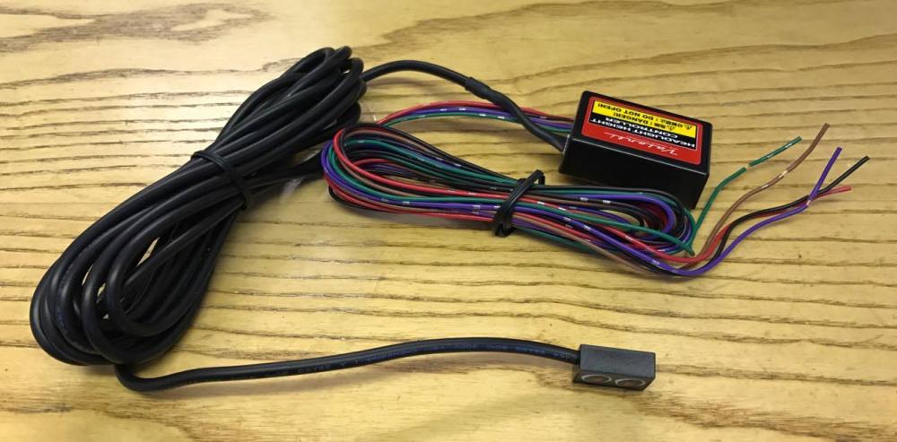

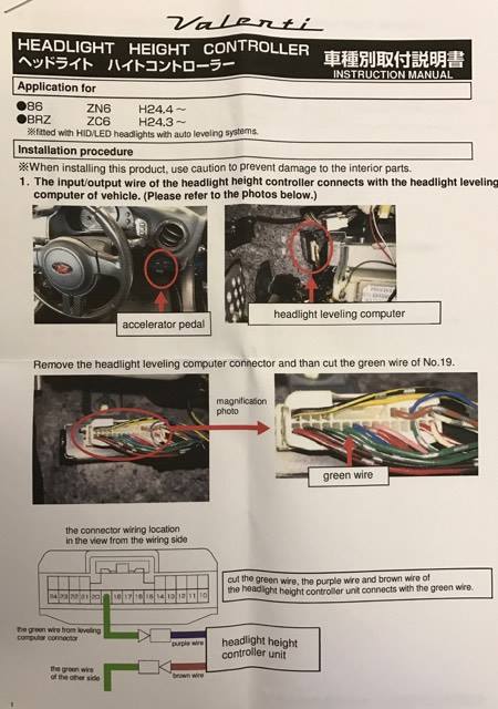

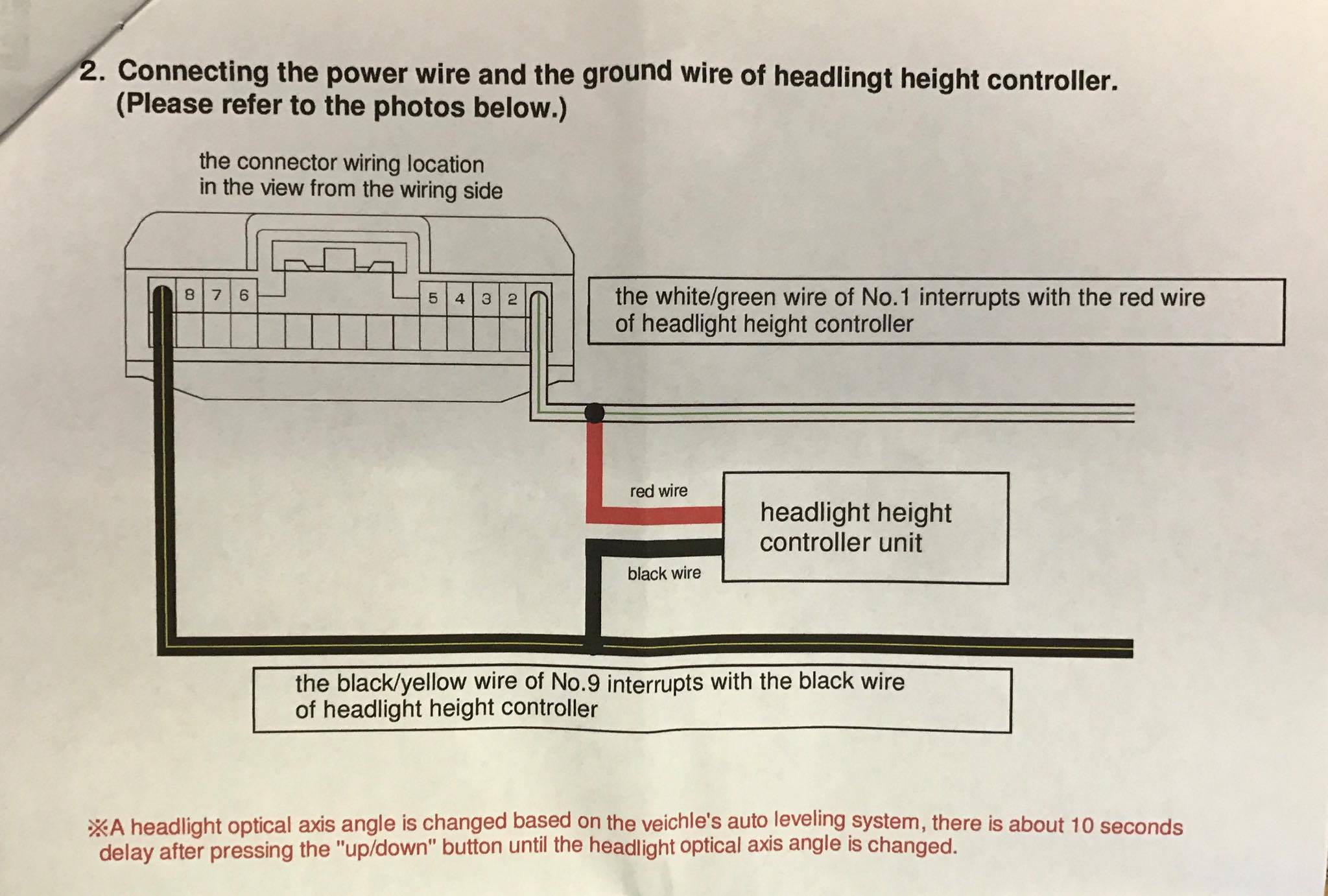

S18 RSG 429 Report post Posted January 26, 2017 Couple of things the nay-sayers perhaps aren't considering. The Cusco (or similar) solution is around £40, this is around double that, which ok, is a big difference, but it's still only £40 more. This solution, however, takes 5 minutes to fit (literally 4 wires), and can be adjusted in 1 second. The leveller bar takes probably 30 minutes to fit if you have the right tools and equipment, and have no issues removing bolts etc. It then probably takes at least 10 minutes to adjust, should you need to. For me and I imagine a few others, this solution would be perfect, as I like to fiddle with suspension setups a fair bit, mostly due to the variety of roads I drive around (I take my car to steelworks and power plants a lot for example). Having the ability to adjust the headlights with the press of a button is easily worth £40 for me, for those reasons among others. Of course, if the dealer can do it for free or cheap via ODB, then that's maybe a reason not to spend £80 on this, but again, that's still massively inconvenient for lots of people. Pics/instructions supplied by @James@Amber 2 Mark-in-Stoke and Hoax reacted to this Share this post Link to post Share on other sites

Mark-in-Stoke 488 Report post Posted January 26, 2017 Neat trick, liking this a lot. Just one question, on the valenti box (5) wires are showing but it looks like the green wire doesn't get used, is this correct? Share this post Link to post Share on other sites
S18 RSG 429 Report post Posted January 26, 2017 Just now, Mark-in-Stoke said: Neat trick, liking this a lot. Just one question, on the valenti box (5) wires are showing but it looks like the green wire doesn't get used, is this correct? Possibly a ground wire? Not 100% sure obviously, but only thing I can think. 1 Mark-in-Stoke reacted to this Share this post Link to post Share on other sites
