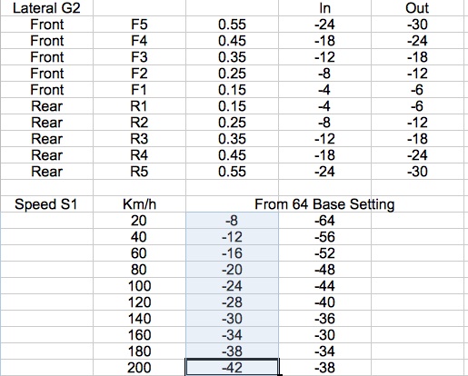

Some new settings I'm trying out. Note this is supposed to be a good all round road setup for general driving with the idea being it's full soft below 20km/h for speed humps and bad surfaces and then it stiffens proportionately. Note that the increases in lateral G are more than G2 stock settings. I haven't messed with longitudinal G, I just use G2 at the moment.
Speed and lateral G have been changed though. Will be interesting to see how it pans out. The idea was for it to be comfortable when not trying that hard and then it stiffens up significantly when you push on and load up the G force.
We'll see.
NB: now corrected to show cumulative speed increase to stiffness.
