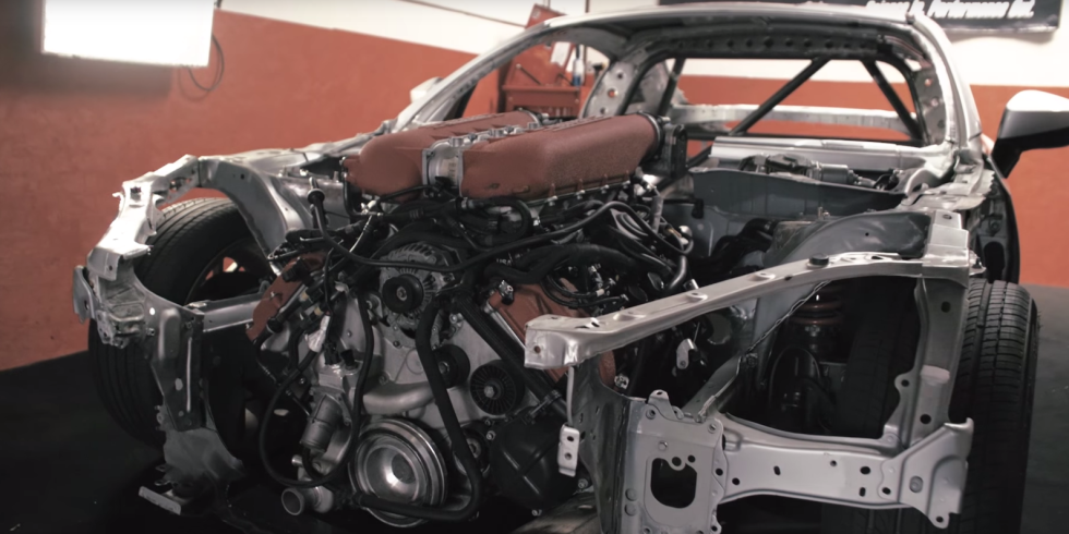

Ade 517 Report post Posted October 14, 2016 He needs to drop in a v10 Share this post Link to post Share on other sites
Minion 132 Report post Posted October 14, 2016 10 minutes ago, Ade said: He needs to drop in a v10 Meh, I'd be happy with this... Share this post Link to post Share on other sites
rob275 1817 Report post Posted October 14, 2016 11 hours ago, Sideways? said: Rob, can you do some more building so we can move on from talk of suspension setup...? (thrilling as it is...) U can haz yo Fred bak bruv, take it!! Sent from my E6553 using Tapatalk I do have a present arriving next week But @Ade it's not a v10. If Jordans car is anything to go by it'd never get done Share this post Link to post Share on other sites
