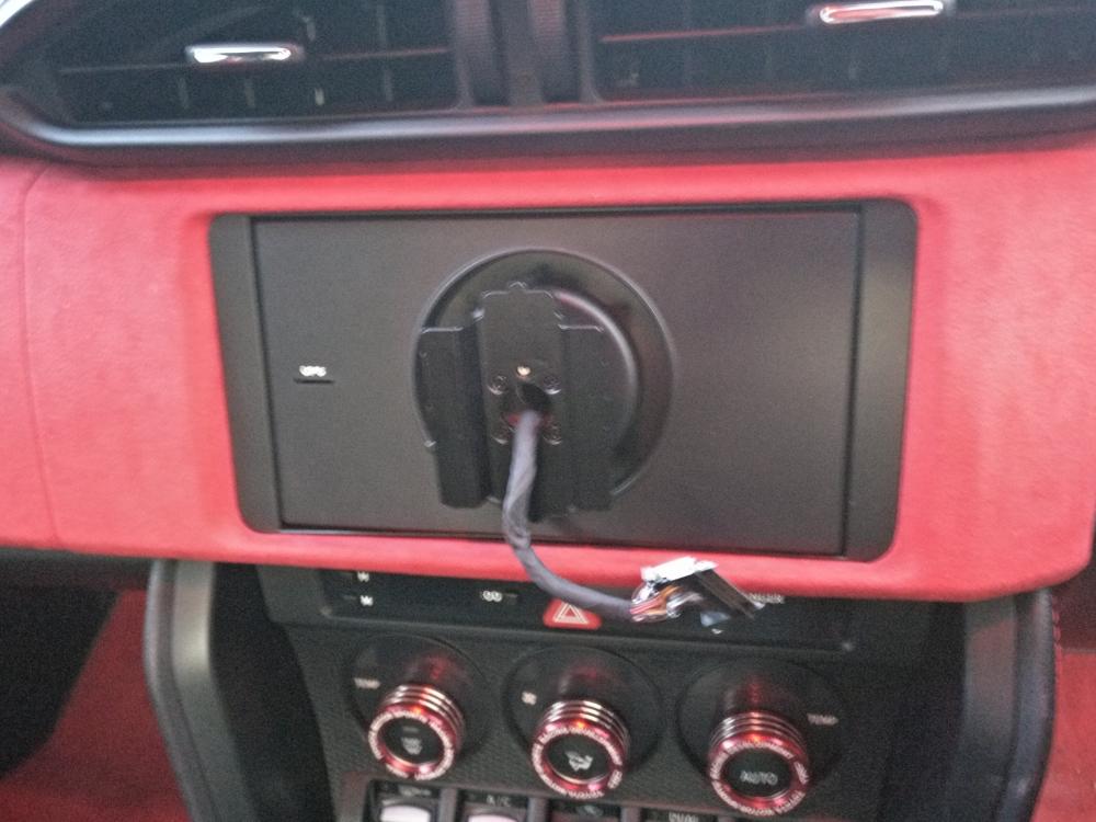

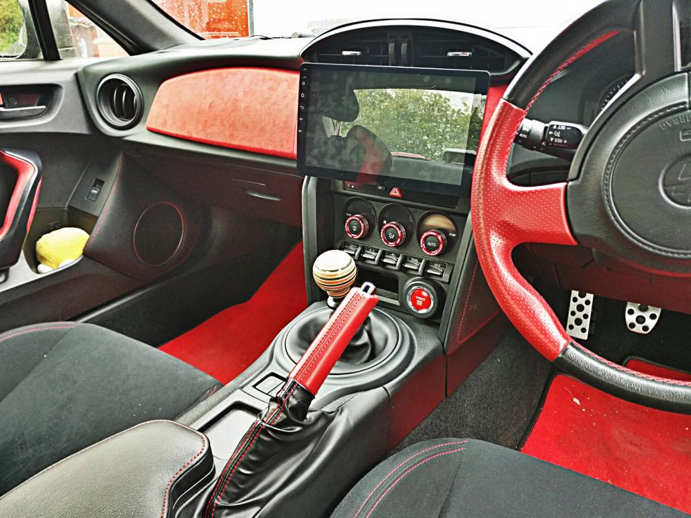

Deacon 1357 Report post Posted August 16, 2019 Got the head unit fitted with help from @Dilan and Ariston from the FB group. Genuinely can't belive the difference in sound quality over oem! 2 MangoNo5 and BRZ-123 reacted to this Share this post Link to post Share on other sites
BRZ-123 174 Report post Posted August 17, 2019 Got the head unit fitted with help from [mention=3006]Dilan[/mention] and Ariston from the FB group. Genuinely can't belive the difference in sound quality over oem!The head unit looks massive. What make and model is it? Is there an audio quality change just with the unit or did you change the speakers or add an amp? Sent from my SM-G970F using Tapatalk Share this post Link to post Share on other sites
Deacon 1357 Report post Posted August 17, 2019 1 hour ago, BRZ-123 said: The head unit looks massive. What make and model is it? Is there an audio quality change just with the unit or did you change the speakers or add an amp? Sent from my SM-G970F using Tapatalk It's an Eonon GA2178. The display is 10.1". I already had the focal speaker upgrade which made a difference over Oem but this has made an even bigger difference. As a cheap upgrade package the focals and this head unit seem very good. Share this post Link to post Share on other sites
BRZ-123 174 Report post Posted August 17, 2019 1 hour ago, Deacon said: It's an Eonon GA2178. The display is 10.1". I already had the focal speaker upgrade which made a difference over Oem but this has made an even bigger difference. As a cheap upgrade package the focals and this head unit seem very good. Thanks. Looks really good. Makes it look like a Volvo screen, if you just ignore the buttons and knobs! Did you need loads of connectors to get it to work or simply plug and play? Share this post Link to post Share on other sites
Deacon 1357 Report post Posted August 17, 2019 27 minutes ago, BRZ-123 said: Thanks. Looks really good. Makes it look like a Volvo screen, if you just ignore the buttons and knobs! Did you need loads of connectors to get it to work or simply plug and play? Thank you. It needs a wiring loom adaptor, an adaptor to keep the USB working by the stop/start button, an aerial adaptor and I bought a fitting kit of brackets and surround. All in it came out as about £315. With the focal too you're looking at about £450. The stereo also comes with a dash cam and reversing cam that you can plug into it too but I haven't fitted those at the moment. 1 BRZ-123 reacted to this Share this post Link to post Share on other sites
MangoNo5 55 Report post Posted August 18, 2019 This looks great mate. I was thinking of trying to fit the Alpine halo9 or wait for the new Sony xav8000. Your set up gives you a bigger screen and is a 2 din box. The price too can't be knocked. Could you point me in the right direction on where and what adapters exactly you had to get? Share this post Link to post Share on other sites
Deacon 1357 Report post Posted August 18, 2019 51 minutes ago, MangoNo5 said: This looks great mate. I was thinking of trying to fit the Alpine halo9 or wait for the new Sony xav8000. Your set up gives you a bigger screen and is a 2 din box. The price too can't be knocked. Could you point me in the right direction on where and what adapters exactly you had to get? No problem. This is a link to the stereo:- https://www.eonon.com/mobile/Eonon-Android-9-0-Universal-Double-Din-Car-Stereo-with-Quad-Core-Processor-10-1-Inch-Touchscreen-Support-Bluetooth-5-0-Adjustable-Viewing-Angle.html This is the fitting kit including most of the necessary wiring harnesses:- https://www.dynamicsounds.co.uk/toyota-gt-86-car-stereo-double-din-fascia-wiring-loom-antenna-fitting-kit.html?gclid=CjwKCAjw7uPqBRBlEiwAYDsr16Fe9vK3tIa-qqwGBnKxE9gQzqFyN29zMTbLSVDmTHVprkt2EUq1eRoCn48QAvD_BwE This is the harness needed to keep the USB by the start button working:- https://www.ebay.co.uk/itm/Car-Stereo-Factory-USB-Retention-Interface-Cabe-Kit-For-Toyota-GT-86-2012-Onward-/262914884030 1 MangoNo5 reacted to this Share this post Link to post Share on other sites
Deacon 1357 Report post Posted August 18, 2019 One other useful feature of the head unit I found for pre facelift owners is it will display the battery voltage. Handy considering how quickly the 86 batteries seem to like to discharge! Share this post Link to post Share on other sites
MangoNo5 55 Report post Posted August 18, 2019 Thanks for all this info! I'll start shopping. The battery function is a nice function too! Appreciate all the original effort that has gone into finding and setting this unit up. A massive thank you for sharing in detail the end result mate! 1 Deacon reacted to this Share this post Link to post Share on other sites

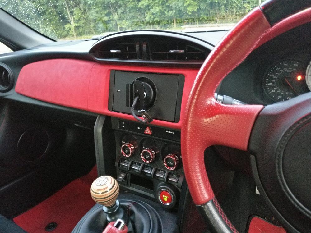

Deacon 1357 Report post Posted August 18, 2019 This is the screen removed in case you have to leave the car somewhere and don't want it on display. 1 BRZ-123 reacted to this Share this post Link to post Share on other sites
MangoNo5 55 Report post Posted August 19, 2019 That's always good to know! It definitely helps reduce temptation in certain neighbourhoods. :) Share this post Link to post Share on other sites
MangoNo5 55 Report post Posted August 19, 2019 All kit ordered, any tips or things I need to watch on the install? 😊 Share this post Link to post Share on other sites
Deacon 1357 Report post Posted August 21, 2019 On 8/19/2019 at 11:53 PM, MangoNo5 said: All kit ordered, any tips or things I need to watch on the install? 😊 Once you've taken all the oem stuff apart and put the wiring harnesses into the new one it's fairly straightforward. There are two plugs that go into the oem stereo that won't plug into anything with this one (think they are to do with the oem optional Nav). I fitted the WiFi antenna and GPS antenna and routed them behind the glove box. The WiFi antenna I fixed on the underside of the top of the glove box and the gps receiver I ran up to the dashboard and fitted it between the vents and the speaker grill against the windscreen. You do need to be super, super careful with the wiring harness that plugs the screen into the stereo base though. I've managed to tweek mine and currently it's not working properly! 1 MangoNo5 reacted to this Share this post Link to post Share on other sites
