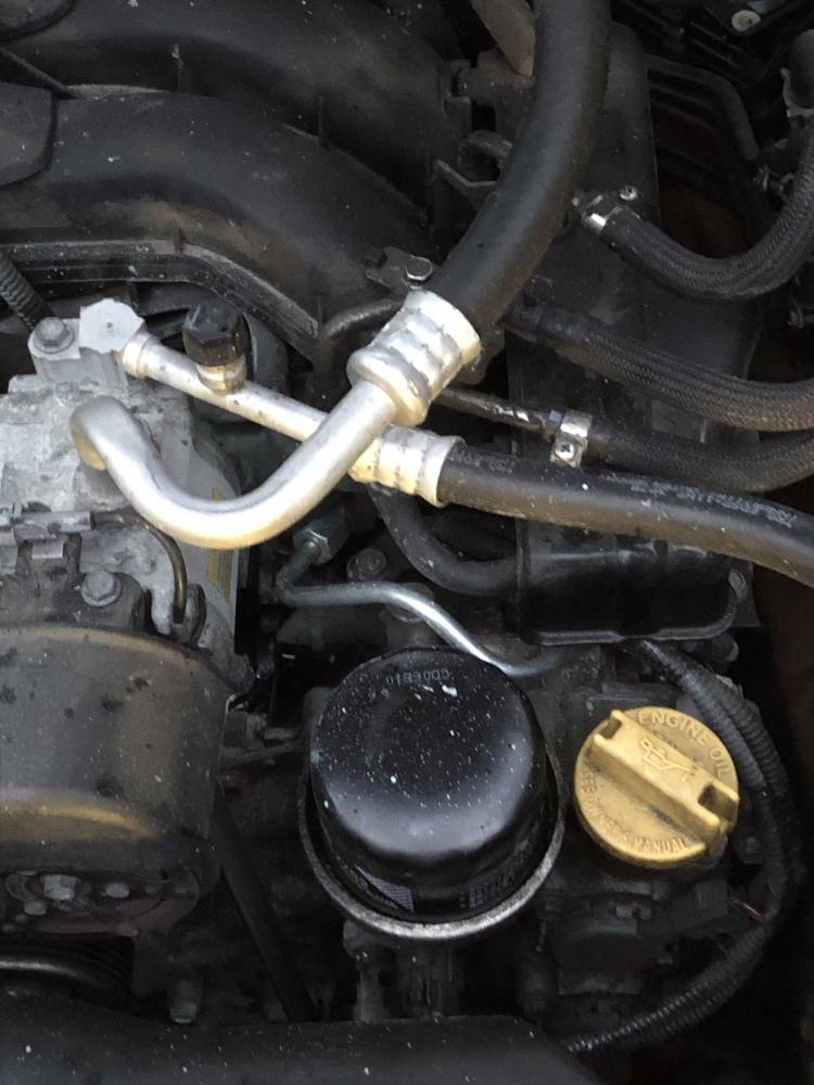

1000 PR 3 Report post Posted September 30, 2020 Thanks. I took a photo but there’s not a lot to show. Its still loosing coolant and getting hot and smoking so I phoned Snows Toyota this afternoon and they said to drop the car off asap but that’s easier said than done as I’ll have to organise how to get home afterwards! I think I’ll have to pause further progress until the weekend and use the Avensis instead:-(. Share this post Link to post Share on other sites
