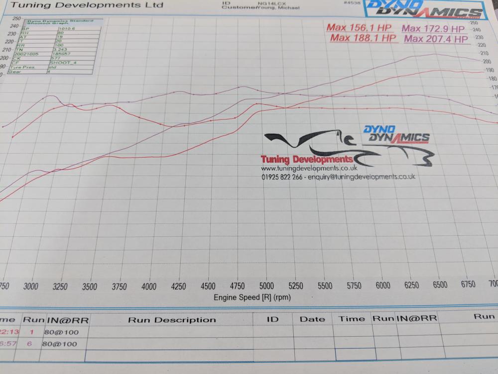

Montatron 15 Report post Posted September 20, 2018 Yeah, I got my car done a few weeks ago now and difference is amazing. I gained 19hp top end and about the same torque but the mid-range gain is incredible. WELL worth the investment! This is my sheet with an UEL manifold. 2 Mike@TD.co.uk and Tom reacted to this Share this post Link to post Share on other sites
