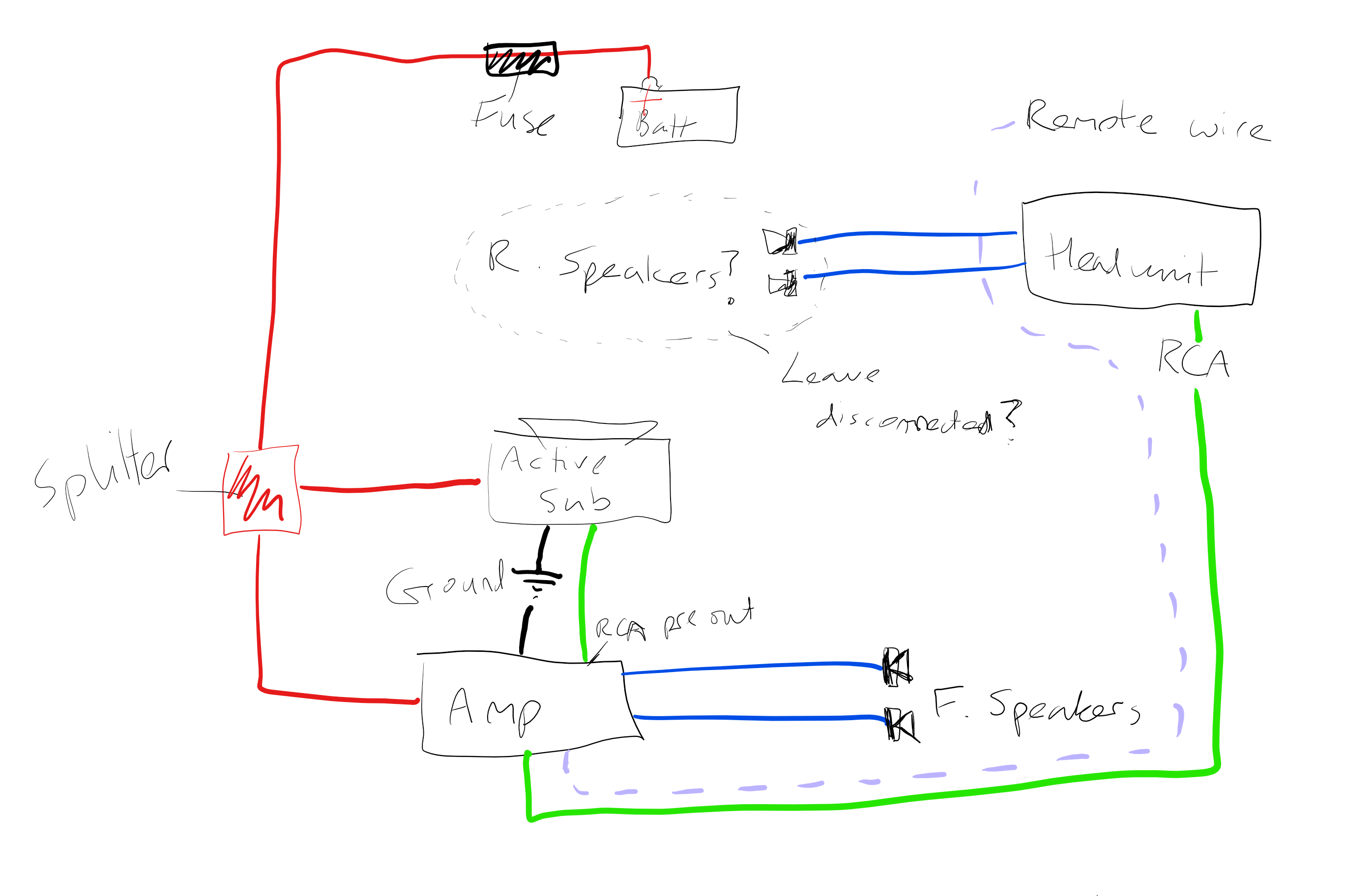

mattt 29 Report post Posted May 20, 2018 OK so I hope everyone can forgive my: (a) terrible sketching (b) my newbieness. I've never installed an amp and subwoofer before but I'm up for the challenge and experience! I'd appreciate some guidance if I've got this wrong anywhere. Cheers! Share this post Link to post Share on other sites
mart86 9 Report post Posted May 22, 2018 On 20/05/2018 at 10:51 PM, mattt said: OK so I hope everyone can forgive my: (a) terrible sketching (b) my newbieness. I've never installed an amp and subwoofer before but I'm up for the challenge and experience! I'd appreciate some guidance if I've got this wrong anywhere. Cheers! Looks good to me. Just remember to size fuse according to cable size. Wouldn't even bother with the rears especially if putting a sub in. Share this post Link to post Share on other sites
