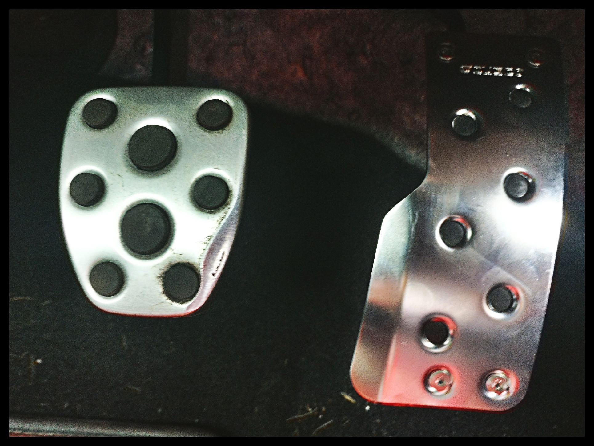

Deacon 1357 Report post Posted October 15, 2017 I've just fitted this which seems to help quite a bit:- Cusco extended accelerator pedal 2 TommyC and Ch1L5t3R reacted to this Share this post Link to post Share on other sites
Ch1L5t3R 9 Report post Posted October 15, 2017 (edited) 6 minutes ago, Deacon said: I've just fitted this which seems to help quite a bit:- Cusco extended accelerator pedal Yeah that would be perfect, just to bring that accelerator up to the same level. How much did that cost if i may ask? and i presume the installation is just a few bolts and pretty easy? *edit* - i just googled it. For 38 quid that will help a lot. I'll get one ordered and get it on obviously i still need hours and hours more practice but this will help a lot thanks! Edited October 15, 2017 by Ch1L5t3R I checked myself Share this post Link to post Share on other sites
Deacon 1357 Report post Posted October 15, 2017 9 minutes ago, Ch1L5t3R said: Yeah that would be perfect, just to bring that accelerator up to the same level. How much did that cost if i may ask? and i presume the installation is just a few bolts and pretty easy? It doesn't actually raise the pedal just brings it closer making it easier to roll your foot over. You can get pedal raisers but I've heard mixed reviews. Installation is pretty easy. They're about £40. 2 Lucas and Ch1L5t3R reacted to this Share this post Link to post Share on other sites

Ch1L5t3R 9 Report post Posted October 15, 2017 37 minutes ago, Deacon said: It doesn't actually raise the pedal just brings it closer making it easier to roll your foot over. You can get pedal raisers but I've heard mixed reviews. Installation is pretty easy. They're about £40. Yeah, in fairness i can reach it, but then not enough to actually compress the pedal. So even just the few MM extra this gives will help, plus i presume this is also slightly wider at the bottom than the stock pedal? this would also help 36 minutes ago, Lauren said: You can certainly use the pedal extender if you are new to heel and toeing. However with practice and experience, I feel that the GT86 with the stock pedals is about the easiest car to heel and toe that there is. But, I have been doing it endlessly for over 15 years now. The key is to do it absolutely all the time and learn how to do it even when you are not braking hard, that's where the finesse comes in, which is what it's all about really. Here's an article I wrote about it, back in 2003: http://www.mr2.net/trackdayqueen/heelandtoe.htm Cheers lauren Yeah i appreciate it all comes down to practice practice practice which i will keep doing on my daily commuting Cheers for the link! 1 Lauren reacted to this Share this post Link to post Share on other sites

Lucas 244 Report post Posted October 16, 2017 @Ch1L5t3R a few people have the extension from us, including Deacon. They are currently out of stock, but I've ordered some, because they sell really fast. They will be coming from Japan at the beginning of November. Current price is £40.85 inc. Next Day Delivery https://www.part-box.com/965766a-cusco-sport-pedal-toyota-gt86-subaru-brz?search=965766A&description=true Share this post Link to post Share on other sites
Minion 132 Report post Posted October 16, 2017 26 minutes ago, Lucas@PartBox said: @Ch1L5t3R a few people have the extension from us, including Deacon. They are currently out of stock, but I've ordered some, because they sell really fast. They will be coming from Japan at the beginning of November. Current price is £40.85 inc. Next Day Delivery https://www.part-box.com/965766a-cusco-sport-pedal-toyota-gt86-subaru-brz?search=965766A&description=true I got one of these from Lucas and they are very very good, I am also a novice but have advanced massively since I got this pedal. 100% worth it even just for the confidence boost! 2 Lucas and SimonB95 reacted to this Share this post Link to post Share on other sites
SimonB95 33 Report post Posted October 16, 2017 2 hours ago, Minion said: I got one of these from Lucas and they are very very good, I am also a novice but have advanced massively since I got this pedal. 100% worth it even just for the confidence boost! I've just installed mine today and drove the car with it about an hour ago. The feel is a lot better than I was expecting. Definitely feels a lot more natural when heel/toe downshifting. Would definitely recommend 1 Lucas reacted to this Share this post Link to post Share on other sites
