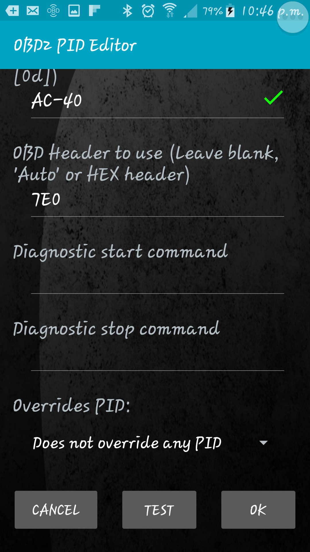

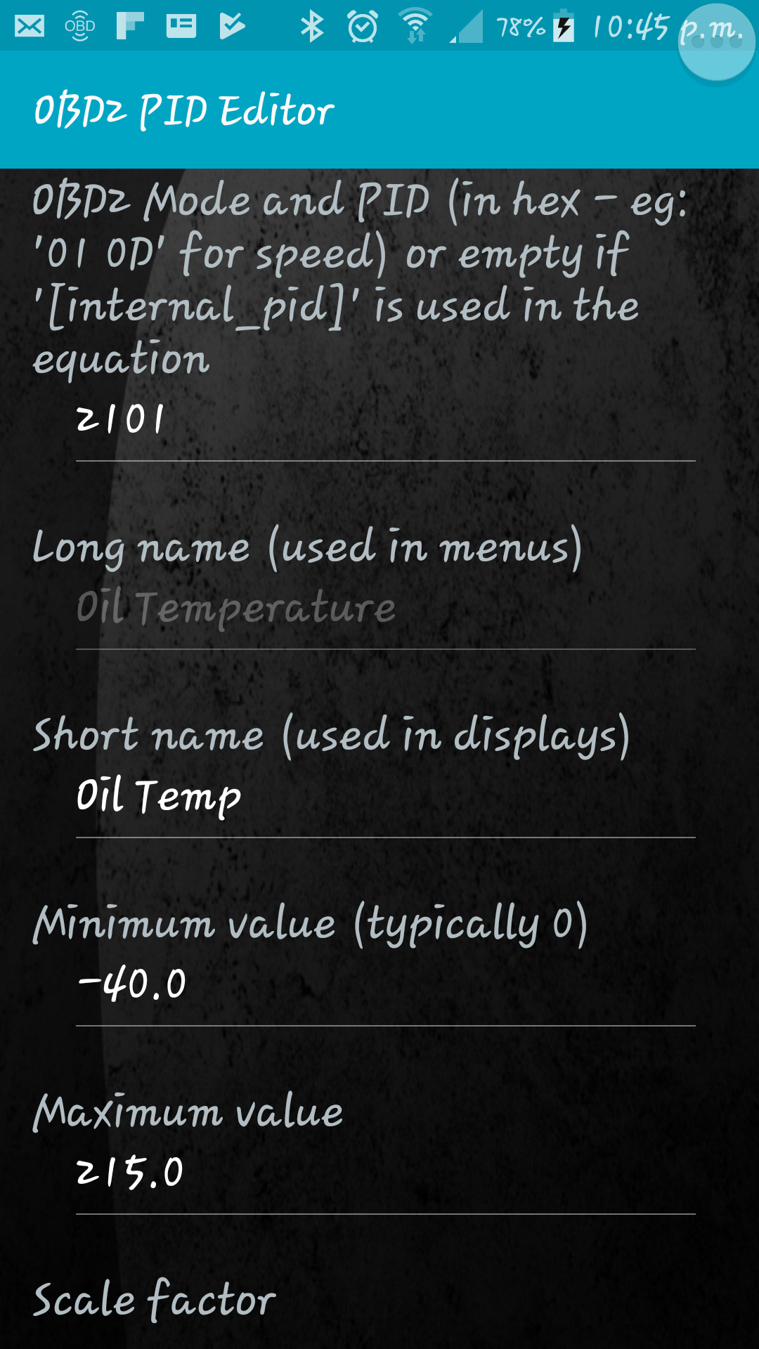

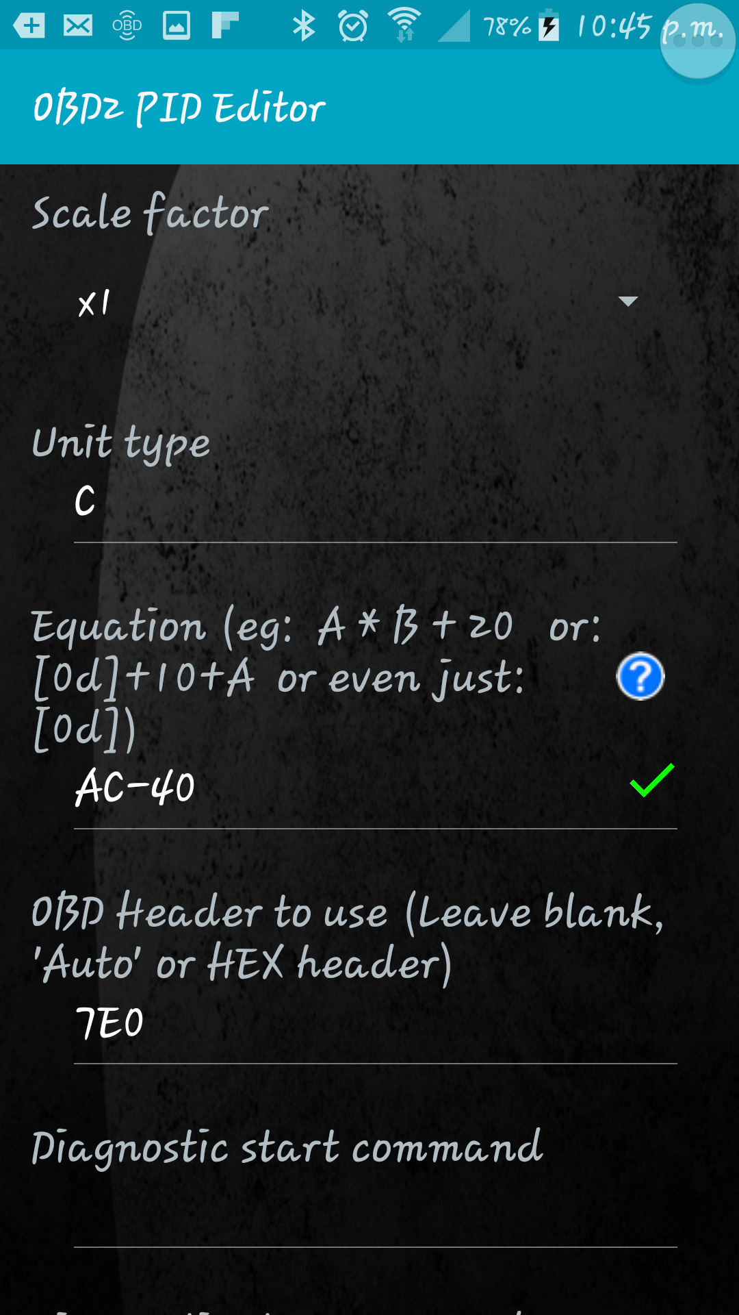

nerdstrike 177 Report post Posted June 11, 2017 Post up the specifics of your "oil temp" PID and I'll compare it with mine. 1 Andrew Smith reacted to this Share this post Link to post Share on other sites
Andrew Smith 156 Report post Posted June 11, 2017 The only other thing I can think of is that the Ecutek remap isn't compatible Share this post Link to post Share on other sites

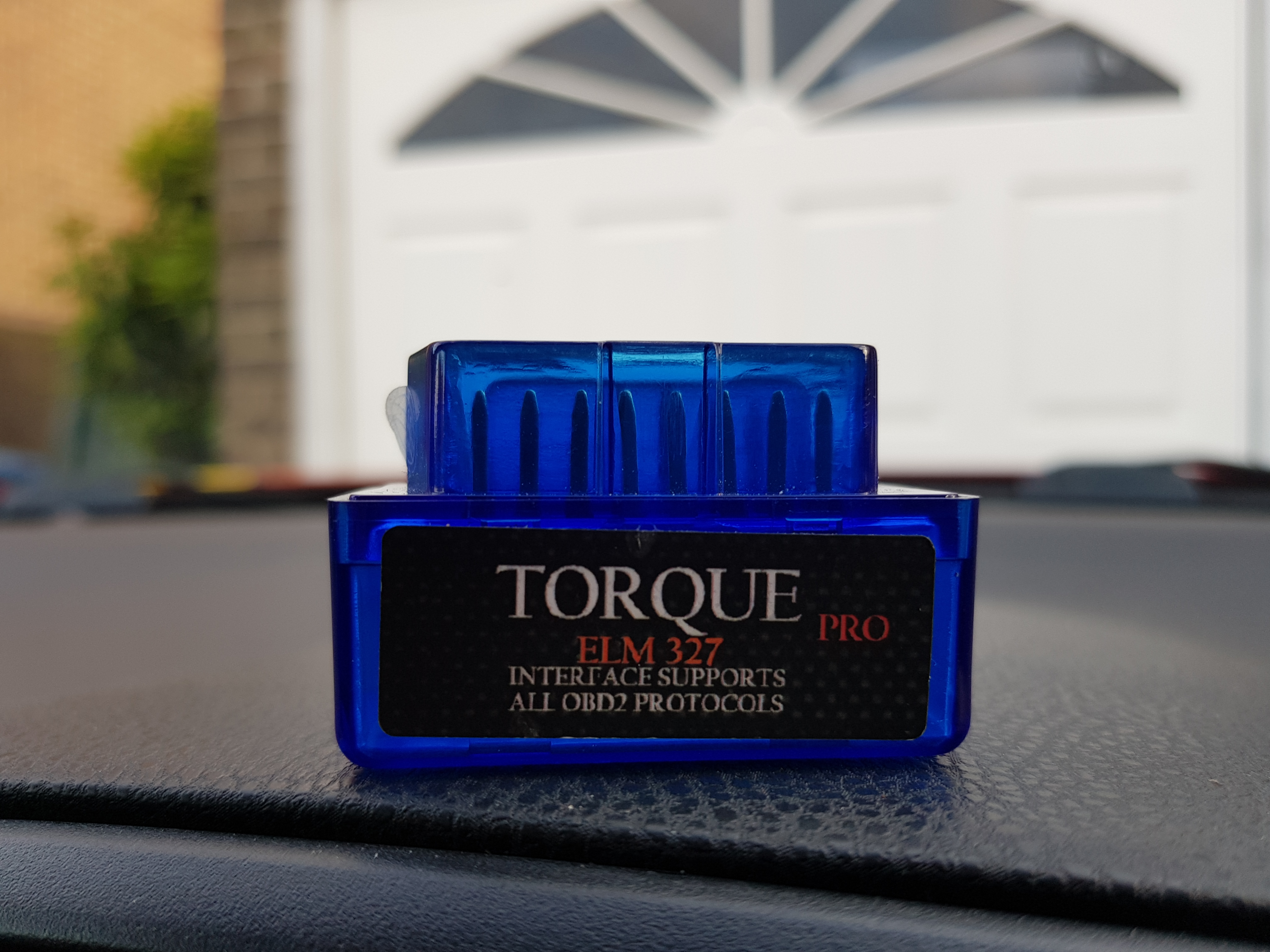

Rich 378 Report post Posted June 12, 2017 9 hours ago, Andrew Smith said: That is good to know Rich, mine cost me about 8 beer tokens so it wasnt a great deal of money. I believe I have my settings right so perhaps I should pry my wallet open a bit further My cheap one cost £3.75 and looked like this: My slightly more expensive one was £9 and looked like this: Apparently the larger ones tend to be better. 1 Andrew Smith reacted to this Share this post Link to post Share on other sites
nerdstrike 177 Report post Posted June 12, 2017 @Andrew Smith The only difference between your settings and mine are that I didn't put a unit on the reading (that you have as "C"). I don't think it should matter, so perhaps your beer-tastic dongle isn't taking instructions. 1 Andrew Smith reacted to this Share this post Link to post Share on other sites

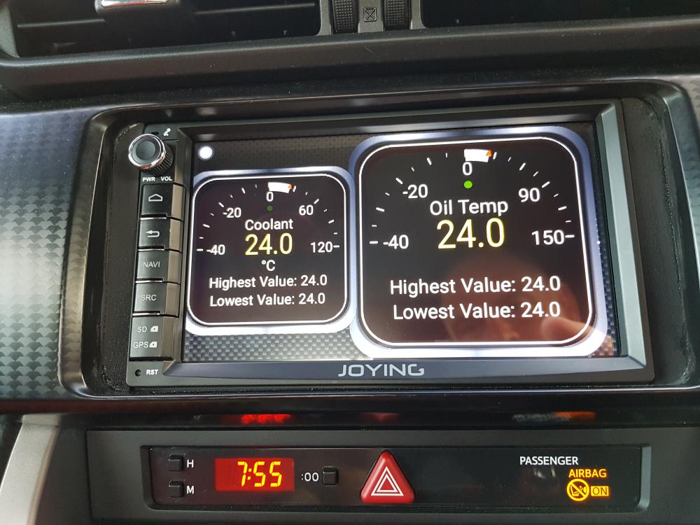

KevinA 676 Report post Posted June 13, 2017 This what I use, works great engine was cold just on the drive ambient readings. 1 Gringosteve reacted to this Share this post Link to post Share on other sites

Andrew Smith 156 Report post Posted June 16, 2017 1 hour ago, don said: I've literally just bought one also. Tried to find the option for oil temp, but i couldn't find it. Not sure if you have to buy additional plugins? I have got mine working this morning, no need for a plugin. Set up a custom PID using the settings I posted near the top of this page with the exception of the long and short name, call it someting you will recognise. I called mine 'Andys Oil Temp' Go to realtime information and select the guage that appeals to you and then from the menu that will appear, select your custom PID. All being well you should have a working oil guage Share this post Link to post Share on other sites
Rich 378 Report post Posted June 16, 2017 You need to not call it "Oil Temperature" I think as there's already a sensor for this using the same name. Share this post Link to post Share on other sites
Andrew Smith 156 Report post Posted June 16, 2017 11 minutes ago, Rich said: You need to not call it "Oil Temperature" I think as there's already a sensor for this using the same name. Absolutely, this is where I went wrong. Share this post Link to post Share on other sites
