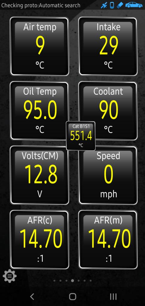

alfredo 1 Report post Posted June 9, 2019 Thanks for all your hints guys! I also bought the Bluetooth OBD2-Code-Reader ELM 327 as others in this forum did. Then I've set the custom PID asOBD2 Mode and PID: 2101Minimum Value: -40Maximum Value: 215 (this is just the maximum that this location can support, which does not mean the sensor can read that high)Scale factor: x1Unit type: CEquation: AC-40 OBD Header: Auto My problem is that the Oil Temperature then only shows up when I initially start the App (while being connected to the Bluetooth OBD2 reader). After like 10seconds the value disappears and does not return until I restart the phone. Anyone know this issue? (I use the latest android on Samsung S8 and the latest Torque Pro App Version). 1 DuncanM reacted to this Share this post Link to post Share on other sites
Trifal 0 Report post Posted October 30, 2020 On 6/9/2019 at 6:49 PM, alfredo said: Thanks for all your hints guys! I also bought the Bluetooth OBD2-Code-Reader ELM 327 as others in this forum did. Then I've set the custom PID asOBD2 Mode and PID: 2101Minimum Value: -40Maximum Value: 215 (this is just the maximum that this location can support, which does not mean the sensor can read that high)Scale factor: x1Unit type: CEquation: AC-40 OBD Header: Auto My problem is that the Oil Temperature then only shows up when I initially start the App (while being connected to the Bluetooth OBD2 reader). After like 10seconds the value disappears and does not return until I restart the phone. Anyone know this issue? (I use the latest android on Samsung S8 and the latest Torque Pro App Version). Hello, I am facing exactly the same issue... were you able to solve it somehow? Share this post Link to post Share on other sites
MartinT 514 Report post Posted October 30, 2020 If you have a facelift model, you get an oil temp display Share this post Link to post Share on other sites
BRZ-123 174 Report post Posted October 30, 2020 All this PID tech confuses the life out of me. Click and hold for long and you get so many options to readily use. Why do all this in a complicated way? @martin T a bit of torque fun for us poor cousins not having the latest tech. Sent from my SM-G970F using Tapatalk Share this post Link to post Share on other sites
Trifal 0 Report post Posted October 30, 2020 Problem is, that I have a pre-facelift model so no OEM oil temp and for the early models (mine is 2013) they used a different PID (2101 instead of 015C..) which is not supported by the apps as standard.. that's why I need a workaround with torque... and it is actually working, but I don't understand, that why only for some seconds... Share this post Link to post Share on other sites
BRZ-123 174 Report post Posted October 30, 2020 Problem is, that I have a pre-facelift model so no OEM oil temp and for the early models (mine is 2013) they used a different PID (2101 instead of 015C..) which is not supported by the apps as standard.. that's why I need a workaround with torque... and it is actually working, but I don't understand, that why only for some seconds... Mine is a 2014, so is mine 015C then as I don't need these funny workarounds. Sent from my SM-G970F using Tapatalk Share this post Link to post Share on other sites
