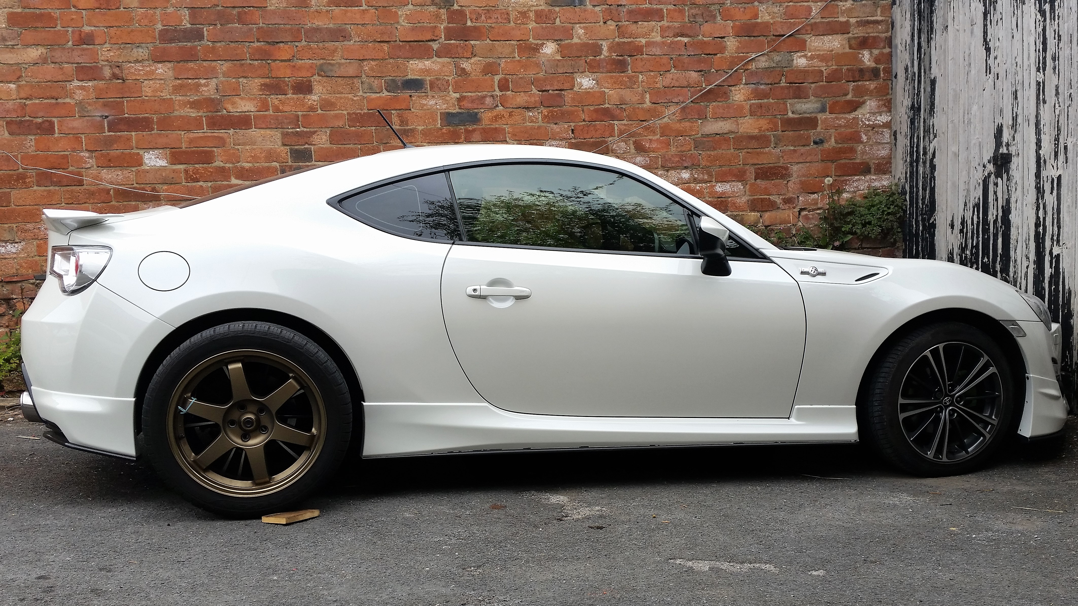

Andrew Smith 156 Report post Posted May 9, 2017 I managed to bag these at the weekend, Volk TE37 17x7.5 et48 with Pirelli Dragons (I have no idea) showing a very good amount of tread. I have ordered the wheel nuts but I am struggling to find spigot rings to fit. I believe with my inaccurate measuring stick that the bore on these wheels are 65.1mm. Can anybody recommend a supplier and brand of ring? I know the offset isn't great but will sort that out at a later date. Many thanks to @Lauren for guiding me thought this whole Rays thing. 2 Keethos and Lowe reacted to this Share this post Link to post Share on other sites
bassett 48 Report post Posted May 9, 2017 Our toyotas are 56.1. Is the centre bore stamped on the wheel or do you know the car it came off to double check the cb size. I got 57.1mn to 56.1mm spigot rings from ebay and seems to be fine if not call wheelbase/rimstyle or the likes as they can probably get some. 1 Andrew Smith reacted to this Share this post Link to post Share on other sites

jevvy 40 Report post Posted May 9, 2017 I just got some ce28s and I purchased thee http://www.ebay.co.uk/itm/292027329068?_trksid=p2057872.m2749.l2649&ssPageName=STRK%3AMEBIDX%3AIT It turned out the centre bore was 65mm not 65.1 and i messaged the guy and he exchanged them for 2£ and was really lovely. If you message him he can make any size for 12.50 I think and youll likely need 56.1 to 65mm not 65.1 the tenth of a mm will make it not fit at all as i found out and i bet yours are the same. If you buy the rays ones they are like 30£ plus and these will do fine! mine were well snug but not too snug! 1 Andrew Smith reacted to this Share this post Link to post Share on other sites
jevvy 40 Report post Posted May 9, 2017 oh also if you buy 25mm bolt on spacers front and rear your wheels will be perfectly flush with the arches btw : ) 1 Andrew Smith reacted to this Share this post Link to post Share on other sites
Andrew Smith 156 Report post Posted May 9, 2017 2 hours ago, bassett said: Our toyotas are 56.1. Is the centre bore stamped on the wheel or do you know the car it came off to double check the cb size. I got 57.1mn to 56.1mm spigot rings from ebay and seems to be fine if not call wheelbase/rimstyle or the likes as they can probably get some. There is no bore stamped on the wheel and they came off an Impreza (56.1 I believe) 1 hour ago, DanJ said: Demon Tweeks sell aluminium spigot rings as well if you want them quicker http://www.demon-tweeks.co.uk/performance/wheel-spacers-and-pcd-adaptors/nuts-for-wheels-alloy-spigot-rings I looked here but they are only listing 73.1 in the drop down menu 1 hour ago, Mike said: Damnit, where'd you find the wheels? fleabay Mike, although I ended up sealing the deal outside of the auction. Although the auction price was a bit steep I am surprised that no one put a bid in 13 minutes ago, jevvy said: I just got some ce28s and I purchased thee http://www.ebay.co.uk/itm/292027329068?_trksid=p2057872.m2749.l2649&ssPageName=STRK%3AMEBIDX%3AIT It turned out the centre bore was 65mm not 65.1 and i messaged the guy and he exchanged them for 2£ and was really lovely. If you message him he can make any size for 12.50 I think and youll likely need 56.1 to 65mm not 65.1 the tenth of a mm will make it not fit at all as i found out and i bet yours are the same. If you buy the rays ones they are like 30£ plus and these will do fine! mine were well snug but not too snug! I have come to the same conclusion, they are 65mm and have found and ordered Rays hub rings https://www.part-box.com/rays73x1x66.1-rays-hub-ring Just had confirmation they are shipping tomorrow. Thanks for the spacer info, when I got them fitted I will have a measure up and see where I want them to be, probably just inside the arches for me. 2 Mike and Lauren reacted to this Share this post Link to post Share on other sites

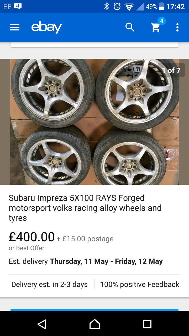

Neal 111 Report post Posted May 9, 2017 I've found these on eBay been watching them for a while just can't keep funds in the bank long enough to afford them (bloody family and friends all having birthdays). Maybe of use to someone else as far as I know them fit. Share this post Link to post Share on other sites

Lauren 2259 Report post Posted May 9, 2017 Those wheels are going to look fab when they're on. Well done on getting them. I'm glad it worked out in the end. You'll want to lower it after they're fitted, I'll bet. 1 Andrew Smith reacted to this Share this post Link to post Share on other sites
