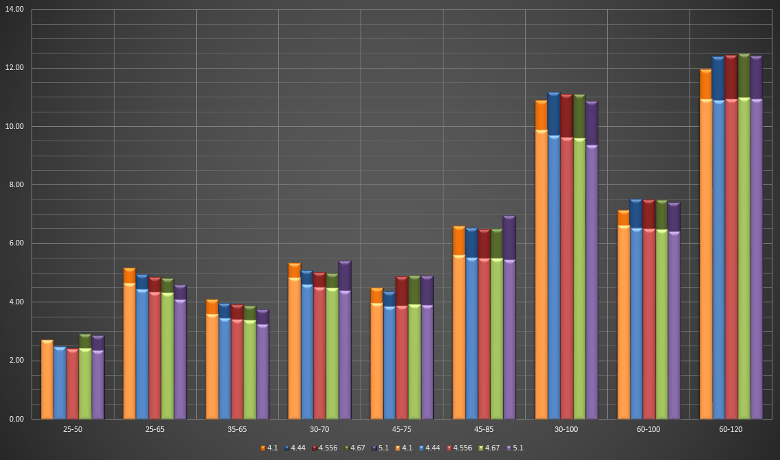

Rich 378 Report post Posted February 27, 2017 On 12/22/2016 at 7:10 PM, Foulsmell said: I've got the 4.67 and I will guarantee it's quicker acceleration than stock over those speeds. 4.44 wouldn't be worth the cost. I was interested in this, so I did a few calculations of acceleration over various speed ranges for the different final drives. There are a couple of simplifying assumptons: no wheel slip, all tractive effort is used to accelerate the car, car mass of 1240 kg, shift times are 0.5s. There's a lot less in it than I expected, across a variety of acceleration scenarios. Something I didn't graph that's interesting is that the fastest setup for a 40-80 pull is 4.1 final drive as you can do it in third. It;s very slightly faster than a 5.1 FD in fourth over those speeds. 3 Bfranklyn86, DanJ and Ade reacted to this Share this post Link to post Share on other sites
DanJ 374 Report post Posted February 28, 2017 It would be interesting to see what its like with 250ms and 1s shift times as well. I assume you did that with torque at the wheels from a rolling road printout? Have you got longitudinal load transfer in the model or just aero and rolling resistance? 1 Ade reacted to this Share this post Link to post Share on other sites
Rich 378 Report post Posted February 28, 2017 3 hours ago, DanJ said: It would be interesting to see what its like with 250ms and 1s shift times as well. I assume you did that with torque at the wheels from a rolling road printout? Have you got longitudinal load transfer in the model or just aero and rolling resistance? Nope, much simpler than that, just F=ma on the tractive effort. The numbers are very optimistic relative to actual performance, but they should be comparable (all drives have equal rolling / aero resistance so it doesn't matter if they are factored). I'm using stock torque figures, I have considered plugging in some dyno numbers, but that makes it much more car specific. I may give my car's numbers a try though. Shift times make fairly minimal differences - there's only a few instances where there is an additional shift with one FD vs another (10-30 with 5.1 is an obvious one, as is 30-60). Share this post Link to post Share on other sites

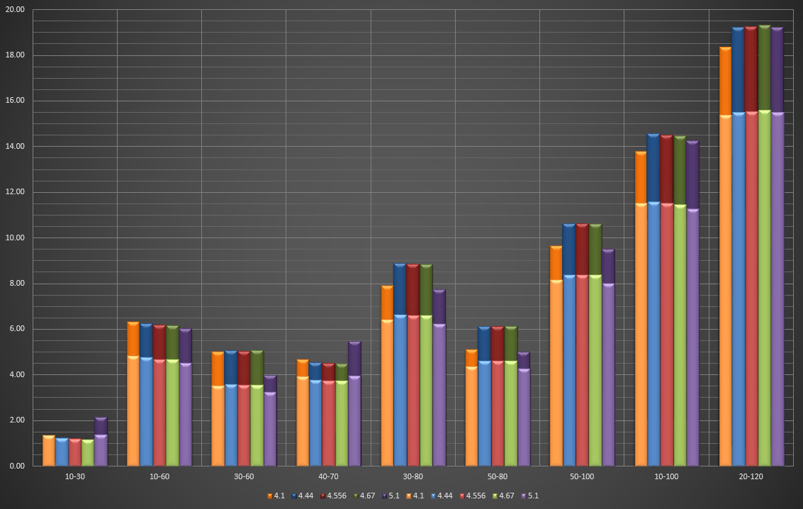

Rich 378 Report post Posted February 28, 2017 New graph! This one has a comparison of 0.25s shifts vs 1s shifts. Also it's using dyno numbers from my car. Nothing too surprising, the main thing is that shifts costs you way more than a FFD saves, so if you're introducing a shift, it's going to be worse than otherwise. This tends to favour longer ratios as you have to shift less often. So for instance 50-80 is much quicker with a 4.1 FD as you can hit 80 in 3rd; with the other options you have to upshift in the 70s. 30-60 is interesting as there's a shift for all FDs (except 5.1) but it shows the advantage of staying in lower gear longer. 2 surrey86 and Foulsmell reacted to this Share this post Link to post Share on other sites
Foulsmell 120 Report post Posted February 28, 2017 All credit to you for the graphs. Very interesting. In the real world that has corners in it the extra torque is of more advantage when exiting and the timing of gear changes has more significance. For track use there is a harder decision to make. For road it's easier. It's faster. Share this post Link to post Share on other sites

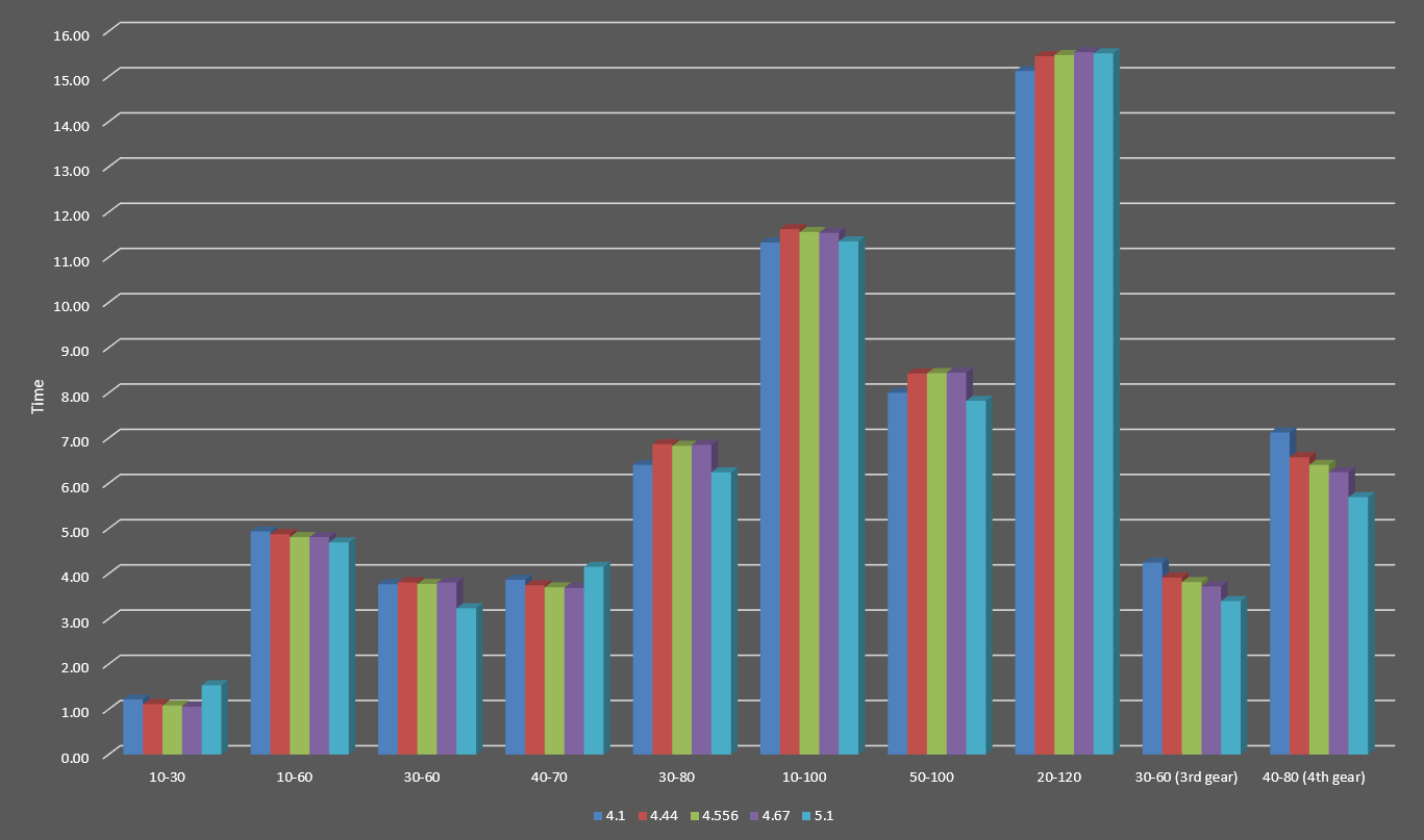

Rich 378 Report post Posted February 28, 2017 Something that's not obvious from my graphs above is that it's very dependent on shift point and speeds. The numbers above are somewhat of a best case for longer FDs as I had it setup with redline (7400 rpm) shifts and always using the highest gear possible. In the real world you wouldn't downshift to 1st at 30 with a 4.1 FD, so the 30-X numbers are a little misleading. This graph is a better representation - the shift points are 5k RPM 1st-2nd and 7k RPM for 2nd-3rd, 7.2k for 3rd-4th and 4th-5th, 7.3k for 5th-6th. Shift times are 0.5s and 0s (to illustrate how much difference is in the gearing rather than shift times). Results are a bit more as you'd expect - at lower speeds the increased torque at the wheels tends to favour the higher ratios, though 5.1 is somewhat hampered by needing to shift all the time. At high speeds, 4.1 is better as you're able to sit in 4th up to 120 mph, whereas all other FDs are in fifth. The early few numbers are intended to be typical overtaking scenarios - sitting at 25-35 in 2nd and accelerating up to NSL speeds (ish). The shorter drives are definitely better here, though the ability of the 4.1 to hit 75+ in third helps for the faster 45-75 sprint. 60-100 and 60-120 are interesting track figures as they're fairly typical of coming off a third gear corner and accelerating down a straight. Overall I think 4.556 is the best compromise choice for me, pity the Cusco one is so overpriced compared to MFactory. Share this post Link to post Share on other sites

Foulsmell 120 Report post Posted March 1, 2017 Something that's not obvious from my graphs above is that it's very dependent on shift point and speeds. The numbers above are somewhat of a best case for longer FDs as I had it setup with redline (7400 rpm) shifts and always using the highest gear possible. In the real world you wouldn't downshift to 1st at 30 with a 4.1 FD, so the 30-X numbers are a little misleading. This graph is a better representation - the shift points are 5k RPM 1st-2nd and 7k RPM for 2nd-3rd, 7.2k for 3rd-4th and 4th-5th, 7.3k for 5th-6th. Shift times are 0.5s and 0s (to illustrate how much difference is in the gearing rather than shift times). Results are a bit more as you'd expect - at lower speeds the increased torque at the wheels tends to favour the higher ratios, though 5.1 is somewhat hampered by needing to shift all the time. At high speeds, 4.1 is better as you're able to sit in 4th up to 120 mph, whereas all other FDs are in fifth. The early few numbers are intended to be typical overtaking scenarios - sitting at 25-35 in 2nd and accelerating up to NSL speeds (ish). The shorter drives are definitely better here, though the ability of the 4.1 to hit 75+ in third helps for the faster 45-75 sprint. 60-100 and 60-120 are interesting track figures as they're fairly typical of coming off a third gear corner and accelerating down a straight. Overall I think 4.556 is the best compromise choice for me, pity the Cusco one is so overpriced compared to MFactory. Just go for the 4.67. There is only around 2% difference in performance and as you say a lot cheaper. Share this post Link to post Share on other sites
