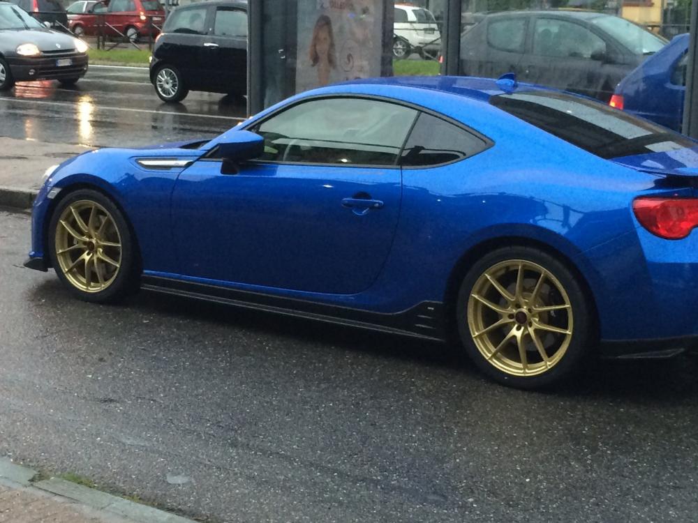

Let's have your thoughts and in the meantime here is what it could look like - unfortunately I don't know what the offset is on these wheels but looking at the back I wonder if they are ET452050513409_SubaruLeggeraHLT2.jpg.db84118b36ec8753799c761798d3e431.jpg

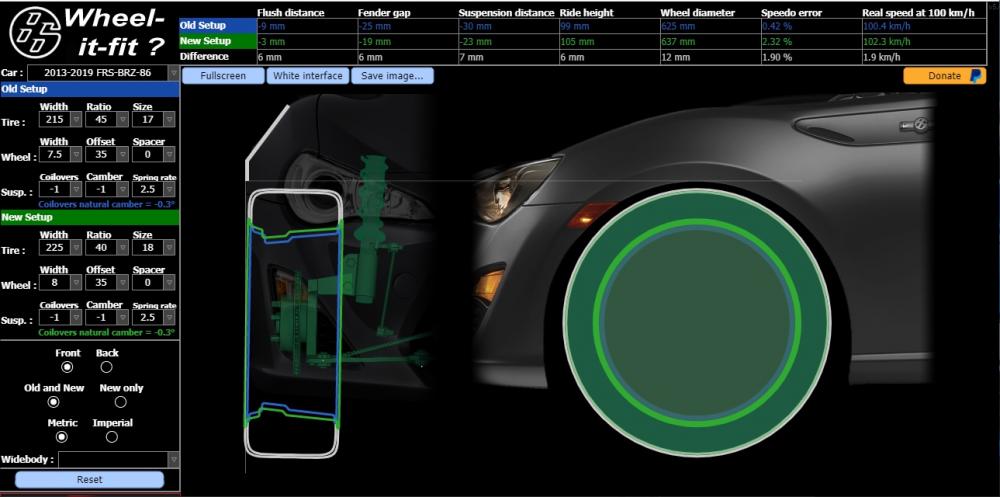

Option 1 or 2 are the best choices. Personally I'd go Option 2.
Option 1: This is probably best if you are going to keep stock suspension or want a slightly lighter wheel:
Option 2: Will have a better fitment when lowered (1" drop and 1degree camber) and with some camber:

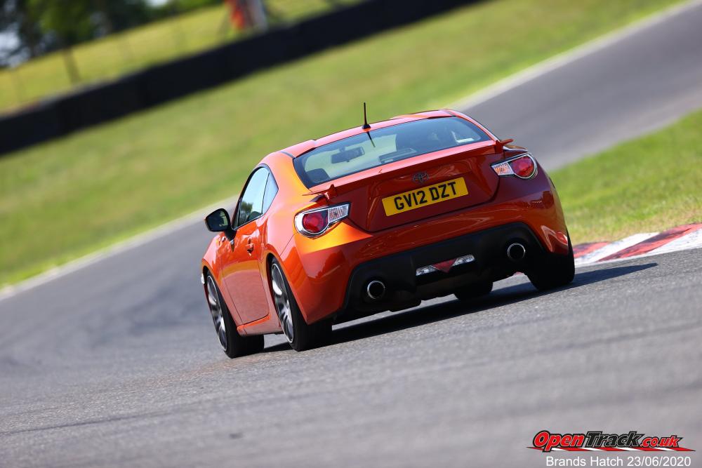

haven't got any decent pictures to hand at the moment to show the fitment of mine but mine are 8.5 wide and et38. therefore stick out slightly more. No rubber has ever been found on road or track :)

I use 225/40-18 V105's Drives nice and would be spot on for an 8J wheel too.
Think I have some pictures at home of when the car was on those wheels on stock suspension and on 20mm springs, I will see if I can dig them out.
