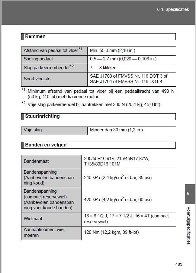

Jay 37 Report post Posted September 24, 2020 24 minutes ago, Church said: Jay: AFAIK "normal" MY2017 still has 17x7 (though of different looks). It's if with performance package (brembos, shocks and different wheels), then also 17x7.5 wheels for brake clearance. Hereunder I attached a copy of the relevant specifications page, as found in the car manual. It's in Dutch, but I'm sure you'll find "17 x 7 1/2 J" right from "Wielmaat". Share this post Link to post Share on other sites

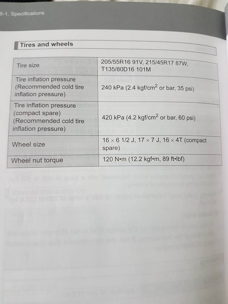

BRZ-123 174 Report post Posted September 24, 2020 Very interesting Jay. Either Dutch cars came with different rims or its a 2017 MY change. Mine is a 2015 MY. Everything else is same except wheel width. See attached.Do you mind sharing a pic of the wheels on your car?Sent from my SM-G970F using Tapatalk Share this post Link to post Share on other sites

BRZ-123 174 Report post Posted September 25, 2020 My car is in my profile pic. Looks the same wheels as UK cars. I now think people have not looked at their manuals and UK cars will also be 7.5 wheel. Curious. Anyone with a 2017MY happy to share a pic of wheel spec from their manual please?Sent from my SM-G970F using Tapatalk Share this post Link to post Share on other sites

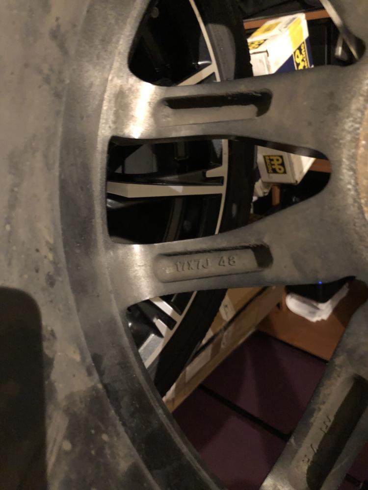

Lauren 2259 Report post Posted September 25, 2020 1 hour ago, BRZ-123 said: Looks the same wheels as UK cars. I now think people have not looked at their manuals and UK cars will also be 7.5 wheel. Curious. Anyone with a 2017MY happy to share a pic of wheel spec from their manual please? Sent from my SM-G970F using Tapatalk Better to look at the actual wheel it will be stamped on it. Share this post Link to post Share on other sites
Jay 37 Report post Posted September 25, 2020 5 hours ago, BRZ-123 said: Looks the same wheels as UK cars. I now think people have not looked at their manuals and UK cars will also be 7.5 wheel. Curious. Anyone with a 2017MY happy to share a pic of wheel spec from their manual please? Sent from my SM-G970F using Tapatalk Would be interesting to know. Share this post Link to post Share on other sites

Jay 37 Report post Posted September 25, 2020 11 hours ago, Lauren said: Better to look at the actual wheel it will be stamped on it. Great, I didn't know! I suppose it's somewhere on the inside? Meanwhile I found a slightly newer Manual of the 2017 MY, at the site of the importer. This manual reads 17 x 7 J. I guess the early manual is wrong, as all other versions mention 7". Share this post Link to post Share on other sites
choupolo 31 Report post Posted September 25, 2020 I will check my manual tonight and report back on my 2017 car. Sure they were 7”. Share this post Link to post Share on other sites

Lauren 2259 Report post Posted September 26, 2020 As I thought. It's only the Blue Edition with Performance Pack that has 7.5" wide wheels. Share this post Link to post Share on other sites
choupolo 31 Report post Posted September 26, 2020 But am I right in saying Jay’s car isn’t a Blue Edition and has 7.5” wheels? Or the manual is wrong? Share this post Link to post Share on other sites
