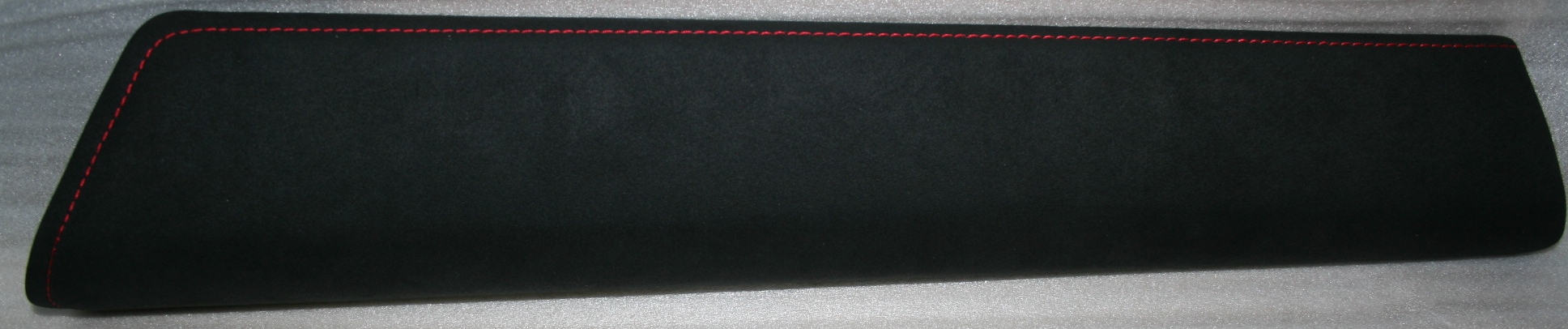

Alcantara/suede visor cover with red stitching:

I also removed all my silver interior trim before the car went off to paint so I could paint them myself matt black.  Not a big fan of matching these to body colour so went for something simple.  I sanded, primed, painted matt black then used matt lacquer for protection.  I'm intersted to see how long they last, if the finish doesn't hold up, I will invest in some carbon parts but for now this was a simple and cheap fix.
49944372108_5580b1a890_c.jpgUntitled by James Baker, on Flickr
