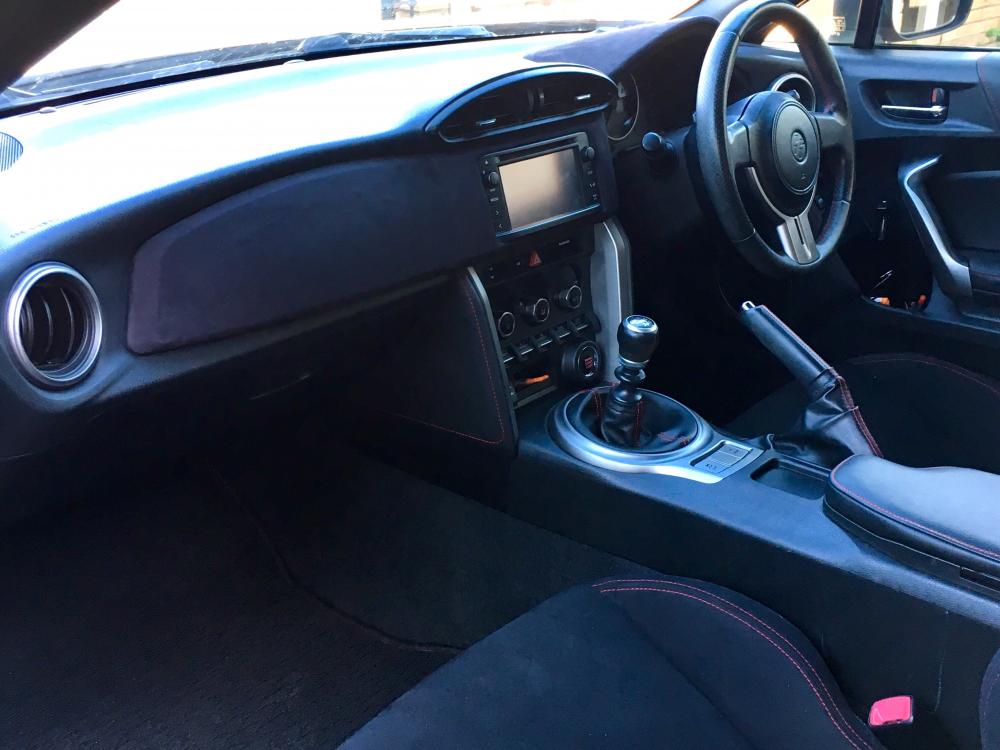

DaveeeB93 9 Report post Posted August 16, 2018 Fun DIY job (maybe not fun) wrapping the centre dash and Gague hood in alacantara. Saved a good amount of £££’s and looks so much better than the cheap plastic 4 GT86-Ian, gavin_t, Lmc and 1 other reacted to this Share this post Link to post Share on other sites
