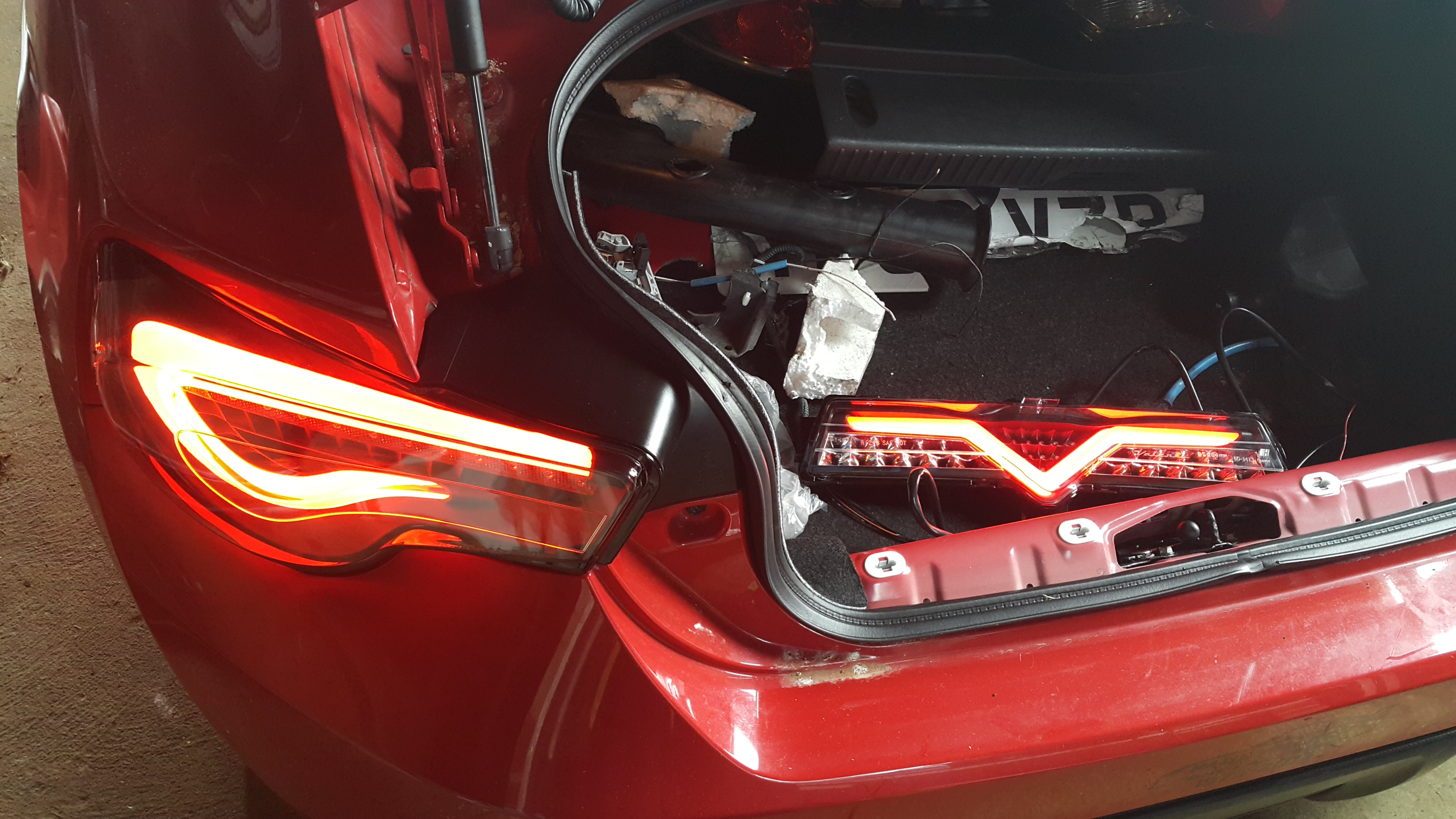

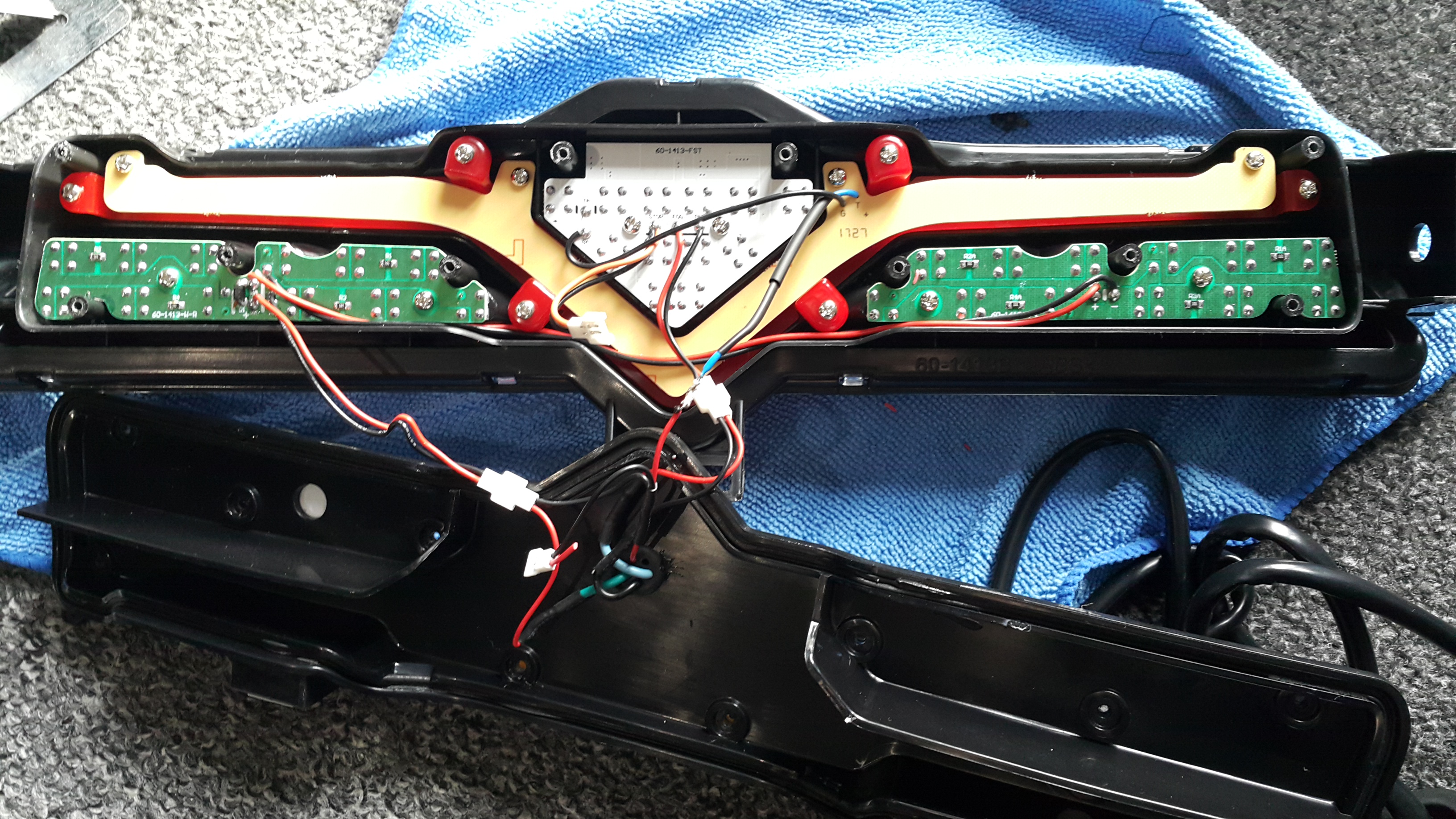

Samwise 155 Report post Posted March 8, 2018 7 minutes ago, nikndel said: If they are from the US they will need some changing the fog light is sometimes a 3rd brake light as I'm not sure if they run rear fog lights in the US Yeah as said the V light will need a little bit of work to get working as a fog light but it shouldn't be too difficult, a quick google brings up a few tutorials. The 2 main lights should work without any problems as its just Sidelights, Brake light and indicators. Share this post Link to post Share on other sites
nikndel 509 Report post Posted March 8, 2018 Just now, Samwise said: Yeah as said the V light will need a little bit of work to get working as a fog light but it shouldn't be too difficult, a quick google brings up a few tutorials. When I did my 3rd light I found someone from OZ land all the US ones on You Tube didn't show a rear fog option Share this post Link to post Share on other sites
Samwise 155 Report post Posted March 8, 2018 17 minutes ago, nikndel said: When I did my 3rd light I found someone from OZ land all the US ones on You Tube didn't show a rear fog option I'll have a look at what happens when I plug it in as is and crack out the soldering iron if i need to I was hoping for the V to come on with the side/parking lights and the Triangle to work as a fog light Share this post Link to post Share on other sites
nikndel 509 Report post Posted March 8, 2018 3 minutes ago, Samwise said: I'll have a look at what happens when I plug it in as is and crack out the soldering iron if i need to I was hoping for the V to come on with the side/parking lights and the Triangle to work as a fog light 4 minutes ago, Samwise said: I'll have a look at what happens when I plug it in as is and crack out the soldering iron if i need to I was hoping for the V to come on with the side/parking lights and the Triangle to work as a fog light I think if you just plug it in bearing in mind there is a same as oem plug the V and triangle will come as rear fog and reverse as per normal but when you get round to fitting them let me know how you get on👍 Share this post Link to post Share on other sites

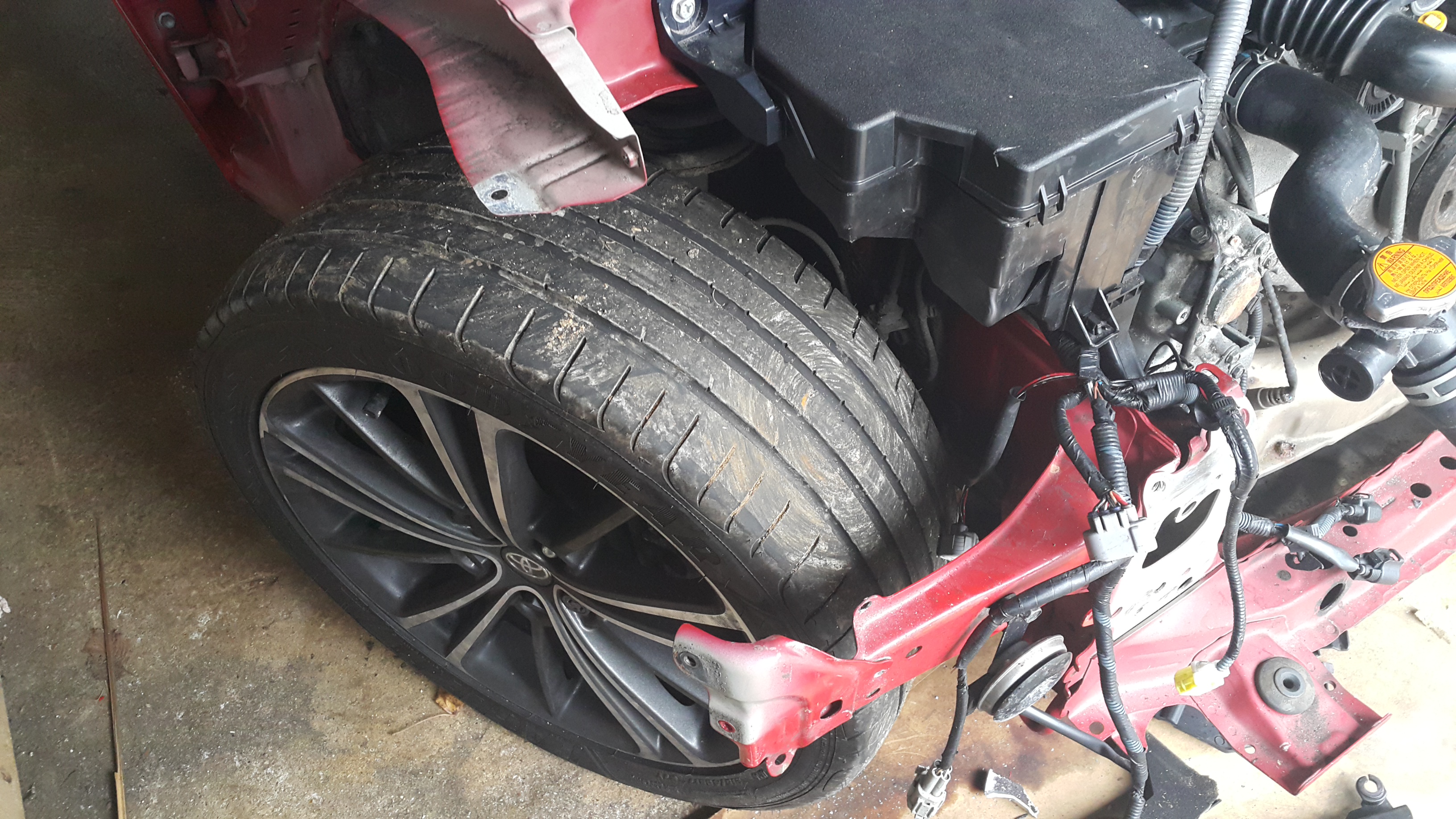

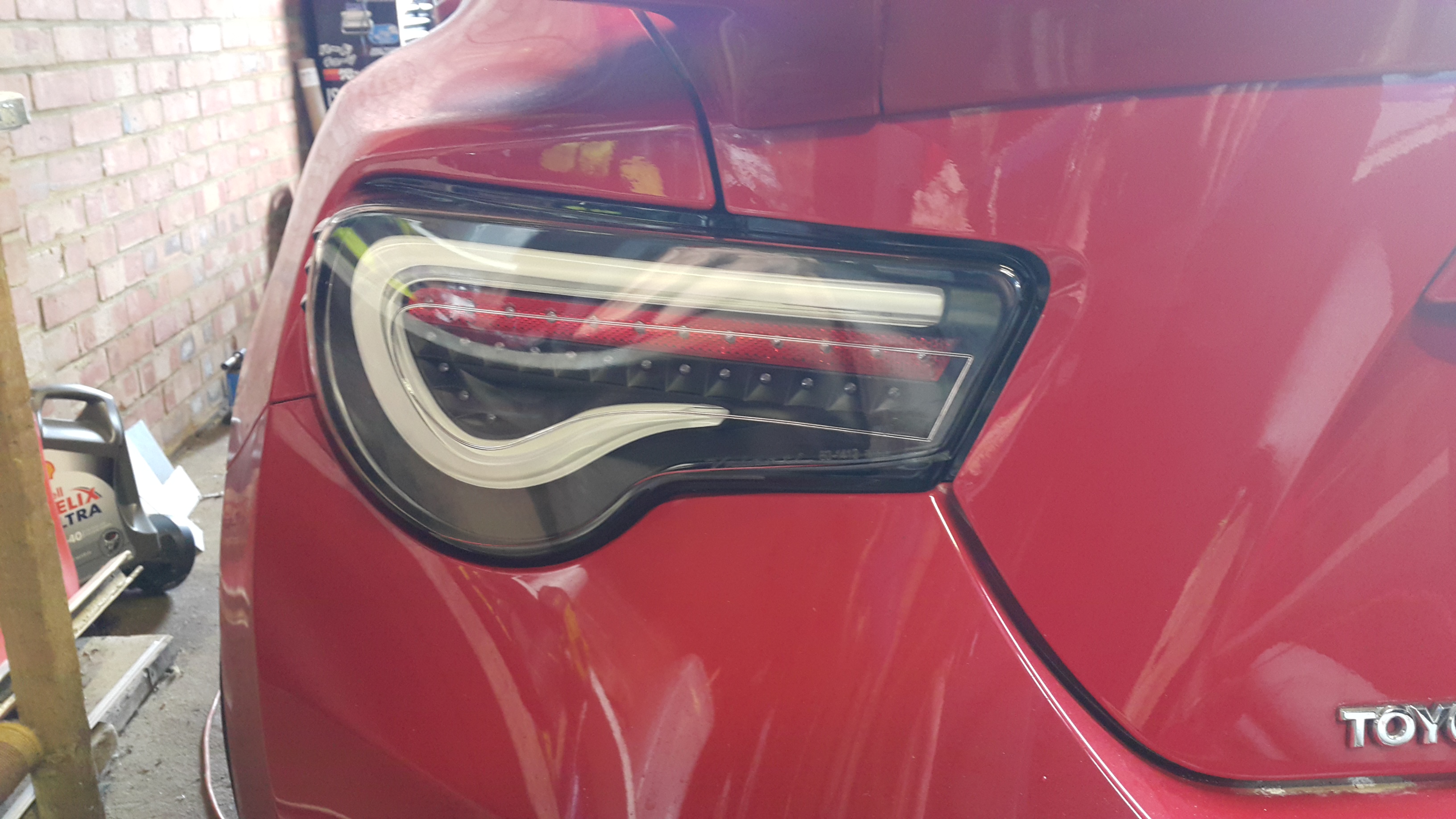

Samwise 155 Report post Posted March 10, 2018 Didn't get alot done today, drilled out a few spot welds on the last few damaged pieces but the drill ran out of power Visited the local toyota dealership today and left them a lovely list of part numbers I need ordered, waiting to hear back from them on Monday! Got the rear lights fitted but theres a funny little problem with them, the rear indicator and sidelight wires are mixed up, meaning the rear lights blink with the hazards and the indicators stay solid. Going to sort this out by popping the pins out the connector and swapping them over but they look so good! Tested the new V light too its as you said Nikndel: On 08/03/2018 at 11:08 AM, nikndel said: I think if you just plug it in bearing in mind there is a same as oem plug the V and triangle will come as rear fog and reverse as per normal but when you get round to fitting them let me know how you get on👍 So i've opened up the back of the V light and im going to tap the V LED bar in to the side lights of the rear light clusters, didn't get any before shots but you can see here i've soldered the connection for the LED bar (light blue cable) in to a bit of wire that i'll run up to the rear light clusters. Yes this is the extra length of cable that comes with the light to make the fog light flash like an F1 brake light. I hate the thought of that "Feature" so I figured i'd just reuse the cable for my own use! Going to plug this back in tomorrow or next weekend to test it as well as sort the rear light clusters, think i'm going to be waiting a while for parts from Toyota unfortuantely. Share this post Link to post Share on other sites
Samwise 155 Report post Posted March 11, 2018 Sorted out the last bent bit on the front end today and got the rear lights buttoned up. Going to replace this part of the arch I removed and then hopefully the horizontal bit coming off the chassis leg shouldnt be too far out Got the pins swapped out on the rear lights and they work now too! Tried to fit the fog light but its a total pain to get to with the OEM exhaust in the way and the bolts for it being so rusty. Does anyone know the legality of having the V come on with the headlights? The Triangle is still very bright so should pass as a fog light okay. Share this post Link to post Share on other sites
Paul 442 Report post Posted March 11, 2018 21 minutes ago, Samwise said: Sorted out the last bent bit on the front end today and got the rear lights buttoned up. Going to replace this part of the arch I removed and then hopefully the horizontal bit coming off the chassis leg shouldnt be too far out Got the pins swapped out on the rear lights and they work now too! Tried to fit the fog light but its a total pain to get to with the OEM exhaust in the way and the bolts for it being so rusty. Does anyone know the legality of having the V come on with the headlights? The Triangle is still very bright so should pass as a fog light okay. As shown in the picture is fine, quite a few members have theirs modded like that. As long as you can switch the triangle on and off to act as the fog light you're fine. 1 Samwise reacted to this Share this post Link to post Share on other sites
Samwise 155 Report post Posted March 11, 2018 1 hour ago, Paul said: As shown in the picture is fine, quite a few members have theirs modded like that. As long as you can switch the triangle on and off to act as the fog light you're fine. Good stuff, sorted the fog put yesterday so it should be all good. Share this post Link to post Share on other sites

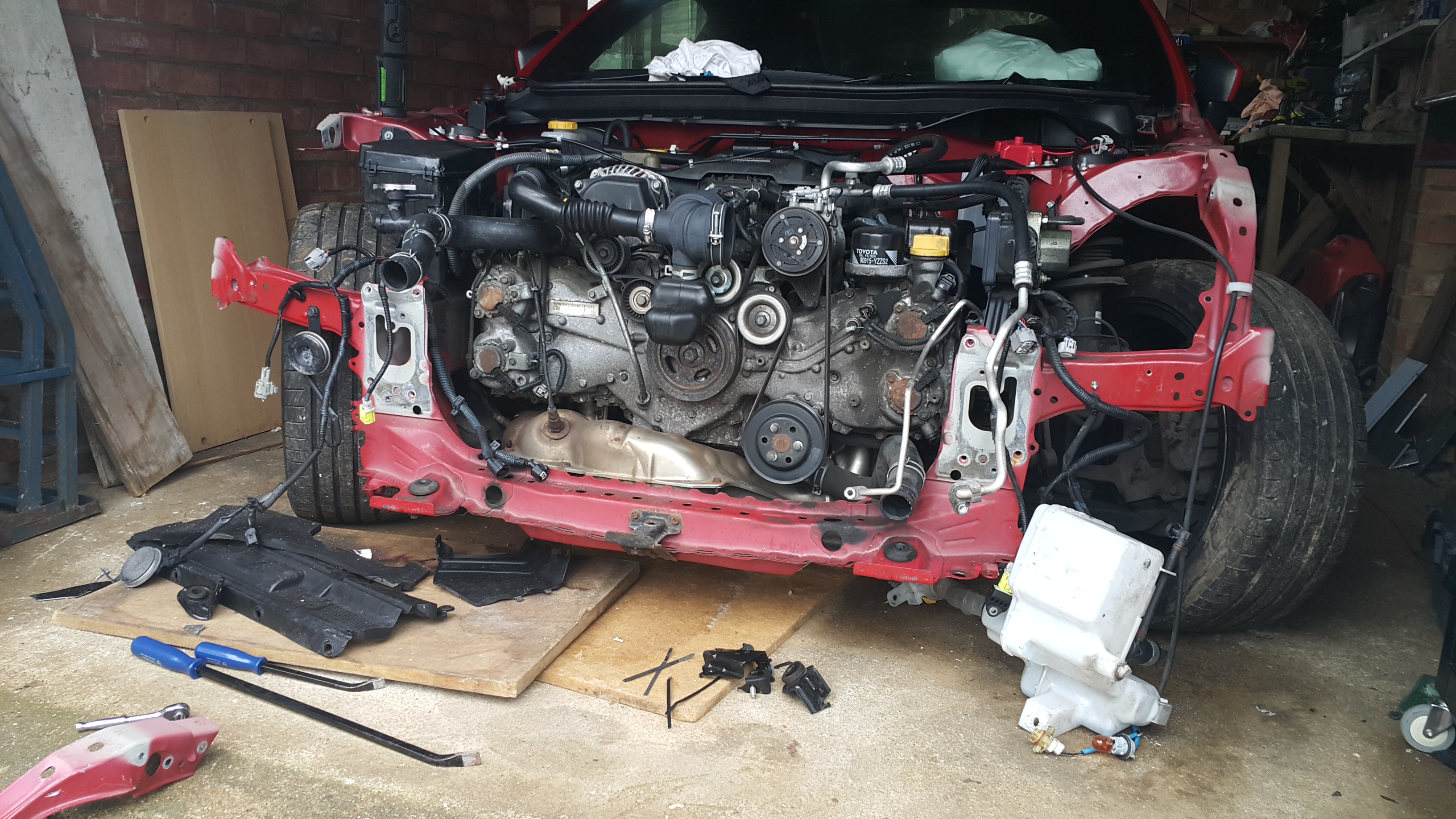

Samwise 155 Report post Posted April 1, 2018 Progress somewhat continued this weekend with the repair of the 86. Gatecrashed the Gt86 meet at the Garderner's arms this Saturday in my Subaru where I was able to meet a few of you and have a good look at what the car should look like as well as ordering lots of goodies to start getting the car back in one piece! Took a trip down to my local Toyota dealership who had some parts waiting for me mostly consisting of new front end crash structure/rad support parts, as well as a few other bits including the headlight brackets, rubber radiator pipe and replacement headlight washer. Set about getting those painted today: So I spent today painting them so they were atleast red so they wouldn't stand out too much in the engine bay, the finish isn't great and the colour match isn't perfect either but it will do for now. Once all the other brackets, covers and bolts are on it shouldn't be too noticeable (I hope) as you can tell I had a very professional paint booth set up! That's all for now. I've also placed orders for everything I need to finish up the car with the exception of wings, bumpers and headlights. I ordered a set of Airbags/Seatbelts and Airbag ECU from a breaker on Ebay. I've ordered a Seibon Carbon fibre bonnet from amber performance. I've also ordered a few other goodies including replacement aluminium radiator, radiator fans, blinker relay (needed for the valenti's), new smoked side markers as mine were toast, Mishimoto cold air intake as the OEM airbox was turned in to a jigsaw puzzle in the crash, Mishimoto intake pipe and a few OEM black interior trim pieces to replace the carbon wrapped pieces fitted currently all of which is coming from the US. I Know the Intake bits won't really improve performance however with the OEM airbox and Maf pipe destroyed I felt getting new toyota parts would be more expensive than getting the aftermarket pieces. As well as this i've been considering getting an exhaust to fit so it's atleast a little nicer sounding once im all done and dusted, looking for something cheap as you can imagine after all these recent orders so i've been considering the untested and questionable Malian exhaust. Share this post Link to post Share on other sites

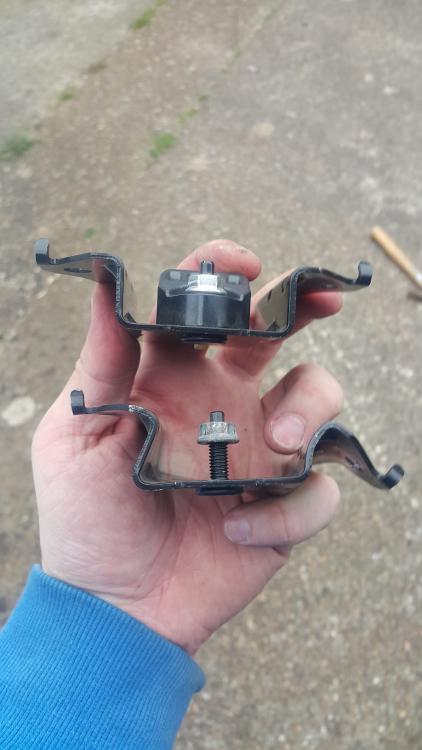

Samwise 155 Report post Posted April 7, 2018 So another weekend and i'm back at it! And it's time to start putting this car back together! It was all fairly simple as it was a case of bolting on the nice new parts: And that's it! Its all loosely bolted back in to place as some parts will need to come off again to have a couple of the spot welds re-done next weekend by my buddy Went about re-attaching and fixing some of the various brakets and clips that hang on to these pieces: Airbag sensor, old vs new. Had to replace one of them, as it was lost in a mess of folded up metal. Managed to get this one bent back in to shape and popped the sensor back on. All done for now, once I get the new Rad, AC Condensor, etc I can start bolting those on as well as the new parts getting spot welded next weekend. Unfortunately there were a couple more casualties from the crash, namely the Rad filler neck, bonnet latch & one of the O2 Sensors: Already managed to source a new filler neck & rad cap for £30 and i'm trying to find a new bonnet latch mechanism but the o2 sensor could easily be £150+ so I think i'll take it off tomorrow and have a crack at re-soldering it. Share this post Link to post Share on other sites

Samwise 155 Report post Posted April 15, 2018 Got some progress done this weekend although there aren't many pictures im afraid. Had my friend over to sort out the small bits of welding on the new front end pieces, this was fairly easy and clean on most parts but got a bit tricky for him where he was trying to weld the new thin gauge steel pieces to the much thicker pieces of the chassis legs, it's all welded up though and definitely strong but not the most pretty in those areas. While he was busy at work I was also busy.. in my own way Once this was done we got the new radiator, Radiator fans, AC condesnor and Rad filler neck fitted. Not the most difficult job in the world but I can now safely say without a doubt that I HATE those rubber radiator hoses! All in all a pretty good day, there are a couple of small issues I need to get sorted out and then I can start bolting the crash support, washer bottle, etc back on. Couple of issues I ran in to were the fact that one AC pipe is bent, going to give it a whack to see if i can straighten it out before buying a new one if need be and the lower AC pipe's O-ring is broken so i'll have to source a new one of those. The more exensive issue is that 2 of the Cam Solenoid connectors are broken so I need to get 2 more of those too. Still planning to have the car back on the road by the end of the summer, shame it won't be done before hand but with car tax on the subaru and other bills coming through this month it would be silly to try and rush things and push myself to live on a shoe string to get this repair completed. Share this post Link to post Share on other sites

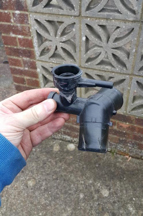

Samwise 155 Report post Posted April 28, 2018 Another update today, one with a few victories and some losses. The first victory today is that I was able to tweak the AC pipe's back in to place which saves me having to replace them altogether! I was also able to get the new bonnet latch and mishimoto intake pipe fitted, which smartens up the engine bay nicely. The half victory in this update is that the new mishimoto air intake is fitted after much faffing about with the MAF sensor and bending back the airbox bracket to shape to fit it. It's not quite 100% however as it clearly doesn't fit properly with the gigantic filter one, it was always going to be tight however I didn't expect the filter to make contact with the AC condensor. I may need to drop the AC condensor down on its brackets a bit and refit the filter. And finally the defeat of today was that once beginning to fill the system up with coolant we ran in to a problem... Thats right, a water leak. It appears the "Water Inlet" as the part is called, which appears to be a large cast aluminium water inlet manifold of sorts has a large crack, likely after taking a shunt in the crash... Nasty! Share this post Link to post Share on other sites
MartinT 514 Report post Posted April 28, 2018 It was bound to have setbacks, but even so the quality of the rebuild is impressive. Can you replace the water inlet manifold without taking the engine out? Share this post Link to post Share on other sites
Samwise 155 Report post Posted April 28, 2018 1 minute ago, MartinT said: It was bound to have setbacks, but even so the quality of the rebuild is impressive. Can you replace the water inlet manifold without taking the engine out? Yeah, its not the end of the world and I was almost beginning to count my luck with how few setbacks I had. Should be able to replace it with ease once the Intake Inlet manifold is off. it just sits under there, its part 16322 here: Share this post Link to post Share on other sites
