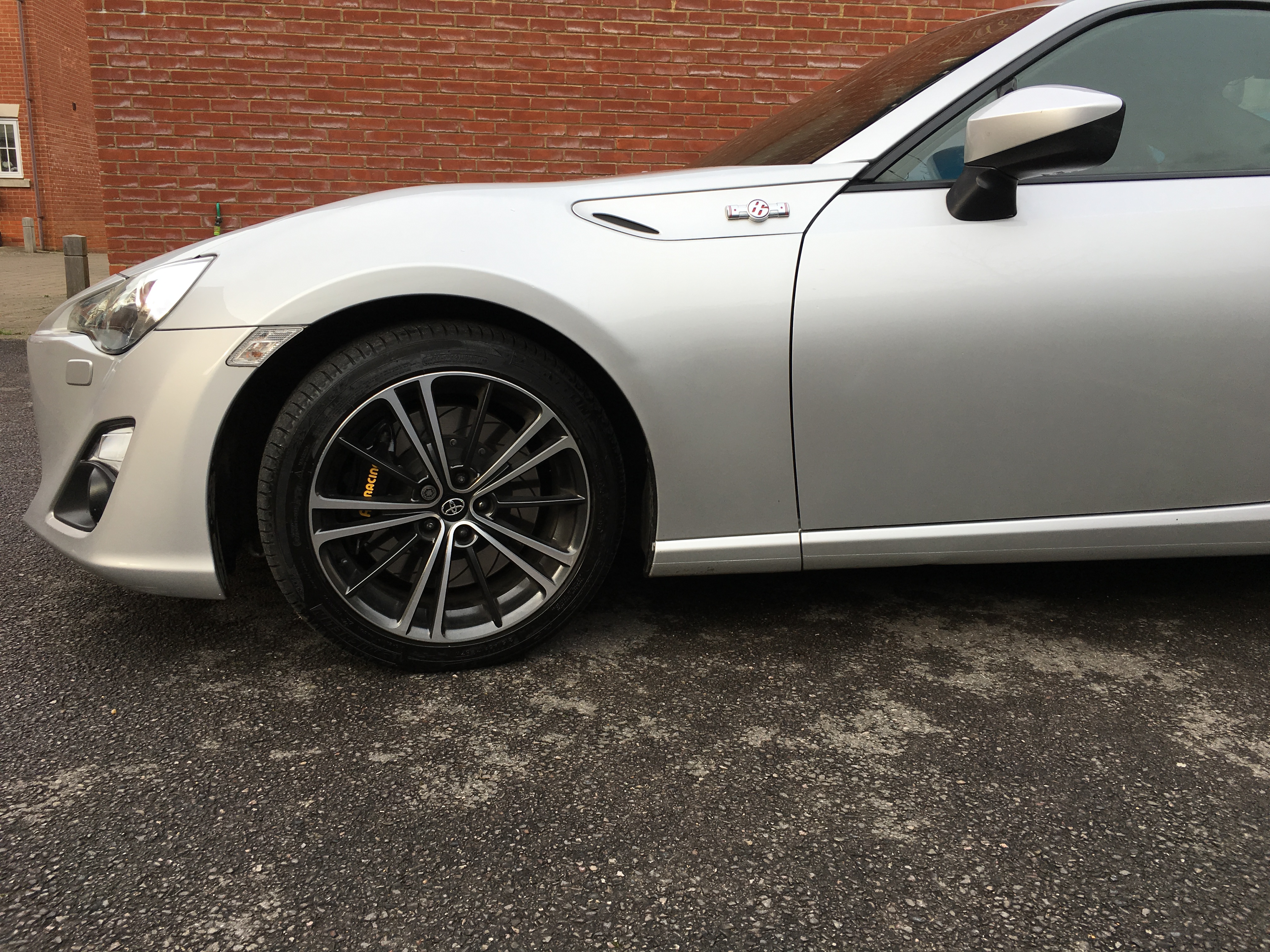

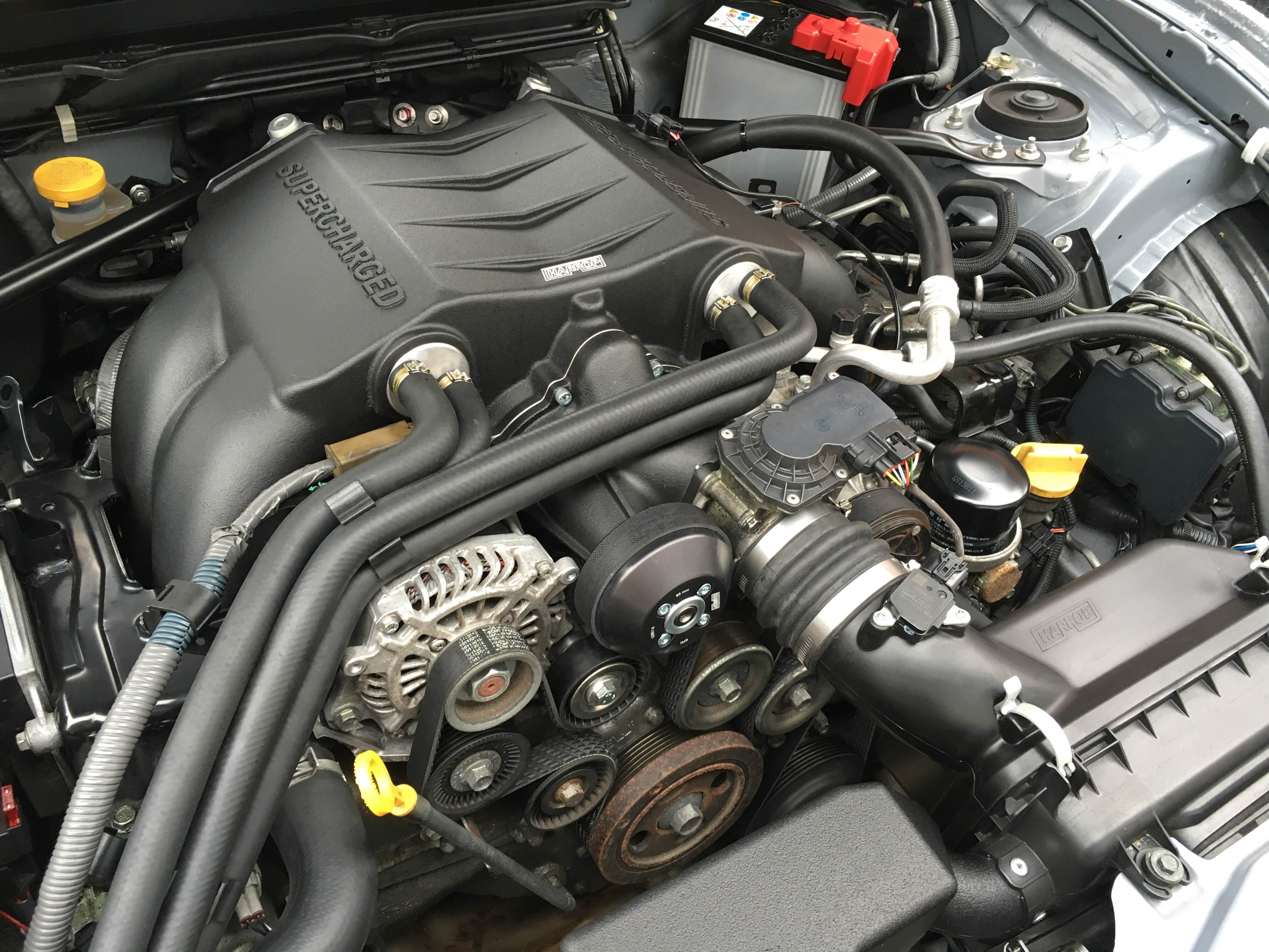

Bfranklyn86 52 Report post Posted May 13, 2017 Hi all, I thought I'd do a build thread for two reasons: firstly, although I've only done 2 significant mods so far, they have transformed the driving experience in terms of added performance and enjoyment gained. Secondly, I'm poised to make a few more upgrades and would appreciate any guidance. I got my silver '13 GT86 with no ambition to modify it, as the last car I'd owned was a bone stock Toyota starlet......... so the 86 was a big step up! However, about 6 months into ownership the torque dip was starting to annoy me, and I thought the car had unused potential because it is light (ish), has a low center of gravity and a good chassis. I also did one track day while the car was stock which confirmed to me that the car could use a tad more power in this domain too. Overall, my aim is to keep this car as a comfortable daily driver which can also hold it's own (reliably) on track. My second aim is to avoid the look and sound of a heavily modded car. Mod 1) Harrop Supercharger (installed and tuned by Mark at Abbey). 240whp, dyno'd on the hottest day of the year. Very happy with how this turned out - torque everywhere and it produces the power reliably lap after lap on track. It is not perfect, there are a couple of niggles (like hesitation at low revs when the engine is cold), but overall it has been fantastic. However, noting that the stock brakes had struggled on track even under NA power, I soon realised I needed to do something about the brakes: Mod 2) AP Racing front BBK. 4 piston. (I've also got Stoptech disks/pads on the rear) This has been another great buy. I have not experienced any brake fade since they were fitted. And no longer any squeal....that was worth the 2.2K alone. Minor Mods: I also have an Extreme Organic Clutch, the intec high level brake light, and have swapped the Primmies for PS4s. Now for the exciting bit......my wish list!!!! - Catback: I think this car deserves a more aggressive/louder exhaust note. However, I do not want it too loud so that it sounds obnoxious or attracts too much attention, and my GF has said she is not a fan of loud cars. @Ade's custom Hayward & Scott catback is probably the one I'd go for because it is quiet in the RPM ranges where I usually drive - 2-3k. Unless good quality second hand catback comes up really really cheap in the meantime. - Suspension: I like the way this car twitches around a bit on country roads, but lets be honest the stock suspension is much too 'floppy' on track. Currently looking at coilovers but I have a lot of research to do. I do want to lower it just a little bit, I do want to be able to adjust damping from track to road use, and I want to be able to add some camber. I'm happy to spend a bit of money here, because i'm not willing to compromise too much on the stock ride quality. - Wheels: While I think this would be a good place to save some weight, the price of good quality forged wheels is prohibitive for me. They also fail the 'keep stock look' test, so unless the right style set come along at the right price, I will not be getting any. - Cosmetic: The valenti sequentials look really nice, but can't decide what colour is best for Silver. Also, I want an ebay rear diffuser. Right, thanks for reading! As I suspect I am the only one who will read this, I will therefore thank myself. I'm really happy with the mods I've made because the performance has been transformed, while the stock look, sound, and fun factor has not. PLEASE, if you have any suggestions to help with what I've mentioned on my wish list, let me know. 2 DanJ and surrey86 reacted to this Share this post Link to post Share on other sites

Cerastes 204 Report post Posted May 13, 2017 Nice. Probably a silly question but when you fit a supercharger doesn't the manifold get changed too? As I thought the manifold was a "limiting" factor; so surely fitting a supercharger and changing manifold would give you a better performance boost? If so, that would make the exhaust note change slightly? As Paul said, Q300 is a good catback for a better exhaust note but not being overly loud. It was the one I was planning to get until I came across a 2nd hand Avo; which I love. Share this post Link to post Share on other sites

Bfranklyn86 52 Report post Posted May 13, 2017 24 minutes ago, Cerastes said: Nice. Probably a silly question but when you fit a supercharger doesn't the manifold get changed too? As I thought the manifold was a "limiting" factor; so surely fitting a supercharger and changing manifold would give you a better performance boost? If so, that would make the exhaust note change slightly? As Paul said, Q300 is a good catback for a better exhaust note but not being overly loud. It was the one I was planning to get until I came across a 2nd hand Avo; which I love. Not a stupid question at all! There is 17whp more at the top end on offer for me if I get an aftermarket catless manifold and a high flow cat centre pipe. I don't think it's worth it. If I was ever to drop a pulley size (which Mark has told me unequivocally not to do) then I'd definitely do it. A guy in the states is making 280whp with just a tomei UEL manifold and a dropped pulley size..... rest of the exhaust stock I also considered paying £330 to get the stock manifold cat removed - not sure what the horsepower gain is with this though. Share this post Link to post Share on other sites
shiftspark 41 Report post Posted May 13, 2017 The charger looks very OEM,nice mods 1 Bfranklyn86 reacted to this Share this post Link to post Share on other sites
