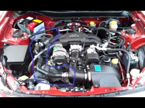

Igi 28 Report post Posted April 25, 2017 10 minutes ago, GT-Eighty-Chris said: Im not too fussed about the performance though, but more the sound (and I suppose bling). Just read about a noise generator in the foot well though? What's the deal with that? So basically if you lift your carpet up behind the pedals, you'll notice there's a small hole in the footwell, now open up the bonnet and you can see that the pipe goes into the intake piping just before the throttle body. This is basically so the engine can do this to you: Share this post Link to post Share on other sites
