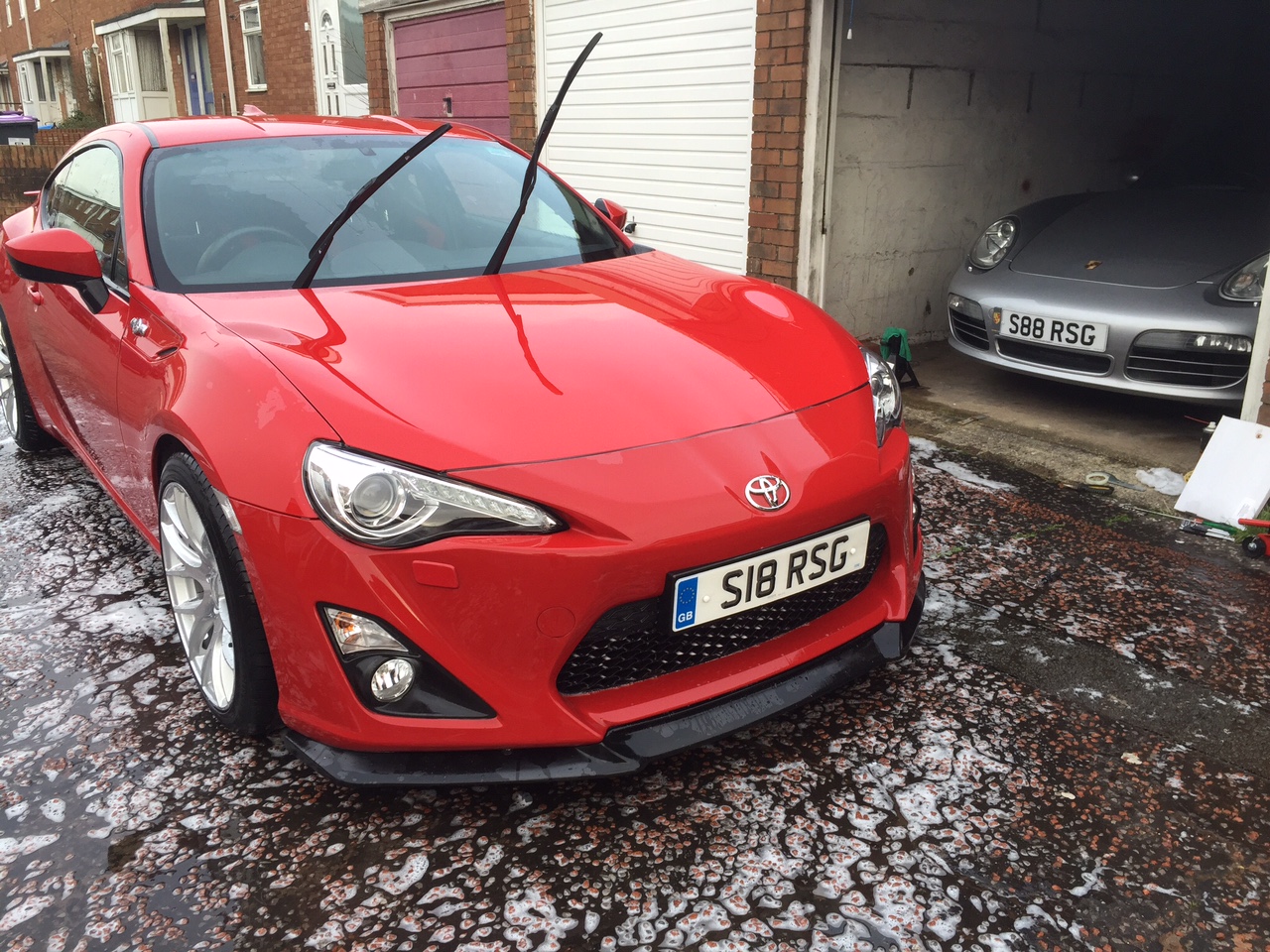

Rich 378 Report post Posted January 18, 2016 How much drop is that on the coilovers? Looks good! Also is the the HT Autos splitter? Share this post Link to post Share on other sites
S18 RSG 429 Report post Posted January 19, 2016 Cheers @Furnate To answer your questions, the drop is fairly small, around 25-30mm if I had to guess. I have an exhaust bracket that needs adjusting before I can think about going any lower (which I may not do anyway) Yes, it is the HT Autos splitter, bought from Fensport. Share this post Link to post Share on other sites

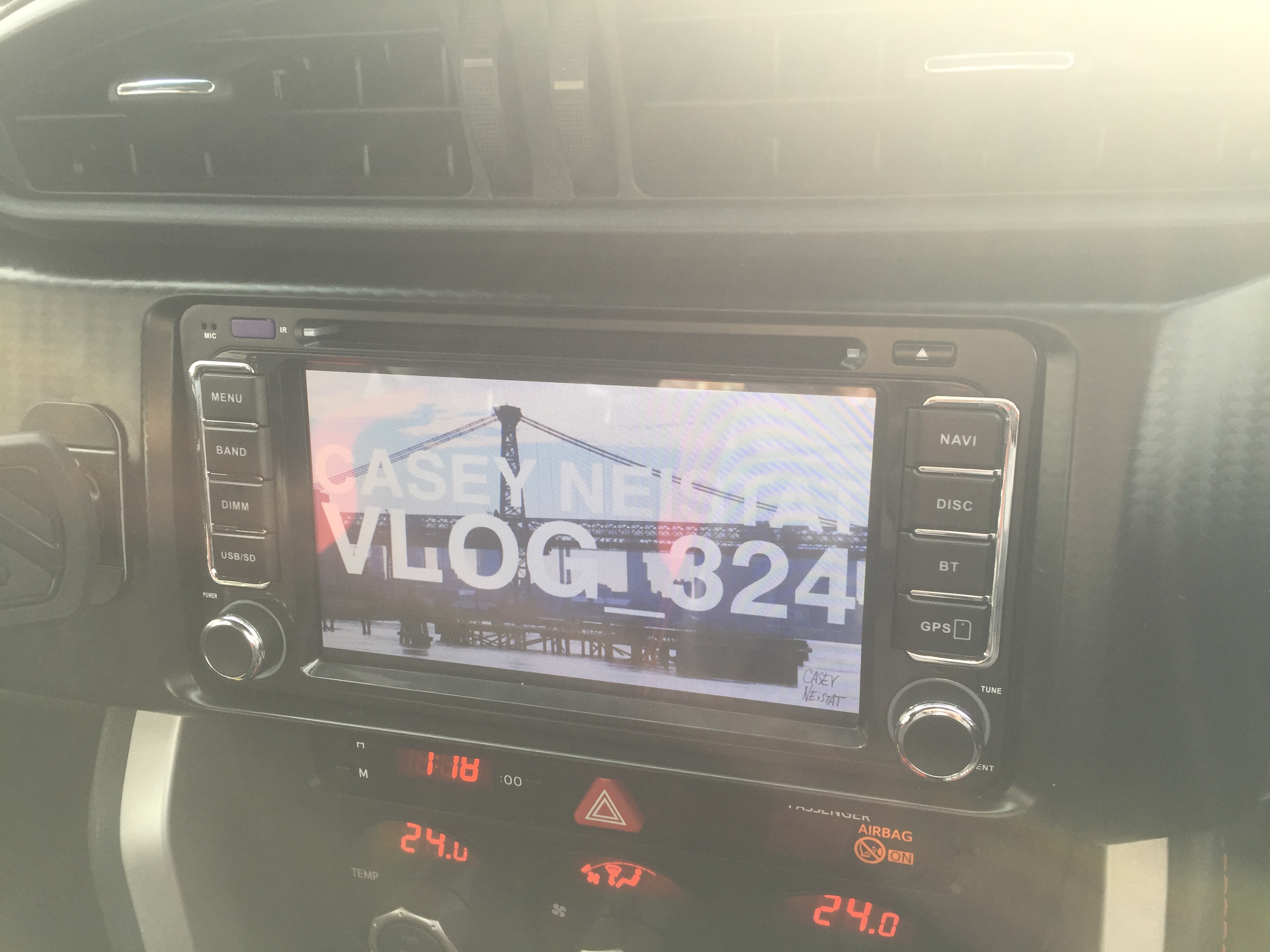

S18 RSG 429 Report post Posted March 7, 2016 Well, it's been 6 weeks since my last update, so I figured now is a decent time for another. Since the last update, I'm happy to report that 4 out of 7 of the plans I had for the car have been completed, along with a few others which I didn't plan for, so, let's start from the inside. I got around to fitting the Focal integration speakers. Made for a nice upgrade to the cardboard speakers our cars come with, and took no more than 20 minutes to fit both speakers. Tweeters took a little longer, mostly because there were no instructions, but loads of parts. Turns out, I didn't use any of the parts, and just retrofitted the new tweeters into the existing holders. To compliment the new speakers, I decided to bring forward the planned head unit, and ordered an Android unit from America, which has been tried and tested on the FT86 forum. Was a little over £250 all in, and required some extras such as an antenna adaptor, USB adaptor and modified brackets, but it's in now. Sound wise, was another big jump up from the stock stereo, with much more adjustability from the EQ. It allows me to use a multitude of media options, CD, DVD, USB, SD card, Bluetooth or Wifi, and best of all, fits into the 200x100 slot without the need for an adaptor. Some pics: Also pushed another thing forward, and organised a stage 1 remap with Mark over at Abbey Motorsport. I posted my experience at Abbey in the trader section, but the shortened version is the car went from 162 to nearly 180whp, with a similar increase in torque. Car feels much more "alive", especially at motorway speeds, and the torque dip is much less noticeable (but still there for sure). Good way to spend the money. Here's an up to date pic on the dyno: Also got around to fitting the Valenti rear lights, which I fell in love with instantly. Haven't really taken a decent pic of them yet, but here are two I stumbled across on my phone: Finally, I spent a weekend a few weeks ago spraying some of the interior plastics (the silver bits anyway) in red plastidip. Still got the door handles, air con surround and steering wheel detail to do, but overall really happy with the results. A few people saw it at the meet in February, so can probably vouch for the finish. No pics though unfortunately, will get around to that soon. Plans for the car haven't really changed, however thanks to Mark's sales techniques, I'm now more sure about forced induction, so will be looking to go down that route sometime this year. As for right now, plans are as follows: Fit remainder of HT Autos lip kit (I have the sides and rear spats on my bedroom floor) Catted manifold and updated remap to try and eliminate torque dip some more TRD spoiler Change brake pads, discs, lines and fluids A few other small jobs (plastidip remainder of interior, retrim steering wheel, debadge boot, possibly spray Toyota badges black). And that's basically everything for this update. Thanks for reading 4 Mark@Abbey M/S, Keethos, Lauren and 1 other reacted to this Share this post Link to post Share on other sites

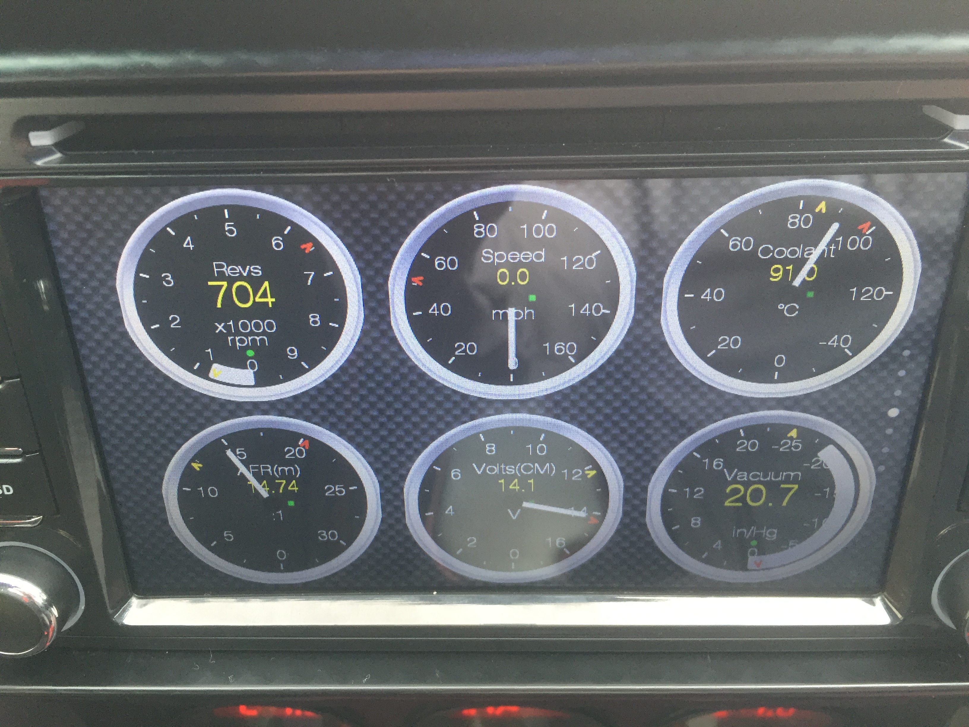

Ade 517 Report post Posted March 8, 2016 Red is the best colour I like the look of that android head unit and the focal integration speakers. I assume thats the plug and play IS 165TOY model? I'm quite tempted by this combo as I don't want to add anymore weight if I can avoid it, but the android for running torque would be awesome and better SQ wouldn't go a miss. I presume the USB is not just for music files? I'd want to be able to download log files stored by torque. 1 S18 RSG reacted to this Share this post Link to post Share on other sites
S18 RSG 429 Report post Posted March 8, 2016 42 minutes ago, Ade said: Red is the best colour I like the look of that android head unit and the focal integration speakers. I assume thats the plug and play IS 165TOY model? I'm quite tempted by this combo as I don't want to add anymore weight if I can avoid it, but the android for running torque would be awesome and better SQ wouldn't go a miss. I presume the USB is not just for music files? I'd want to be able to download log files stored by torque. Cheers Ade. Yes, you assume correctly. It is the IS165TOY. I bought them from Amazon for around £150 I believe. Don't get me wrong, sound quality isn't amazing. It's a big step up on the stock system, which was awful as we all know, but it would still benefit from a small subwoofer and amp, but if you don't want to add any weight, this is a good solution. On the weight front however, you're still gonna add a couple of kilos just by doing this, as the stock speakers weigh literally nothing, whereas the Focals have a fairly hefty magnet attached. As for the log downloads, I've not tried that via USB, but I'm 99% sure you can download them to SD card, so I see no reason why USB wouldn't work. 1 Ade reacted to this Share this post Link to post Share on other sites
Tareim 343 Report post Posted March 8, 2016 2 hours ago, Ade said: Red is the best colour I like the look of that android head unit and the focal integration speakers. I assume thats the plug and play IS 165TOY model? I'm quite tempted by this combo as I don't want to add anymore weight if I can avoid it, but the android for running torque would be awesome and better SQ wouldn't go a miss. I presume the USB is not just for music files? I'd want to be able to download log files stored by torque. if you're not going to bother with a cd/dvd then go for the ca-fi as you'll get a bigger screen 1 Ade reacted to this Share this post Link to post Share on other sites
S18 RSG 429 Report post Posted March 8, 2016 4 minutes ago, Tareim said: if you're not going to bother with a cd/dvd then go for the ca-fi as you'll get a bigger screen I wanted the Ca-Fi, but when I looked into it, I couldn't justify the extra cost. By the time you get it in the UK with all the extras required, it was gonna be close to £400. It's on an older version of Android, has older hardware, no CD/DVD, and most significantly, has been out of stock for months. The biggest advantages are that it's a plug and play solution and has a 0.8" bigger screen with slightly better resolution. On the flip side, losing CD/DVD was quite a big thing for me. I think as long as you're happy to do a bit of DIY to make another one fit, you can get something easily as good, if not better, for a fraction of the cost by going elsewhere. 1 richardcarman reacted to this Share this post Link to post Share on other sites
Tareim 343 Report post Posted March 8, 2016 I believe they are in the process of releasing a new one so were selling all old stock? Share this post Link to post Share on other sites
S18 RSG 429 Report post Posted March 8, 2016 You're quite likely right, will have to see what they come out with next. I still imagine there will be a hefty price difference however. Share this post Link to post Share on other sites
DanJ 374 Report post Posted March 8, 2016 What make head unit is that? I was looking at ca-fi but there's been no stock for ages as you know! Sent from my Nexus 5 using Tapatalk Share this post Link to post Share on other sites

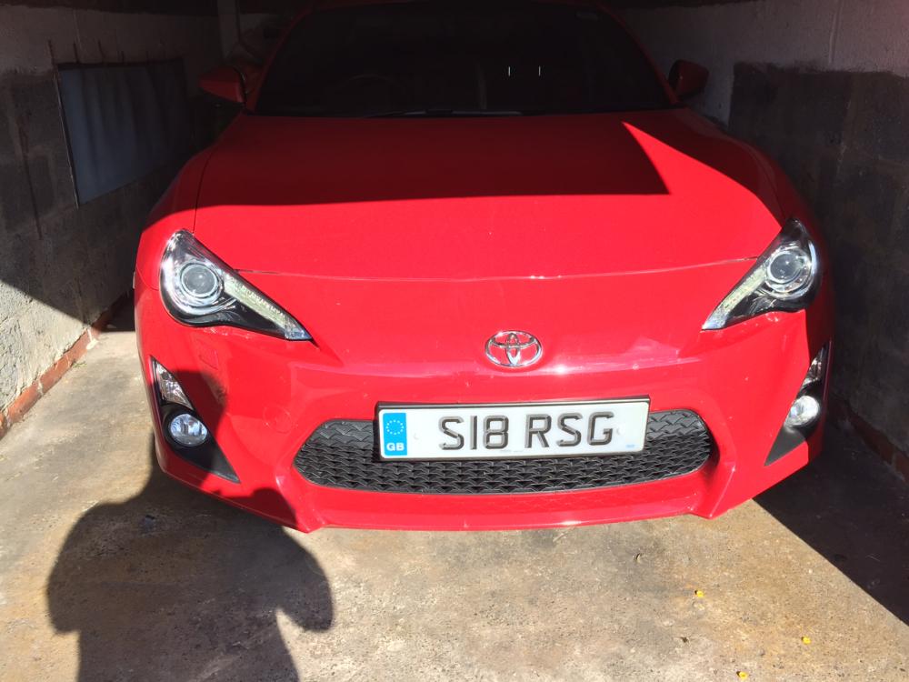

S18 RSG 429 Report post Posted April 2, 2016 Only a small update this time. As those of you who attended the TD open day would have seen, I got around to fitting the rest of the HT Autos kit. I like the way it looks now it's all together. I screenshotted this picture from a video I found on Youtube of the open day (credit to whoever recognises the image from their video) As for today, I took advantage of the first good weekend I've had free in a while, and got around to plastidipping the rest of the interior. The air con surrounds were a pain in the ass to remove and refit, but it was worth it I think. Finally, I had a go at fitting the bonnet struts I bought last week, only to realise that I had fitted them to the wrong part of the wing, and the bonnet wouldn't close. I figured I would just leave the bonnet ajar, lock the car away and sort it tomorrow (as I wanted to watch the El Classico), however due to the fantastic alarm on these cars, I couldn't do that without my alarm going off every 20 seconds, so I had to remove them ready to start again tomorrow. Here is how they sat upon initial fitting though: So, that little plan will toll over into tomorrow (hopefully the weather stays good). I also want to try and get my amplifier for the speakers wired up, as it's been sat on my bedroom floor partially wired for the past month, and, if I have time, plastidip the Toyota badges black, and the centre section of the front lip black also. May be a job for another day however. In other news, my new steering wheel is around a week away from completion. Slightly thicker than the stock wheel, all black alcantara with red stitching and a red 12 o'clock stripe. Safe to say I'm pretty excited for it. That's all for now 4 Tom B, Ade, Keethos and 1 other reacted to this Share this post Link to post Share on other sites

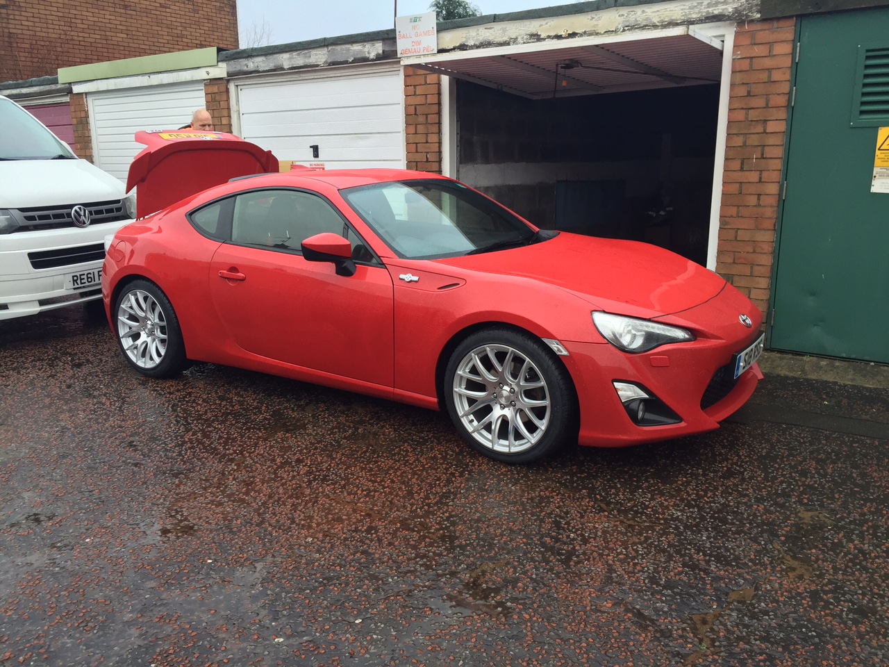

S18 RSG 429 Report post Posted April 23, 2016 Waking up at 6am and getting straight to work actually yields some great results apparently. Most of you will have seen the latest update in the other thread, but to keep everything together (and for those who missed it), I fell victim to my own tiredness, and kerbed my wheel on Thursday (only the second kerbed wheel in 8 years ). Luckily, I was able to book the car in at The Wheel Specialist the following day, who took my vague instructions of "dark metallic ish bronze with a matte lacquer", and smashed it. The wheels transform the car in my opinion. This morning I decided to have a go at fitting the new wheel. Turned out to be significantly easier than even I expected. Took around 20 minutes to swap them around. However, for me it took around 2 hours, as I had to wait for the plastidip to dry on the final bit of silver plastic remaining. Here is the result: Of course, fitting it and having it be perfect was never an option, because it's me, so I then had to go to my local garage to have the wheel straightened, as I really couldn't be bothered to disassemble it again to try and put it back in the right place. Was a useful journey however, as I finally got around to fixing the rear camber. New settings now: 2deg negative on front, 2.2deg negative on rear. I wanted to get closer to 1.5deg on the rear, but that was as much as I could get with the current setup, and is still a huge improvement on the previous settings, of 3.5deg negative on the rear... Now just to wash the car ready to join you all at Japfest, although unfortunately I will have to park in the visitor parking and walk in to find you all, so should see you at around 9:30am 2 Ade and Keethos reacted to this Share this post Link to post Share on other sites

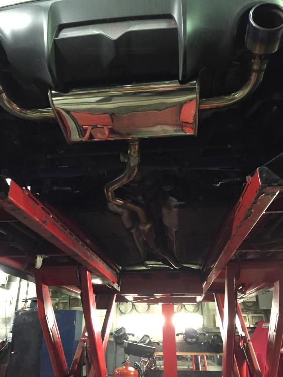

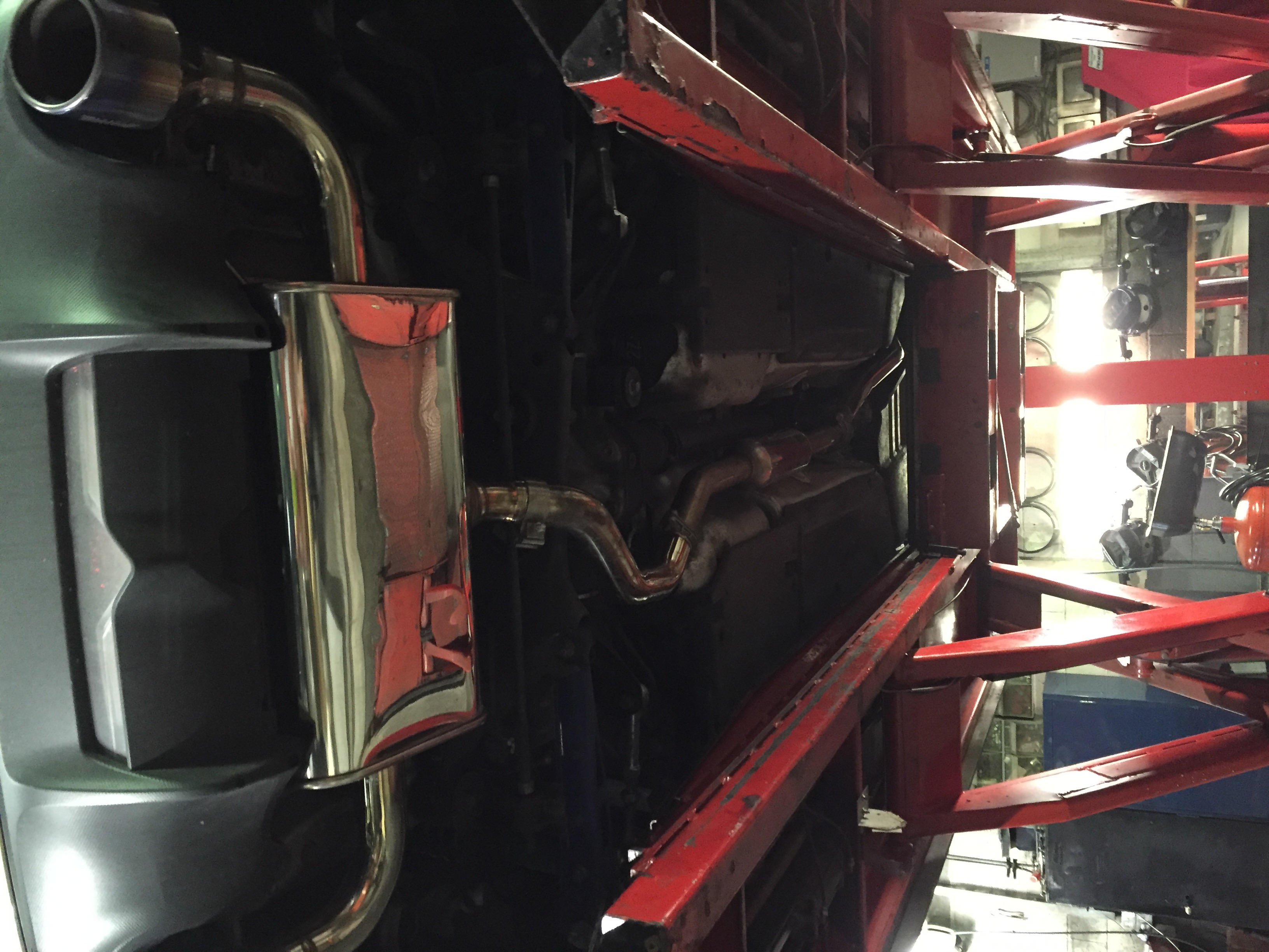

S18 RSG 429 Report post Posted May 14, 2016 Can someone please tell me if I'm being stupid or not? I've been looking at this manifold all day, and I've convinced myself that it's the wrong way around (the overpipe fits on the wrong side). I was almost 100% sure that the overpipe is under the passenger side on the 86, but on this manifold the overpipe would be under the driver. Someone please confirm my stupidity, or genuine concern Share this post Link to post Share on other sites

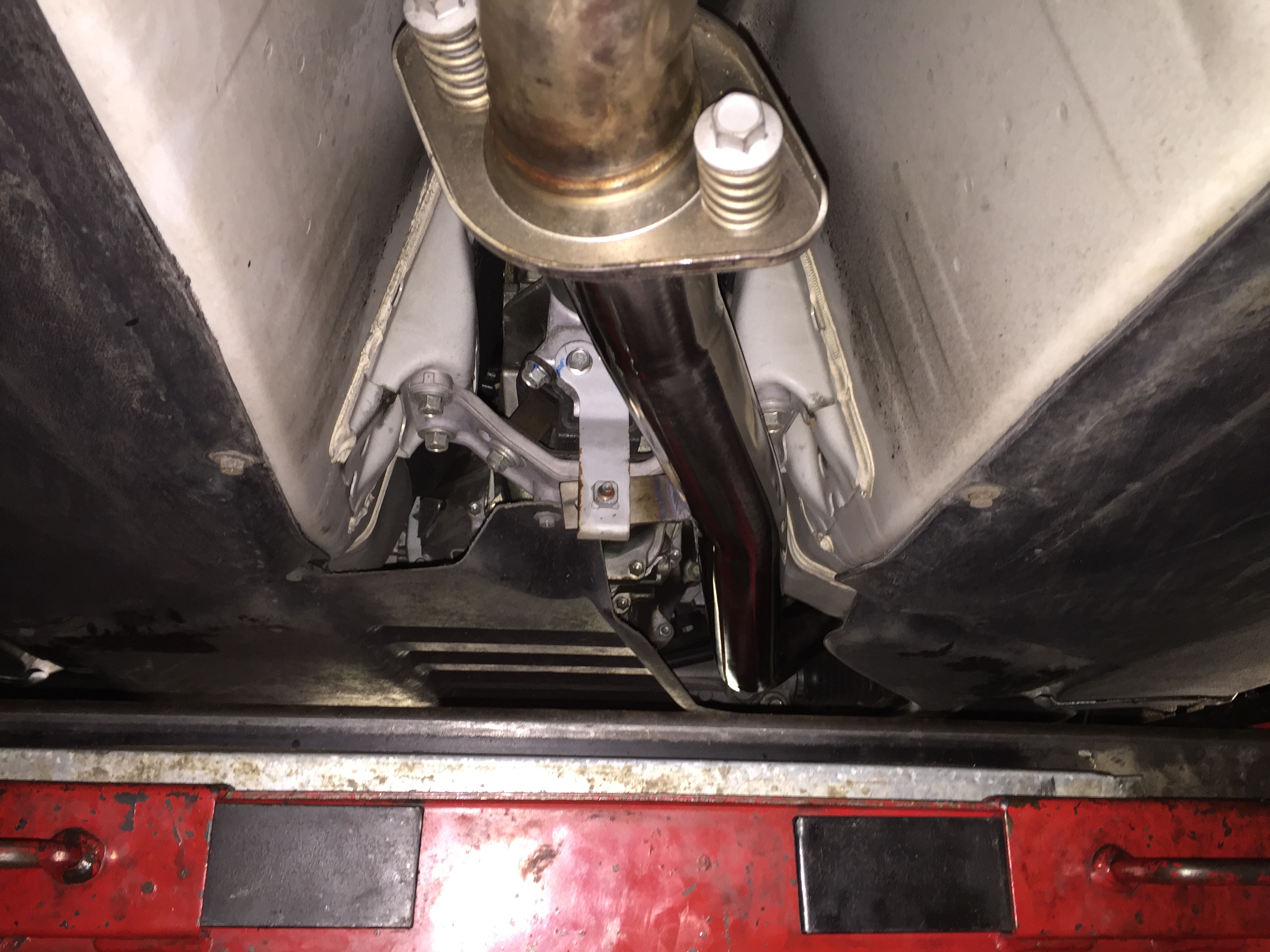

Paul 442 Report post Posted May 14, 2016 Well unless Rich specified otherwise on his then all 3 of us have the same one? *edit* This is the underneath of my car when it was on the ramp @ Abbey, certainly looks as if it goes under driver's side. Share this post Link to post Share on other sites
S18 RSG 429 Report post Posted May 14, 2016 I specified it was for a UK car too, in case it made a difference. He also would have noticed that fromy address. Do you have yours to hand to check if they're the same? Edit- Just saw your pic. Looks like it does to me too. I wonder if the US models are different? I've been convinced all day that the overpipe was under the passenger. Maybe it's just under the driver on US cars. Sent from my LG-H850 using Tapatalk Share this post Link to post Share on other sites
Paul 442 Report post Posted May 14, 2016 Just now, S18 RSG said: I specified it was for a UK car tll, in case it made a difference. He also would have noticed that fromy address. Do you have yours to hand to check if they're the same? Sent from my LG-H850 using Tapatalk See my edit above, mine's still in a box @ work. @Rich save us!!!! Share this post Link to post Share on other sites
Paul 442 Report post Posted May 14, 2016 Even clearer photo I just found: Share this post Link to post Share on other sites
S18 RSG 429 Report post Posted May 14, 2016 Well, that's certainly put my mind at ease. I have no idea why I got convinced otherwise. Maybe someone else has an idea regarding US cars. Thanks Sent from my LG-H850 using Tapatalk Share this post Link to post Share on other sites
Rich 378 Report post Posted May 14, 2016 Mine was driver's side, I clearly remember standing under it trying to get the damn thing in. 1 S18 RSG reacted to this Share this post Link to post Share on other sites
Tareim 343 Report post Posted May 14, 2016 if you've been reading about the overpipe location on the US forum then it would be the passenger side for them which is driver side for us, it's why sometimes they say for LHD only as we have the steering rack that gets in the way 1 S18 RSG reacted to this Share this post Link to post Share on other sites
