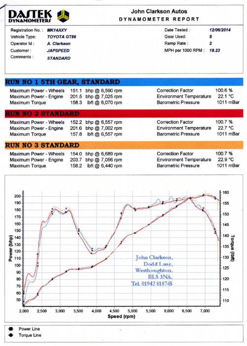

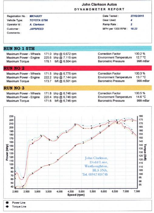

Well even the cheap Japspeed manifold showed impressive numbers on the dyno, albeit they are from Japspeed themselves. They made 225hp and 176lb/ft of torque from their decat manifold, decat front pipe and cat back, and 220hp and 167lb/ft with their catted manifold, catted front pipe and catback.
Bearing in mind the catted manifold with overpipe is £425, and decat manfiold is £340.
Yet still nobody seems to trust them.

2 minutes ago, daidaiiro said:
Interesting the 'after' figure is ambient 10C cooler, that'd help a bit.
I think that's got more to do with the fact that they bought the car in late 2014 (summer) and developed the parts over the winter, so when they tested on the dyno second time, it was February 2015. Sure, it would have helped, but only small amounts.
