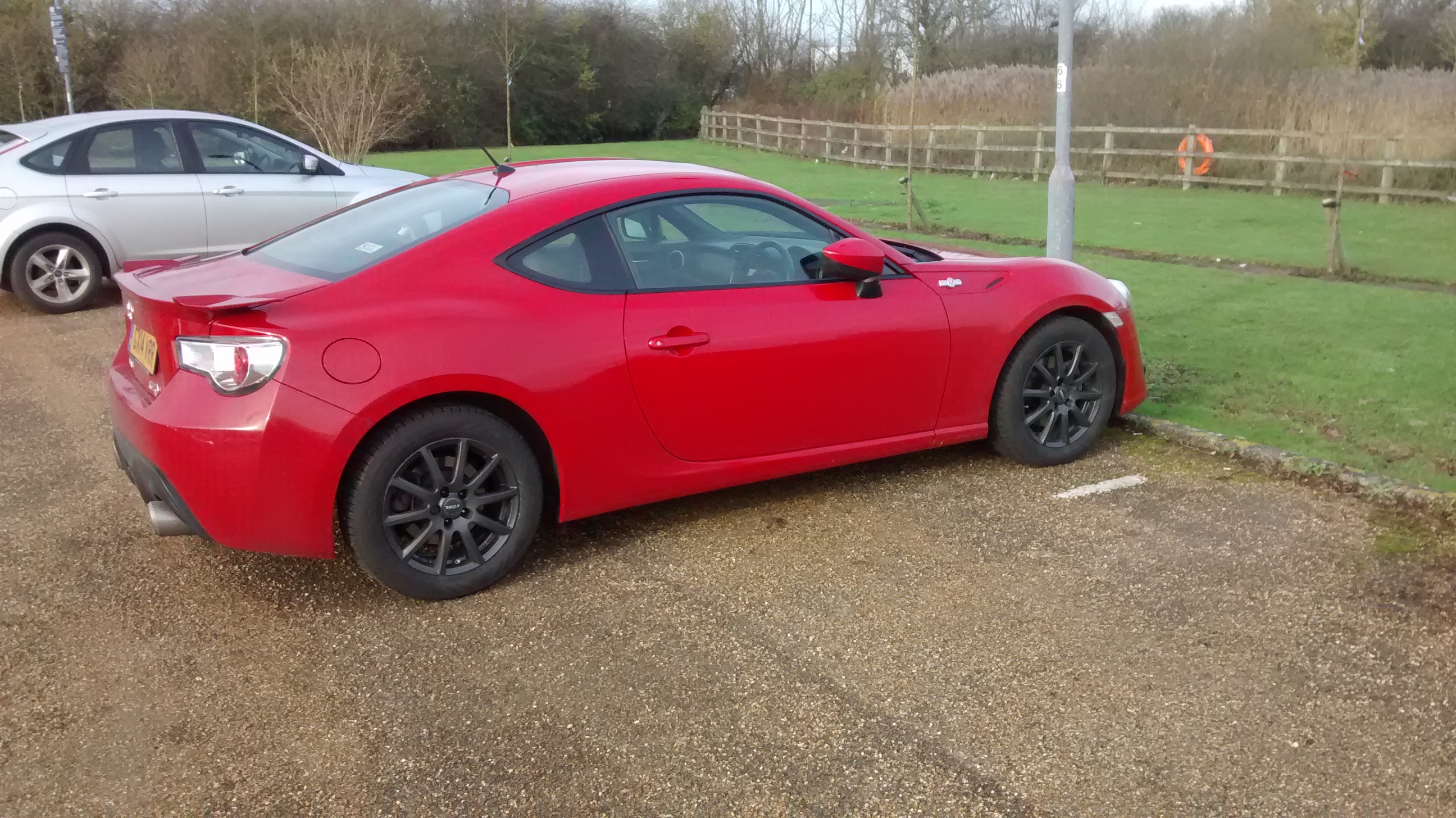

keelerad 256 Report post Posted September 13, 2015 Here's what I did first winter with mine back in 2012, 16" with 205's, wheels dirt cheap as 2nd hand Imprezza ones fitAlec Share this post Link to post Share on other sites
Keef 0 Report post Posted September 13, 2015 Nice, can doesn't look too bad on the 16"s. I've used Avon Ice Touring before and they were pretty good. Either 16 or 17's and I'd get the same again Share this post Link to post Share on other sites
