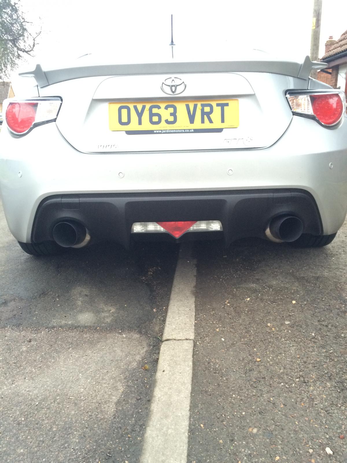

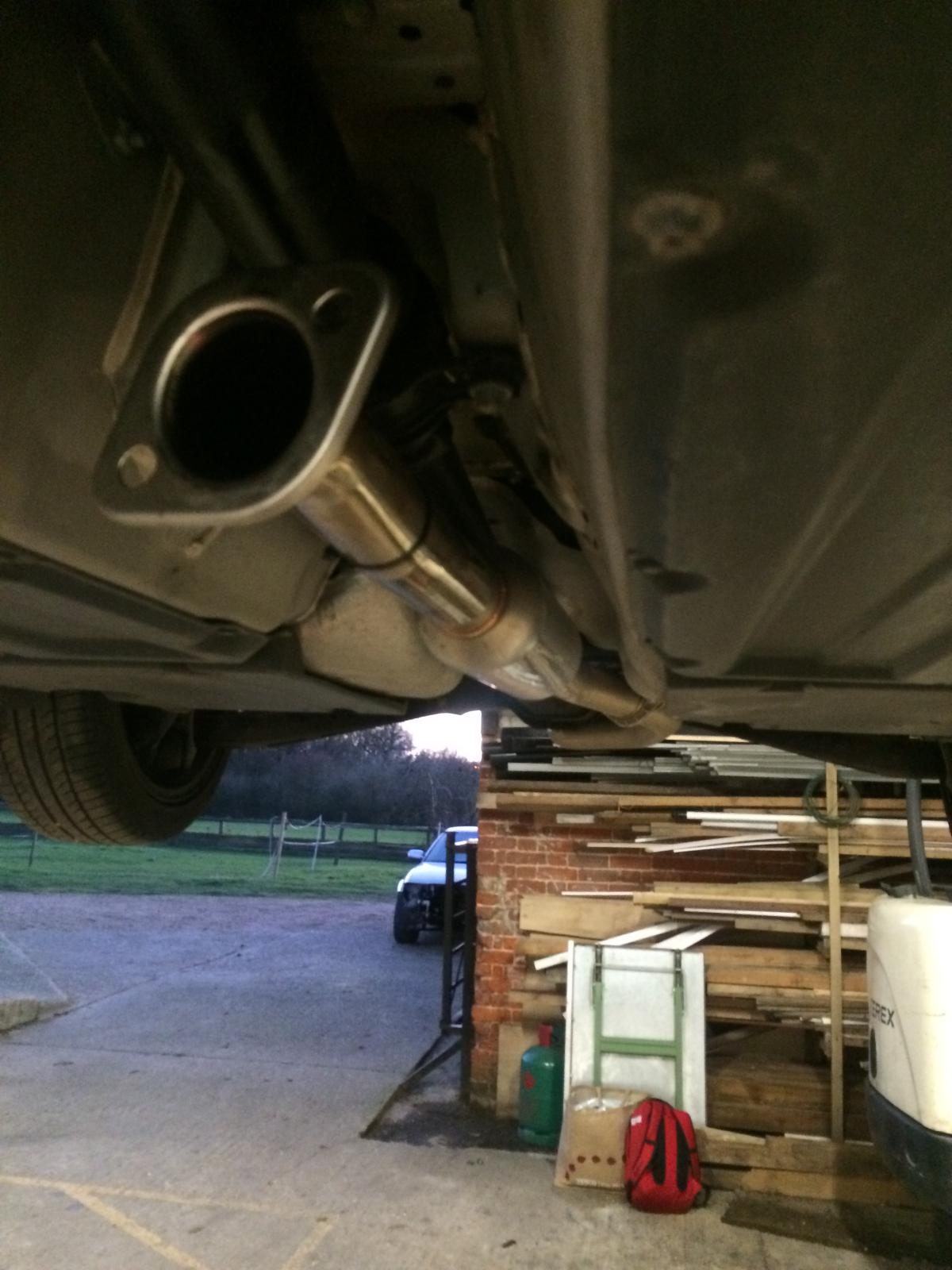

JamesP1991 222 Report post Posted June 3, 2015 You are in luck Remal I have just seen this Nice to see you are interested in the Invidia systems, they are fantastic quality and Chris from Tarmac will get you a good deal. The reason you pay more for the Q300 is because of the "backbox" style design instead of the Y pipe of the N1, more material is used, and it also produces a quieter more refined sound. On the other hand, the N1 is designed to be LOUD, it does drone a bit and is incredibly deep in it's tone. Due to it being a less restrictive Y pipe design It is best optimised for flow, outside of a single exit Tomei or Blitz for example. I chose it because I wanted the car to be a bit loud and obnoxious, as it was something I felt it dearly lacked, even though it was a sports car, but also it produced good HP numbers. Quality wise I have had no problems in the year I have had it. The titanium tips look as good polished up now as they did when I first bolted it on. The Invidia plaque at the split of the pipes looks awesome underneath the car, and the welds and joins on the exhaust itself are very solid. Here are a couple of pictures of it on the car: Unfortunately I do not have any videos of the sound of mine at the moment (will get those done), but I do have the identical setup to this YouTube video: The N1 contributes to a lot of the sound along with the Borla UEL. Even before the manifold was installed, and it was on the stock manifold, it was a loud beast. I think you said however that being loud was not your target, but something that sounded a bit fruity instead was more your thing? Well the Q300 is definitely the choice for you in that regard then, as it doesn't produce the drone of the N1, yet is still a bit louder than the stock system. Quality wise they are the same too. Hope that answer helps in your decision process any way buddy 2 Tweedbean and remal reacted to this Share this post Link to post Share on other sites

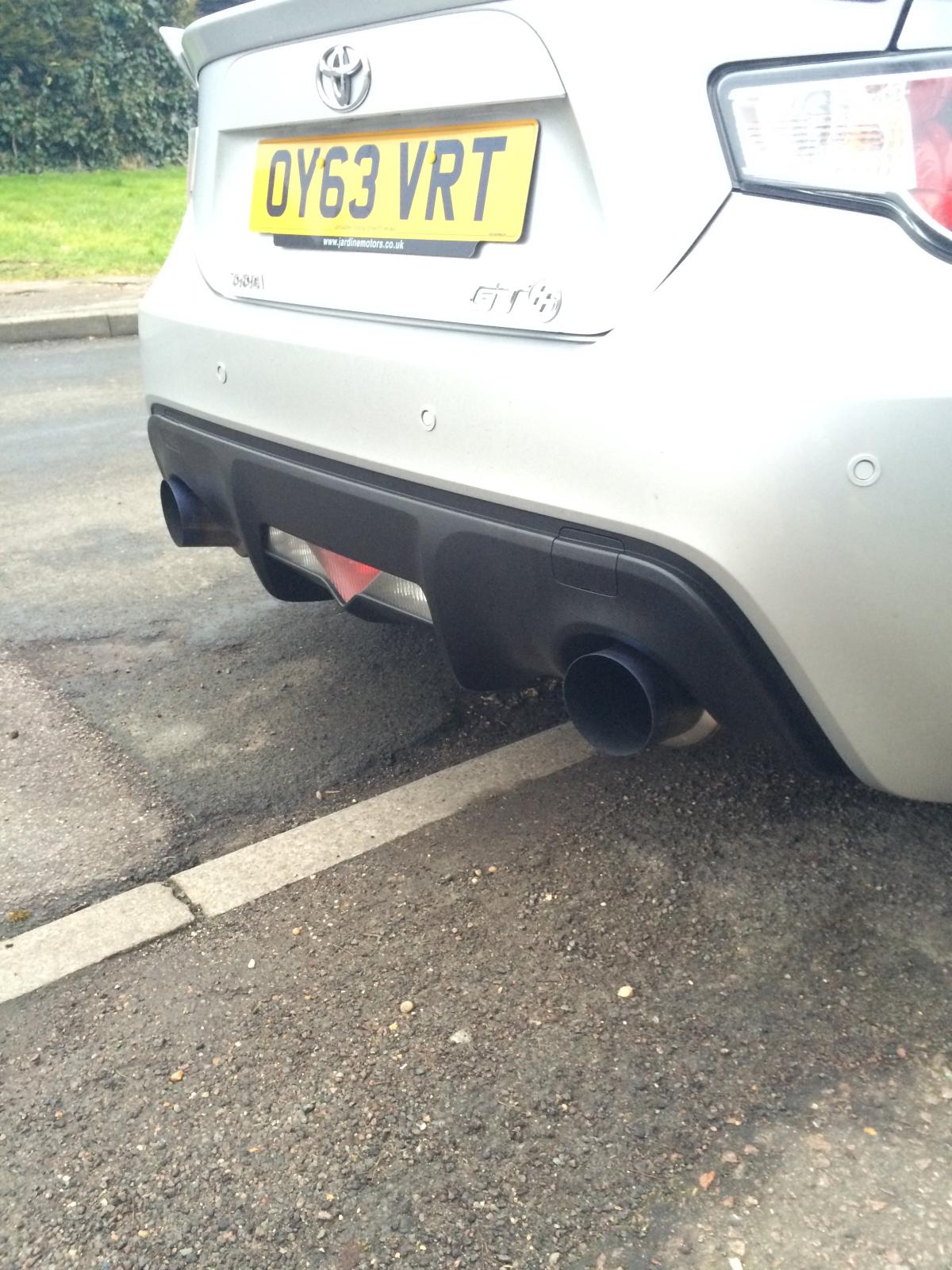

smudge 1020 Report post Posted June 3, 2015 I do indeed have the Q300 This was with the Borla UEL manifold and the Invidia Q300 This is it with a high flow cat in place of the front pipe and a custom straight through pipe instead of the resonated mid pipe Invidia give you 2 remal and JamesP1991 reacted to this Share this post Link to post Share on other sites
