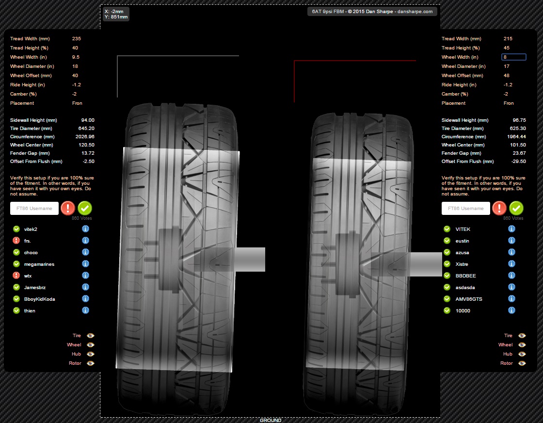

How much stretch is too much?  Would fitting a 235/40R18 tyre onto an 18x9.5J wheel equal too much stretch?
Below is an image of what Laruen has set up with a bit of stretch and what 235/40R18 looks like, Lauren's setup doesn't look like it's stretch from this illustration but it's enough for her to feel a stiffer, more pointy car.

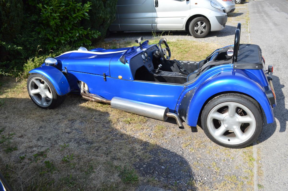

Slightly off topic a bit But I have Escort Cosworth Alloys on my kit car which is 8J width and should have 245 tyre on it. The car was built in mind for 205/45/16 wheels on a 7J width alloy
But has built the car around the wheels I am running 215/40/16 on the rear and 205/40/16 front to fit under the cycle wing and rear tub.
never been a issue and I love the escort cosworth alloys I did not want to change. The only issue I get is trying to find a 205/40/16 profile tyre as there are not that many about
