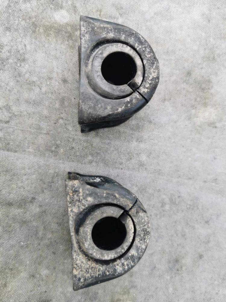

- At the moment, my main suspect for this is the anti roll bar bushings (in the Dining Room, with the lead pipe). As evidenced above, the noise is most prevalent when the wheels are moving relative to each other, and my understanding is that this would be causing the ARB to flex/twist, whereas on level ground it shouldn't be twisting.
- ARB drop links. I'm considering these as well, but only really because they link to the ARB. My experience on cars of the past is that drop links are a weak point, so usually this would be my go-to for the problem. However, again in my experience, worn drop links tends to cause all sorts of clunking noises in general driving over any sort of rough ground, whereas this issue only occurs slowly.
My next step is going to be getting the car in the air at the weekend and inspecting the ARB bushing, and giving them a spray with silicone lubricant to see if that helps. In the meantime, I'd welcome any opinions on what else might be causing the noise that I could investigate. Has anyone experienced similar issues?

Just spent this morning replacing the drop links (just went OEM as they were fairly cheap even from Toyota). It was definitely part of the issue...you can see in the video below how worn they were. The one shown is the drivers side, but the passenger side wasn't much better (and ended up being a complete pig to remove).
https://youtu.be/lv8QNELMP_8
The noise is now much quieter, and it's stopped rattling over rough surfaces. However, the low speed creaking is still there...buts its definitely not as bad. So I think the ARB bushes might need replacing too, like you said. Is that fairly easy to do, if you did it yourself? I have a good array of tools, but not a lift so I have to work with the car on jackstands.

Cheers. I've ordered a set off importcarparts.com. Don't have an impact gun, but I do have breaker bar, so looks like another little job for next week.

Well, I've just replaced the front bushes, and it seems to have cured the problem. Took it for a drive again, no unusual noises over speed cushions, nor when I manoeuvred while parking outside my house.
Only issue (aside from it starting to rain while I was working) was that I managed to strip one of the bolts which holds the metal clip encasing the bush to the sway bar frame (the part which bolts to the chassis).Because the clip doesn't go down flush, as you're crushing the bush, I managed to cross thread the bolt and didn't notice until it was too late and I had a socket on it. Luckily I managed to find a similar size bolt and nut in the garage to replace it with, which seems to hold okay. If it doesn't, I'll have to find a replacement frame somewhere. But still, prat 😕
