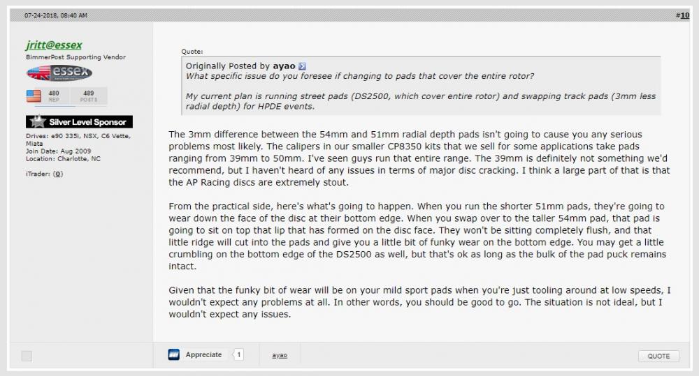

Question for knowledgeable members - I have ordered Ferodo FRP 3077H but received FRP 3076H. They both fit KSports Calipers (AP size 5070/ CP5575) but FRP 3076H have radial depth 50mm instead of 54mm for FRP 3076H.
How important is this, particularly considering occasional track day use?
Reading Essex blog it seems the upswept part of the risk can cause temperature gradient (assume this means inside part of the disk will be cooler as there would be no pad touching it) and potentially premature cracking of the desk.
 https://www.essexparts.com/news-blog/track-and-racing-brake-pad-owners-guide
As I had to use the pads the only option I have now is the 50% refund (which for Ferodo DS 2500 is ~ 40% of the new disks price). I have purchased 2 sets (to have an extra replacement set just in case), so discount is worth almost new disks.
So my dilemma is:
- keep both sets (don't expect disks to last more than 2 new sets if nothing else happens with the disks); or
- exchange 1 to FRP 3077H and keep the other - and either use it, (but I guess changing to FRP 3077H would not be an option due to even disk wear, so the disk life may be limited to the life of pads or cracking, whichever happens first) or change them to new set as soon as they arrive.
Hmmm?
@VAD17 someone asked a similar question on an M3 forum, one of the guys from Essex replied - screenshot below.
Not entirely sure what I'd do in that situation, based on the below you should be fine to run the smaller pad until the disc's die. Maybe return the brand new set and get some in the correct size, then swap these with the used small set and keep them incase of emergency/or ebay them.
