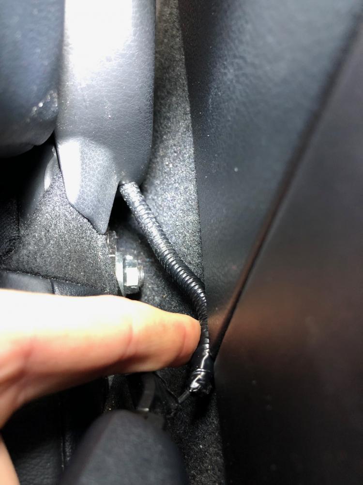

GravelRash 62 Report post Posted February 9, 2019 Quick question for the group: what is it supposed to attach to on the drivers seat itself? I presumed the seatbelt buckle, but that just appears to be a nut (and not a lot of spare thread), and almost no access to the bolt itself. Share this post Link to post Share on other sites
Lauren 2259 Report post Posted February 9, 2019 40 minutes ago, GravelRash said: Quick question for the group: what is it supposed to attach to on the drivers seat itself? I presumed the seatbelt buckle, but that just appears to be a nut (and not a lot of spare thread), and almost no access to the bolt itself. It bolts onto the lap belt mounts. There isn't a lot of room but I managed to bolt mine in without removing the drivers seat easily enough. You get longer bolts with the belts. Share this post Link to post Share on other sites
GravelRash 62 Report post Posted February 10, 2019 15 hours ago, Lauren said: It bolts onto the lap belt mounts. There isn't a lot of room but I managed to bolt mine in without removing the drivers seat easily enough. You get longer bolts with the belts. I'm not sure we're talking about the same bolt. It's not a bolt on my seat-buckle. It's a stud with a nut on the end. I've tried to see if I have access under the seat itself to the back of the stud, but I don't see or feel any access, so I've left pondering if I'm supposed to just undo the nut, mount the harness ringlet and then do the nut back up, but as you can see from the photo there's very little spare thread. It's also ridiculously tight and there's no room for a breaker down the side of the transmission tunnel. Share this post Link to post Share on other sites
Mike 458 Report post Posted February 10, 2019 That's the right place afaik, not fitted mine yet but that's where I plan on fitting it to. The only longer bolt you get is for the rear seat belt mount I think. Share this post Link to post Share on other sites
Lauren 2259 Report post Posted February 10, 2019 Ah yes, it's a nut, rather than a bolt. From what I remember we just undid the nut and put the harness eyehole in there. There was enough thread. It's just a bit fiddly. 1 GravelRash reacted to this Share this post Link to post Share on other sites
GravelRash 62 Report post Posted February 10, 2019 24 minutes ago, Mike said: That's the right place afaik, not fitted mine yet but that's where I plan on fitting it to. The only longer bolt you get is for the rear seat belt mount I think. My kit arrived with 3 bolts (1 was slightly longer), 3 washers and 3 spacers of various sizes. I think it's a generic fitting kit. I used the slightly longer bolt to replace the bolt that's in door jam for the drivers seatbelt was the stock bolt had a slight taper and didn't fit snugly into the harness ringlet. For the rear mounting point I re-used the stock bolt (and a hammer and punch to bend it into shape). I also lowered the rear-seat belt reel by un-doing the lower bolt as well. This allowed me to build the bolt assembly back up and then mount it easily. Otherwise there's not much wiggle room to re-attach 2 spacers and a metal ring washer without it all falling down in to the car. I also expected it to take about 30 minutes and I spent nearly 2 hours trying not the break any trim and swearing at the rear airbag trim that somehow is always in the way! Share this post Link to post Share on other sites
GravelRash 62 Report post Posted February 10, 2019 57 minutes ago, Lauren said: Ah yes, it's a nut, rather than a bolt. From what I remember we just undid the nut and put the harness eyehole in there. There was enough thread. It's just a bit fiddly. It's installed. Brute force and my usual ignorance got the nut undone and then it was fairly straight-forward. 1 Lauren reacted to this Share this post Link to post Share on other sites
