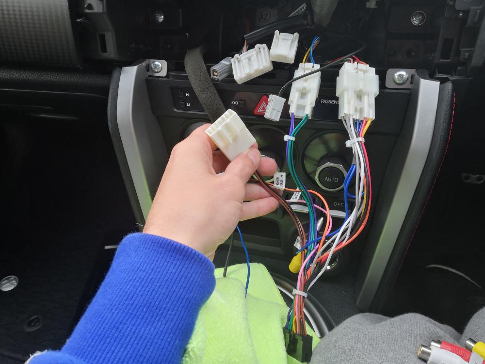

On 5/20/2018 at 10:51 PM, mattt said:
Hey peeps, ive just tried to fit this headunit, was all connected and seemed to be working. was getting an occasional beep every 30 seconds or so and when i turned car off the stereo was making a very worrying noise. Can anyone confirm if this cable im holding is meant to connect to something, it has 2 brown and a black wire so im assuming its a ground for steering wheel controls or something? it had 3 prongs inside and doesnt fit over anything, and im left with 2 small cables (1 being oem gps and the other one with black wire im not sure about)
